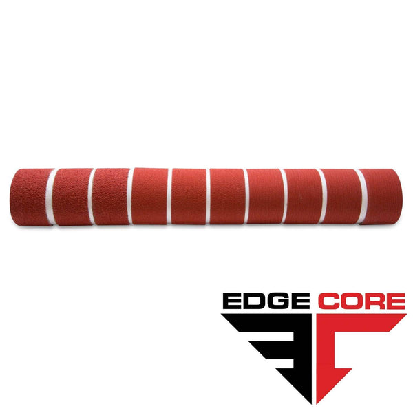

I've had no issue getting belts - 60 grit ceramic up to 220 zirconium to 600 AO. In the $3/each range.

I'm just trying to point out that availability isn't really an issue.

Finally, there is the avialabilty factor. As Enzo's most recent post shows, there is decent avialabilty for 48" belts, though not all brands carry all models in 48".
