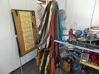

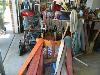

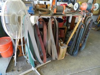

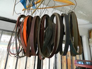

Sometimes you just need a different belt but sanding the seam bumps down usually helps. You can go overboard trying new belts however. I have a friend who has this problem. Here's a couple photos:
Larry
