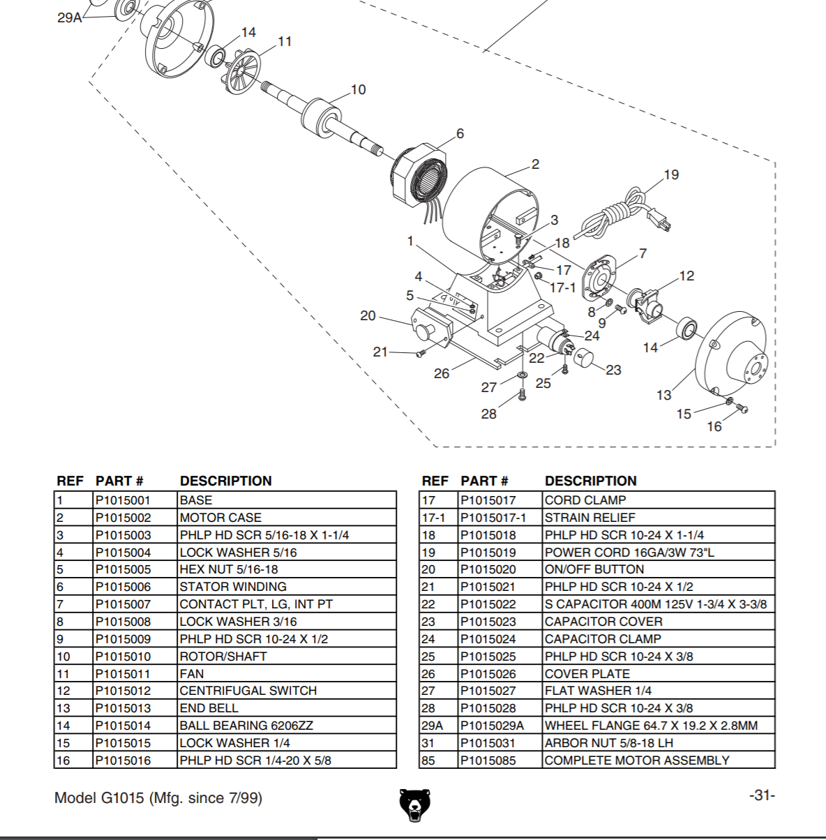

OK, how do ya'll know this is a Grizzly grinder? I've read the OP several times carefully and didn't see that. Is it the G1015 Grizzly grinder? That's a 1hp at 14 amp rating. That "could" have burnt a 20 amp breaker out. You've plugged into different 120vac recepts, but are you sure they are on a different circuit? Is this a GFI breaker?

His title says Grizzly! Mine is 120v ac. single speed with a simple pull push start switch. It's a totally enclosed motor and although I'm not sure I've never looked under the base mounting there are no capacitors. He says he has plugged other devices into the recep his grizzly was plugged into and the other tools all work in the same recp his grinder was plugged into. So with that all said again I'd bypass the switch and try that.

It has a capacitor that assists upon start.
Rick is right about the capacitor. That’s why I suggested seeing if it started with the switch on by giving the wheel a hard spin. Could be a blown start cap. We have tested other motors this way and the odd time they will fire if you get them rolling. Not always though.
This is a good point and thing to try. Usually if a capacitor is bad, a motor will at least hum and maybe it ’tries’ to run. At least then you know its not a power supply problem & switch is OK and most likely its capacitor faulty.
