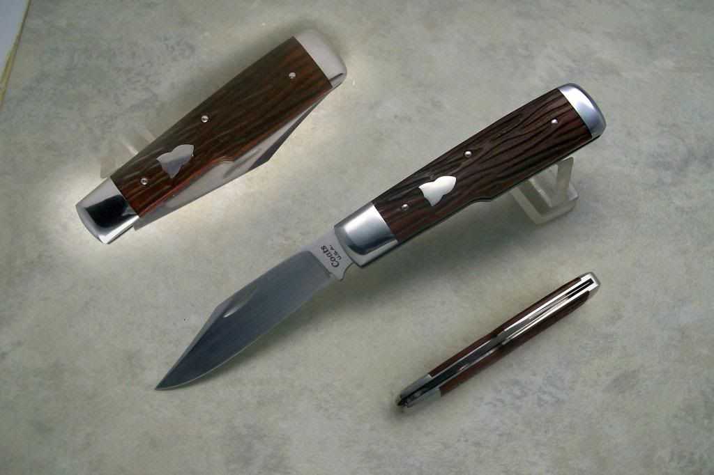

First gunstock jack for me, I like the way it turned out.
SPECS
Blade and spring Ats-34, Blade@ 61-62 Rc, 3/32" stock.
Blade is hollow ground (14" wheel) and hand finished.
Drawn swedge is also hand finished.
Frame 416 ss, liners bolsters integral, mill relieved.
Scales-covers, My dyed and jigged bone. Crest shield
is inletted and pinned.
Closed length, 3 3/4", open length 6 5/8", back is flush
open, half stop, and closed positions. About medium on the
pull. Crescent nail nick.
Price $400 shipping and paypal included. SOLD
You can say I'll take it here, pm, or email me.
Comments welcome, and Thanks for the look.
