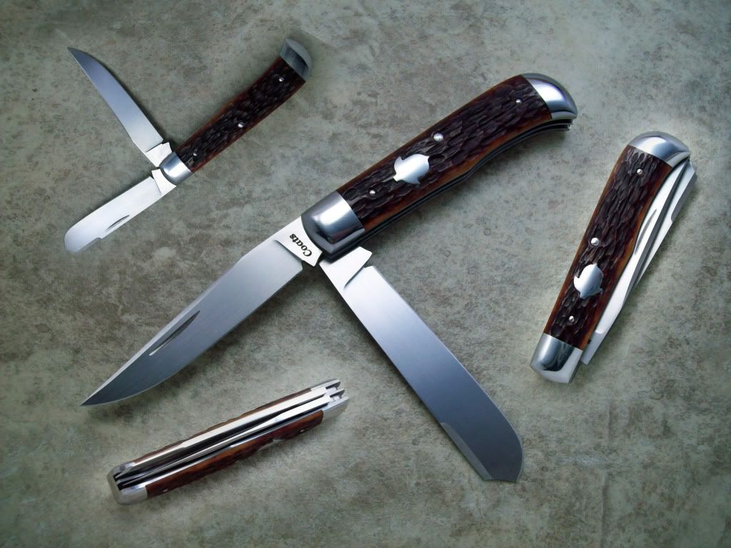

The reason I'm calling this a "standard" trapper is because a certain image comes to mind when I hear
the word "trapper" in reference to a slipjoint. Any number of other designs and blade shapes are and
can be trappers. I used the acorn shield instead of the double bomb because it fit better.
SPECS
Blades and springs Ats-34, blades @ 61-62 Rc, springs @48-49 Rc, cryo, 3/32" stock.
Blades are flat ground with 600 grit hand finish. Master has drawn swedge,- spey cut swedge.
Frame 416 ss liners bolsters integral, mill relieved.
Scales my dyed and jigged bone, Acorn shield is pinned.
The knife has nice W/T with a medium pull. Back is flush open, closed, and half stop position.
Crescent nail nicks. 3 5/8" closed, 6 3/4" open.
Price $550 shipping and paypal included, shipped in a zipcase.
You can say I'll take it here, pm, or email me.
Comments welcome and Thanks for the look.
Ken.
