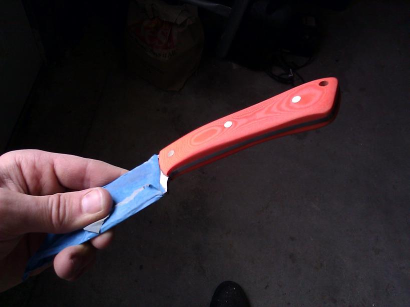

Hi All, here's another one fresh off the queue.

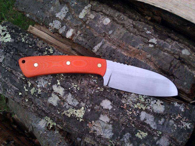

This is my "Mariner" model rigging knife:
OAL 8.3"
Blade 3.675"
1/8" O1
Safety Orange G10 (behaves like canvas micarta, tho - not sure about that story)
3/16" brass pins
This is another somewhat rough-finish knife due to ill-conceived belt-finishing experiments, so I've left it at a brushed 220 grit and loaded it up with Flitz wax. The grind is very thin at the edge, so it only spent about 5 minutes on the stone to get wicked sharp.

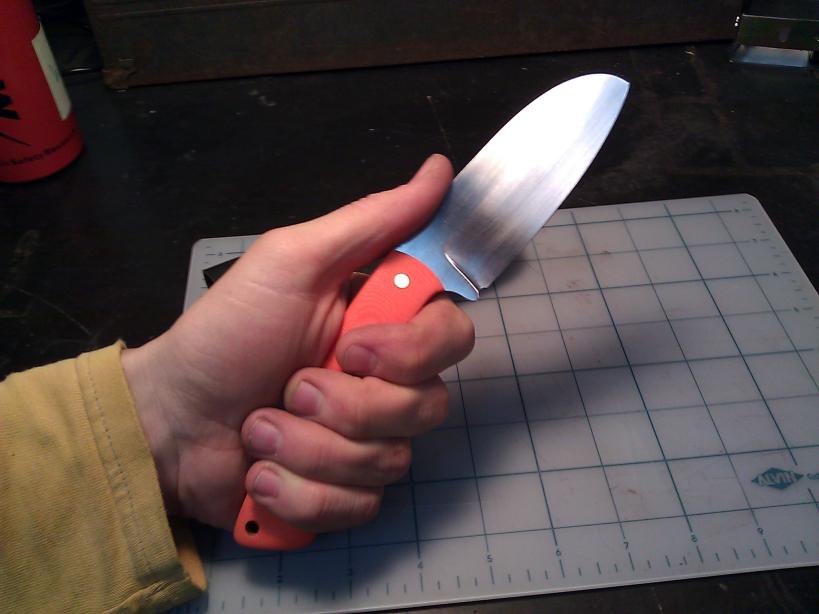

Good news on this one is I totally nailed the handle contours, I think. It feels perfect, and despite having exactly the same profile dimensions as the big maple-handled hunter, it fits better.
The G10 looked rather offensive as glued blocks, but once the shaping started I REALLY began to dig it.

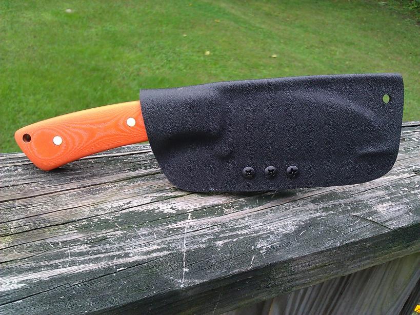

The sheath is my standard kydex affair with a lanyard hole at the end.
This one will hopefully be going to a neighbor who will beta-test it for me on his boat next season.
I'm so happy to finally have this one done too - it's been kicking around the shop all summer.
While this isn't my best finished knife in certain ways, other elements of my execution are definitely maturing. I'm hoping the next set really comes together from both angles.
Thanks for looking.
-Daizee
