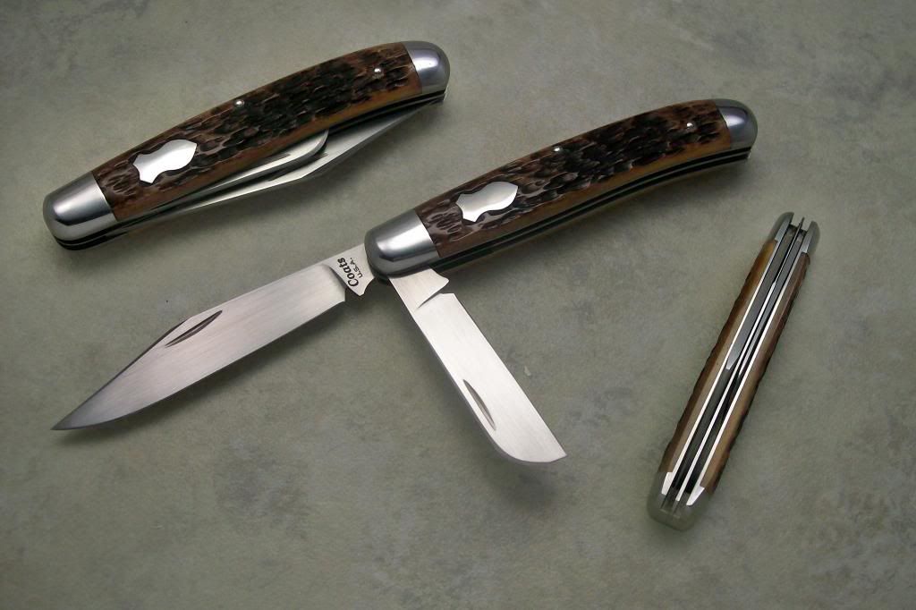

3 7/8" Clip/Sheepfoot, Slipjoint
Feedback: +43 / =0 / -0
Apr 20, 2005
2,359
SPECS
Blades and springs Ats-34, Rc 60-61 Rc. Master .093 thick, pen @ .072
Both blades are hollow ground and hand finished, drawn swedges.
Frame 416ss, liners and bolsters integral, mill relieved. All hardware ss.
Scales my dyed and jigged bone, federal shield is pinned.
3 7/8 closed length, open length 7" Back is flush open, and closed, no half
stop, cam ends.
Knife has good W/T both blades, with about a smooth "5" on the pull.
Crescent nail nicks, both blades. Sunk Joints.
Price $600 paypal and shipping included. Shipped in an upholstery leather
slipcase. Shipped priority insured. Comments welcome and Thanks for the look.
Ken.
