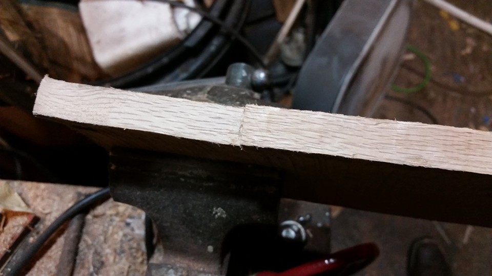

1) I started putting an interior wall up in my shop/shed yesterday, using pallet boards, when I noticed this board:
I wish I knew more about different woods. I could not figure out what it is with Google, but I figure one of y'all will know in a heartbeat.
I have another board of it that is flat, and I like the look of it. I'm guessing it needs stabilization first though.
2) Could it be suitable for scales, or is there reason pallet wood shouldn't be used?
3) If I were to glue up different woods for the same handle, would wood glue be suitable for the wood/wood bonds, or should I still use epoxy?
Thanks in advance guys.
It's probably rubberwood. There is no reason it Couldn't be used on a handle "we use oak, walnut and maple all the time" but it's not very strong, it's not very stable and it pulls up a lot of fluids. Not the best choice over all.
There is nothing that makes pallet wood unusable, but the qualities knife makers want "very attractive, high stengtg, high weight and capable of taking a high polish" are all factors that make wood expensive, and you don't often find expensive woods used asome pallet woods
i am going to guess oak ? i judge wood by trying to sink my fingernail into the wood, usually you can actually feel it sink in,and sometimes will leave a mark. (try it on a 2x4.) if it doesnt sink in its hard enough to be a good scale, and doesnt need stabilizing in my opinion. i would use epoxy for the wood to wood joints. most wood glues are water soluble. just my 2 cents.
Call me crazy but it looks a bit like Oak. As far as I know, Oak is commonly used for pallet materials. If we could see the other side of the piece we could get a better idea of what it is. Assuming it is oak, yes, it would be great for handles. I don't know if you should stabilize it though. I know you have to stabilize oak burls, but I'm not sure about "plain old" oak. Someone else will weigh in on that I'd be willing to bet.
As for the gluing pieces together, Yes you can use regular wood glue. Just make sure your joints are rough and clean. Stacy recently enlightened me on this very topic; Titebond ll works very well for these sort of bonds and there is also a wood glue by Titebond that is a darker color for gluing up darker woods.
for sure that's red oak-it looks white. white oak looks tan/brownish before finishing. try indenting the edge with your fingernail, that should tell you if it's a hardwood or (k)not. if you have real lumber-yard around(scarce beasties-somewhat like a unicorn) take it there, and they should be able to tell you. as mentioned above a picture of the face of the board would be helpful. thanks, Neal
Oak is common for pallets, and the board does have the open pores common to oak.
As already noted, oak, maple, and walnut are commonly used hardwoods in North America. The pores in oak can be filled, or if you get some ebony dye from Lee valley, it can resemble bog oak. It's just very common, and somewhat plain, so you won't see it on high end knives.

Red Oak makes sense, and looking at google, that looks about right. Feel kinda goofy snice that's such a common wood, but oh well. Thanks for the info guys.
