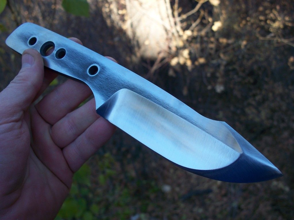

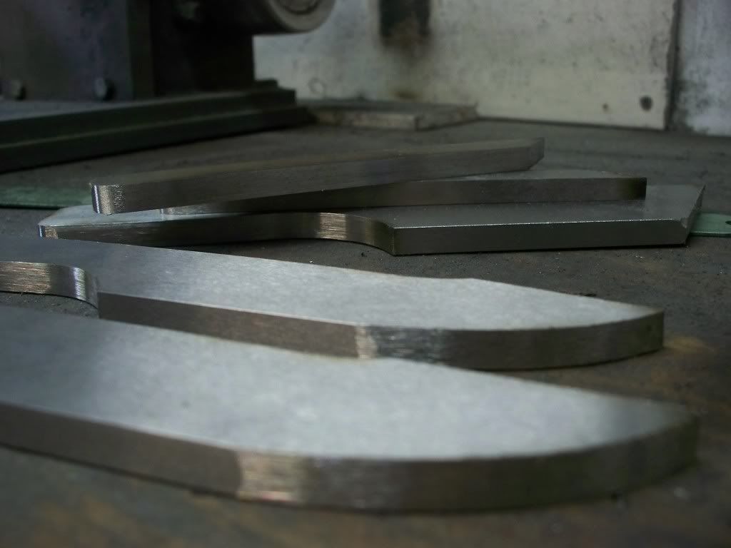

Thick knives coming up!
Two harpoon tips, one is already spoken for

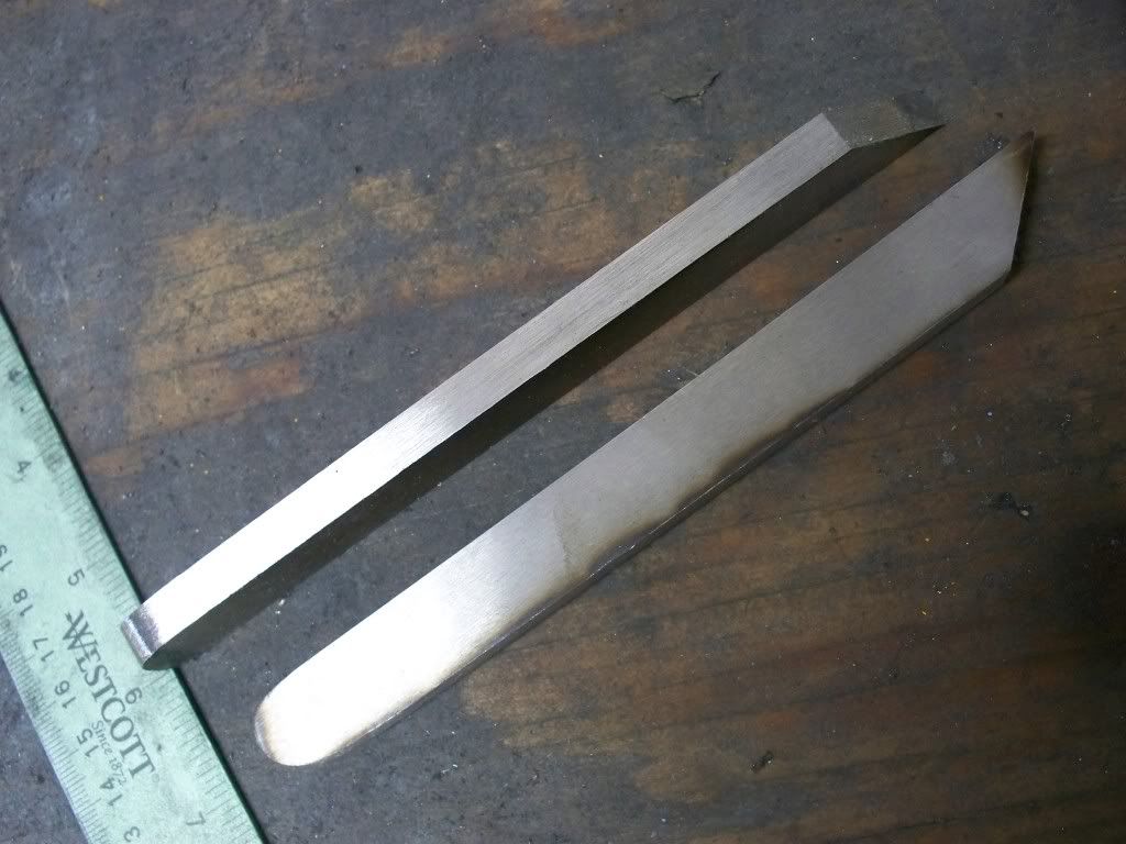

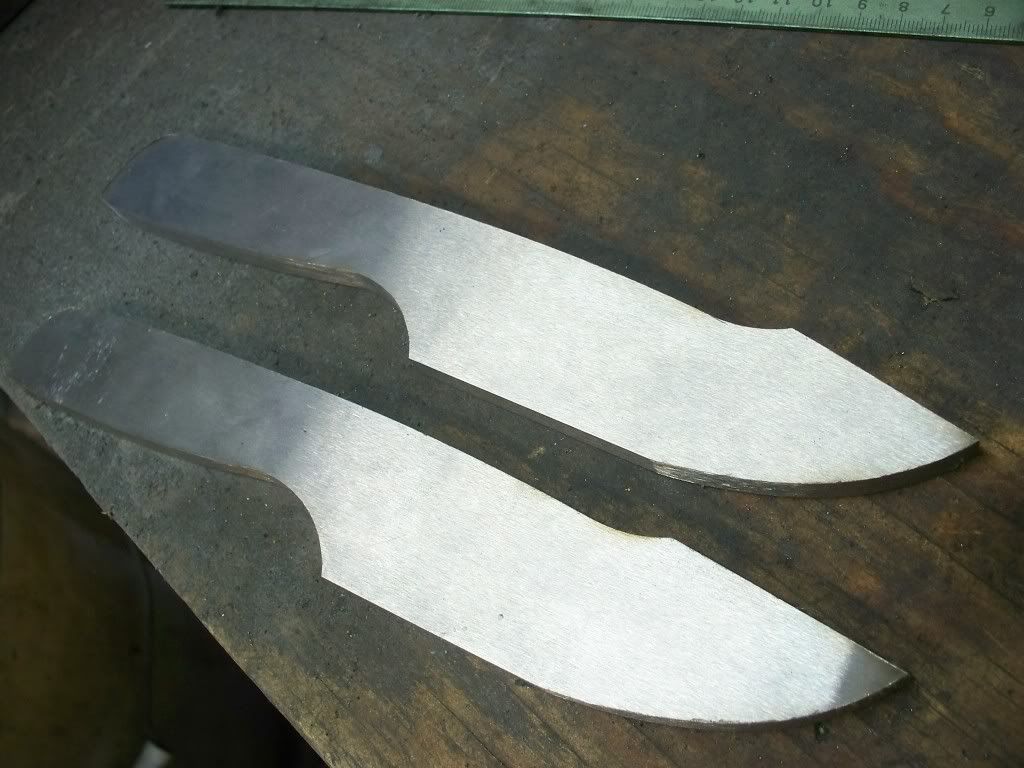

Two THICK tantos!
Ho-LAY *** :eek: That's some thick steel you got there :D
I'm curious what hardness you plan to take these to when finished. I'm planning to start using some A2 soon and I'd like to know how you think using stock that thick affects what hardness you can take it to.
Here is a great link to some data http://www.bucorp.com/files/aisi_a2.pdf
If I am reading the CCT Chart correctly any A2 in knife thickness should be fine hardening wise, it looks like you have 10 minutes to complete the quench.
You can hit 64 or more with A2 then there is sub zero which can give you a point or two more HRC with increased toughness as well.
I'll go to about 60 Rc for these. As always I'll hit the highest RC possible combined with the best grain size (middle of the road to low temps with long soak times) then double temper for 150 minutes each cycle to hit 60Rc. I'll probably do a snap temper, sub zero, temper, water cool, sub zero then one more temper for maximum gnarl.
I'm debating quenching at full thickness, I know they will be some work to grind.

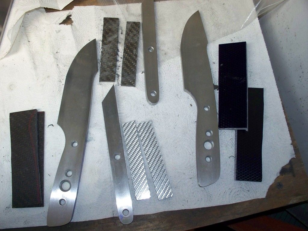

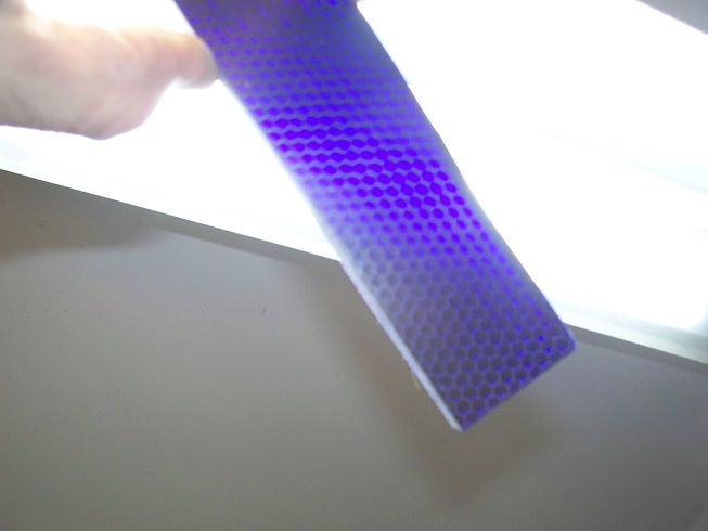

Taking a break from shaping scales here, I shape the fronts and backs before I grind the flats... less scratches to redundantly grind that way.
Man I'm itchy! Carbon Fiber
Man those are all looking waaaaaaay to cool! Love the look of the CTEK and the twill is just amazing!

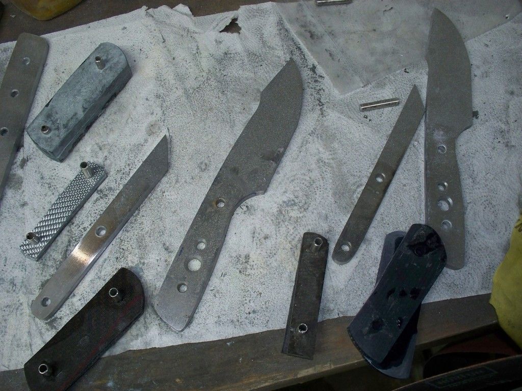

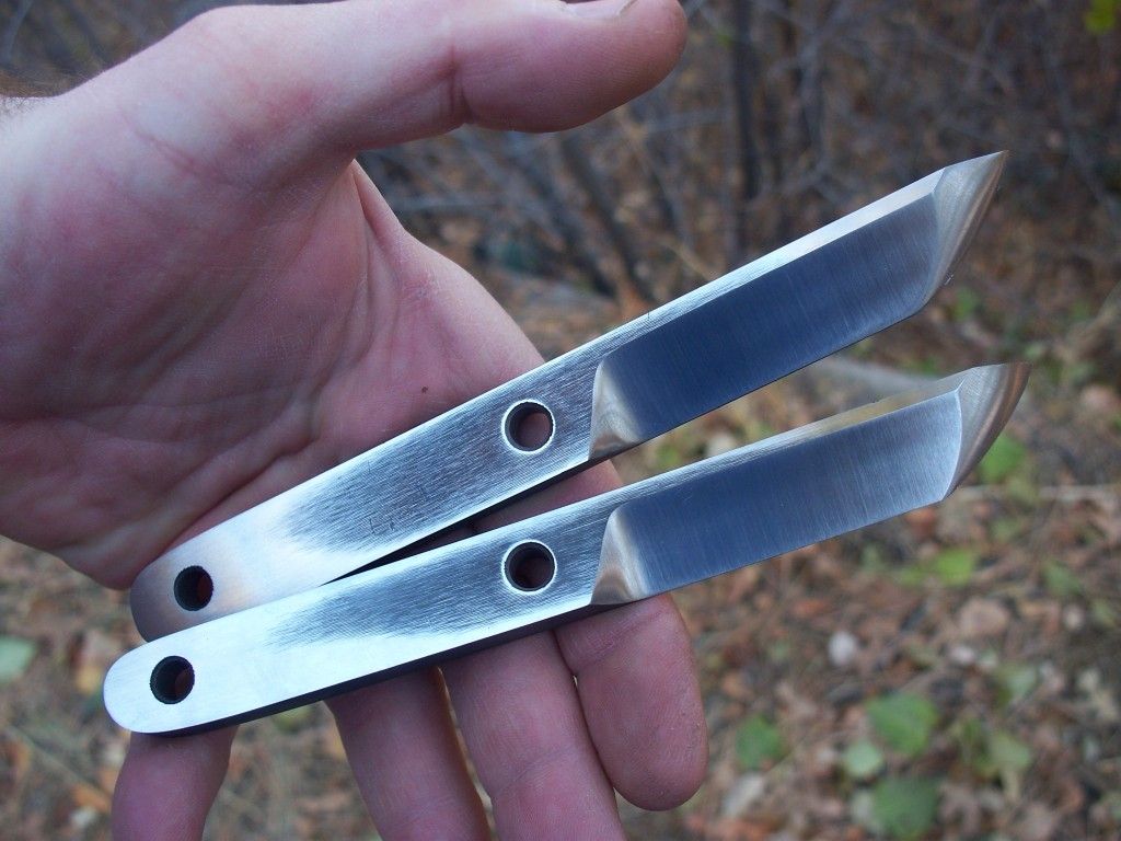

I have been mostly working on a warped knife/heat treat/regrinding type of thing but yesterday afternoon and evening I got a lot of grinding done.
Rough...
Nice!!!
I just got in from the shop, only 7:15 here but it feels late!
I worked on the scales of the tantos and the CF Poon tip. They look killer...

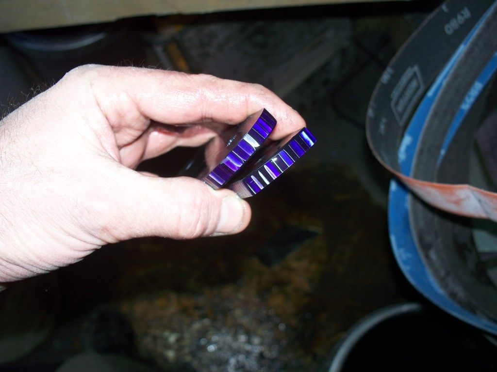

Waiting on belts for the mirror finish poon tip with purple ctek, I have it looking great but decided to belt finish to 2000 grit before buffing for maximum bling.
