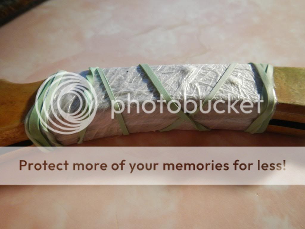

35 year old Buck 110
The black is residue, it will continue to come off as long as you rub with compound. Stop when you like the look of the brass and finish off with a clean, soft, dry cloth. DM
Ok. Thanks for clearing that up. So should I wipe it down with a wet cloth and THEN a dry cloth? Like the bottle says? Or no wet cloth. Everything I've seen online leaves out the wet cloth, but the bottle says to do that before drying
Either is fine but I think you should keep water away from the wood, until you've given it a bath in oil. DM

Ok, I'll stop with the wet rag then. You guys like my wrap job? lol.
I've got the bottom bolsters done so far (not shown in picture). Takes a whole lot o rubbin when they were as tarnished as I had them.
