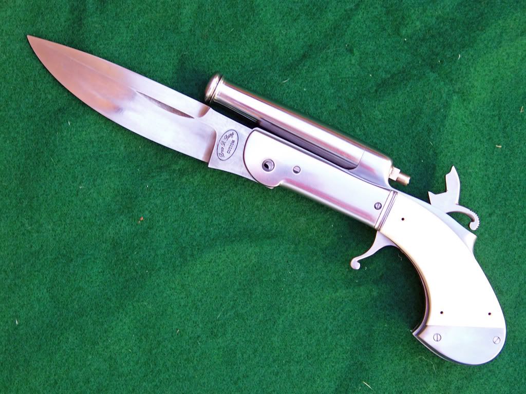

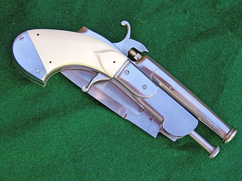

I've been holed up in the shop for a couple months and finally have something to show. This one is my first slipjoint on a gun. Its a feather pattern damascus on a 1018 frame with preban grips. Its the most contoured one to date and mechanically the best I can build. It is on the way to Jere Davidson for some engraving as we speak. Cant wait to see what he does.
Excuse the snapshots.
Well, the contours are beautiful. The way the web-guard sweeps up out of the handle is just right. I'm about consumed with envy.

I do test fire everything with the exception of the axe/gun. I have no doubt it will shoot fine but it needed to be shipped the same day and has never been fired.
This one has shot about 40 muskett caps but has yet to be loaded and fired. It has been loaded to adjust the ram rod length. A nice feature of this nipple design is it can be removed to unload the barrel or for easy cleaning. This hammer fits the frame very close so flash back stays out of the inside of the mainspring/sear area. It shouldnt need to be completely dissasembled for regular cleaning. It also has the easiest hammer spring pressure of all the others due to the geometry of the mainspring push rod. It almost comes back to neutral when the hammer is pulled all the way back. I acually had to add a heavier trigger return spring to add some trigger pull otherwise it felt like a hair trigger.
