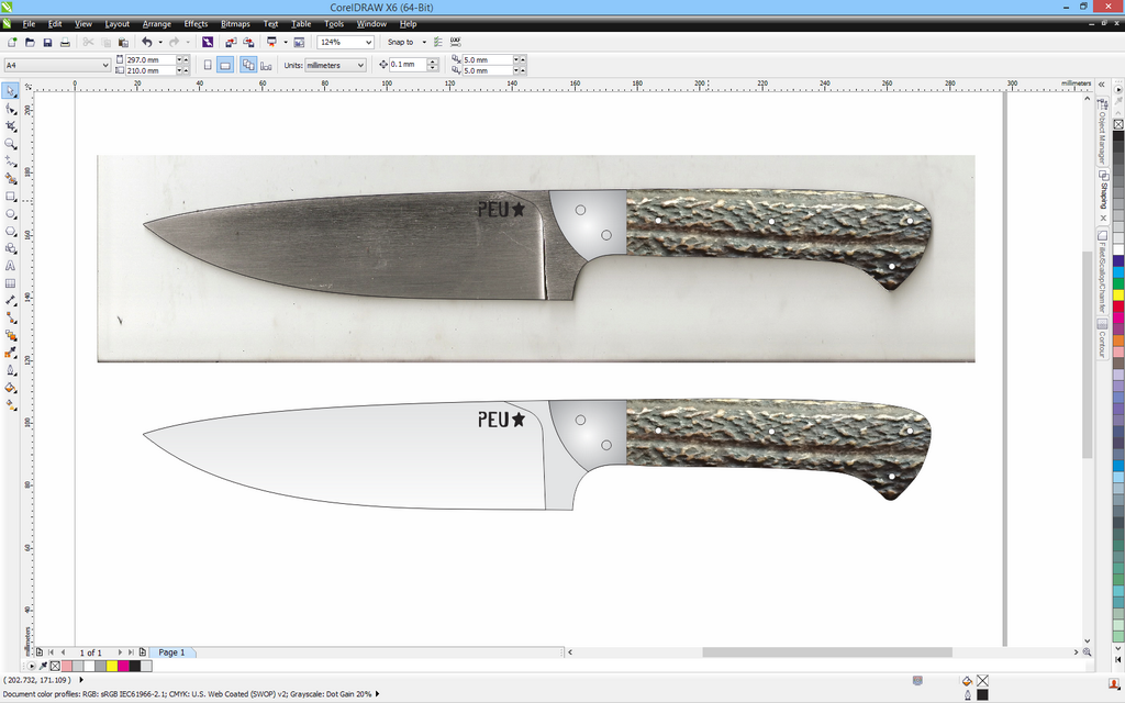

I'm fairly versed in SW and CorelDraw, and if you let me choose, my no brainer choice would be Coreldraw.
For fixed blades or folders its very powerfull and if you want, after finishing the design, you can export the profile as dwg and make a 3d model out of it...

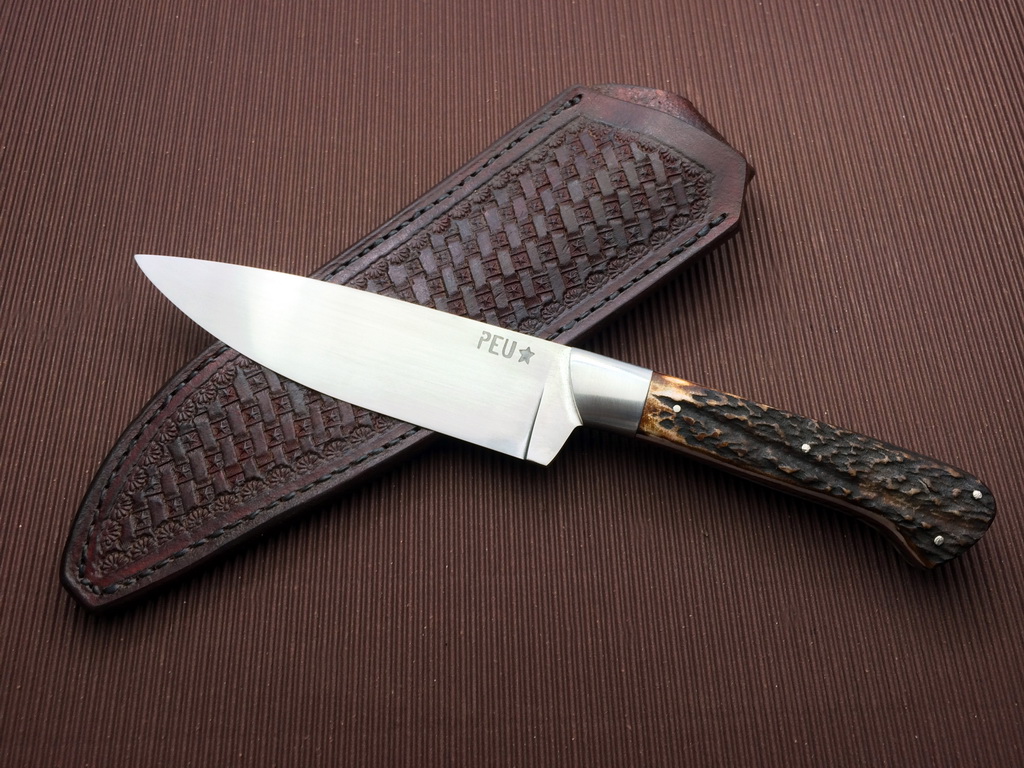

99% of the designs I make start in coreldraw, once I profile the blade, I use my flatbed scanner and paste into coreldraw the real version of the blade to adjust details of the bolster and handle.
Also the same for the sheat, here is the finished knife
