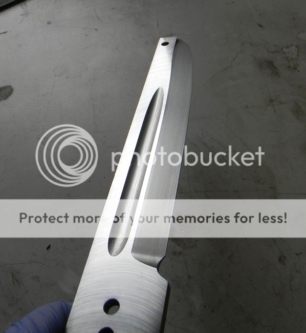

The spline I follow to mill my bevels is a complex 3 dimensional non-linear curve:
If the underlying geometry were made of lots of little tangent constant radius arcs the end result would be changes in the curvature of the surface at each one of those points. That is an inescapable mathematical fact, and one that a discriminating eye can see.

This is of particular importance if you want to machine those scales following three dimensional surface ISO lines. If you use tangent arcs instead of a spline you will have surface patches and it will be impossible to use that particular machining technique because the ISO lines stop and change direction with each surface patch. The only way to achieve that is to have a single continuous surface, and unless your scale is basically flat you can only get that with a spline.

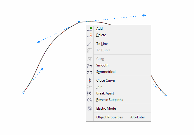

Let me plug again Coreldraw, it has the spline option, but I almost never use it, the node editing options give more liberty without the constant hassle of readjusting spline nodes, here are the options:
What I use constantly are the cusp/smooth/symmetrical options along with the shape adjusting arrows each node of a curve has. This gives you great flow of curves and IMHO more control than splines. Also, if you want to combine straight lines with curves thats easy too.

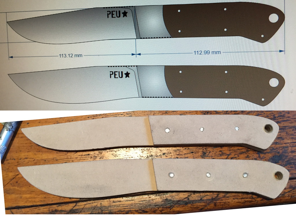

Curiously I do the opposite, I draw in corel, then cut with my CNC router in MDF, then if I alter the model I go your way, I use my flat scanner and then readapt the profile on the PC...
Today I was thinkering with a design:
the bottom model got its clip lowered a bit with the grinder
