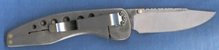

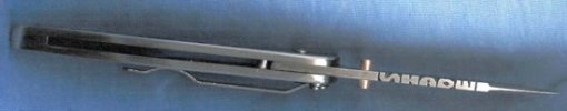

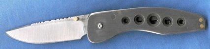

Alright guys, here's my 3rd framelock. Let me know what you think.
Specs:
Blade length: 3.25" , cutting edge:3"
Steel: .125" 440C (blade and handle, all heat treated in my forge and quenched in oil. Blade tempered 2X2 hours, at 400 deg. Handle tempered 2X2hours at 500 degrees)
Closed Length: 4 3/8"
Thumbstud:Bronze rod with copper tubing, peened together.
Pivot pin:3/16" from texas knifemakers
Pocket clip: Large Stainless, from Texas Knifemakers
I got a little crazy drilling holes in it but you gotta do something on a knife this size thats all steel. I'd guess that it weighs about 5 oz now. I'm sure it shows some influence from some of the other guys here. I've looked at alot of great knives and gotten a lot of great advice here.
I'll put in a few explanations of how I did things in the next post for all you guys who are wanting to try folders and don't have a lot of equipment.
Thanks for looking and please let me know what you think of it

One more pic also.

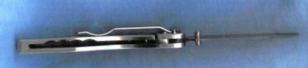

The Lock
First off, you have to shape the tang of the blade. I like to make the lock face fairly wide, maybe 1/4" or more. It has to be done at a 7 degree angle. A cheater way to do this is if you have a grinder with an 8" wheel, grind the bevel with that first. You will have to pay attention to whether it is a left or right handed knife, so you can hold it against the wheel the right way.
After the grinder I simply put the blade in a vice and using a file, carefully flatten and square up the lock face. If you take your time, this is fairly easy to do while keeping the correct angle.
Now put pins in the pivot and stop pin hole and put the lade on the handle slab that will be cut for the lock. Firmly push the blade to the open position against the stop pin, and scribe a line along the locking face of the tang on your handle slab.
Drill a small hole at the top of this line, to mark the corner of the tab. Drill another small hole at the back of the slab where the cut for the locking tab will end. These should be just larger in diamter than the thickness of whatever you are cutting the tab with (I'll go over that in a minute) Scribe a line from hole to hole.
Now I clamp a 1ft long 1"X2" board in my vice so that it sticks out to the side, and then use a C clamp to clamp the hanlde slab down onto the board so that its laying flat. I use a dremel with a reinforced cut off wheel to cut the locking tab. I'm cutting from the inside of the slab out, so I cut almost all the way through with the reinforce wheel and then switch to a normal wheel to finish. This gives a much cleaner, thinner, cut from the outside. DO NOT CUT THE FRONT OF THE TAB RIGHT ON YOUR LINE!!!!!!! That will inevitably make it too short. Cut just in front of the line so that its a little bit long and you will room to fit it.
If its a liner lock, you can go ahead and bend the spring and move on to fitting the lock. For a framelock you need to thin the tab out so it will bend easier.
I do that with a sanding drum in my dremel. Same clamping set up as cutting the lock. You can see that I went with a scalloped design on this one, I think this looks nice. It also makes a very stiff spring. You will have to play around with what type of cut you make, and how thin you make it. I would not make it any thinner than .040" thick, and would not take it that far until final finishing.
Once the spring is bent, you can assemble the knife temporarily and see if the lock works. You will need to do some more filing. you can either file on the tang of the blade, careful not to change the angle, or you can file on the end of the lock tab. The lock tab is the easier of the two and is what I would recommend doing on a liner lock. On a framelock you have to be careful as it will make a bigger gap in the handle.
Do not go hogging off a lot of material. This is a delicate process and you should stop when you have decent engagement of the lock. Do not take it as far as you want, because you will have scale to remove after heat treat and this will affect the lock up. Its a very touchy process but only requires patience.

Warrant said:
Nice job. I like the blade grind. And HOW the heck did you do the file work?Mike
THAT my friend is a secret, as I can't have you guys putting my name on the knives you screw up ;)
Ok I'll spill a little bit. Its mainly done with a tapered round needle file, knife edge tapered needle file, hacksaw blade (24 TPI) and a dremel with a diamond engraving burr and a fine cut off wheel.
The round file is used for the S. The cut off wheel is for the lines between letters. The hacksaw blade is used for the little lines in the H,bottom of the A, and the E. I use the very end where there is no set to the teeth.
The tapered knife edge file is to round corners on the letters. And the engraving burr is for the dot in the A and D.
It goes on there a lot faster than you would think :D
