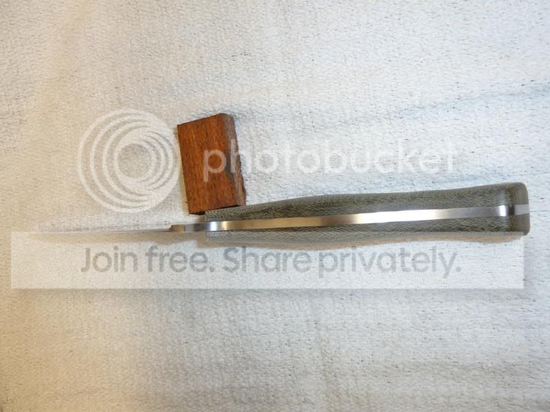

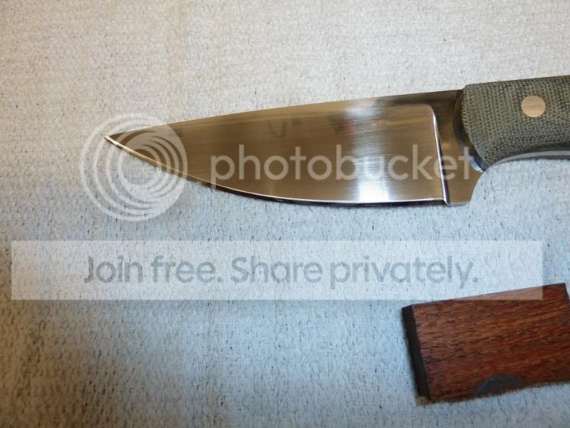

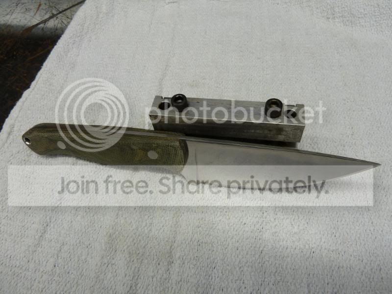

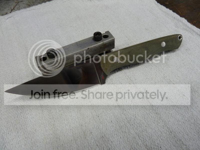

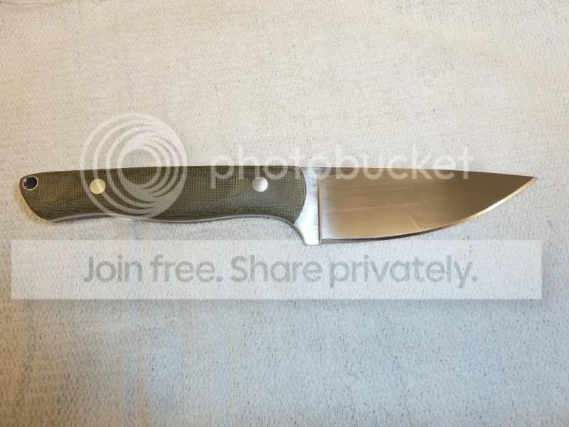

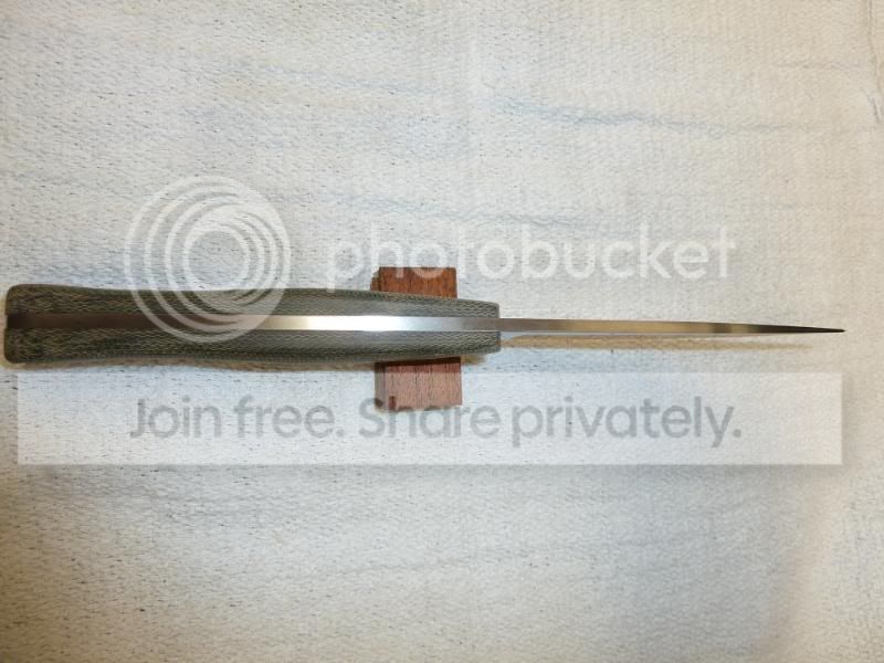

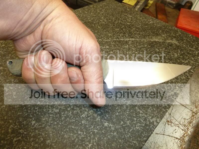

3rd knife, getting better!
Jun 8, 2009
97
This is kind of an everyday carry knife that would work well as a skinning knife.
Specs
CPM D2
Handle mat. Canvas micarta
Corby fasteners
Stainless 1/4" thong tubing
Blade length 3 7/8" from tip to plunge line
Handle length 4 7/8" from end to plunge line
OAL 8 3/4"
Full flat grind
Heat treat with Cryo for a hardness of approx 61 RC
A big thank you to Stan for allowing me to hang out and share his experience with me. It helps.
Thanks to Jamie and others for a fantastic grinder in a box.
Porter
Nice knife. I especially like the curvature of the handle the the micarta looks to melt into the tang very nicely.

Thank you. I have to give you credit for the inspiration. Your knives appeal to me. Functional with clean lines.
I have learned alot from the people on this forum, so thank you.
The grinder is on of Jamies "Grinder in a box" Still in the supplies for sale section. I bought the motor and VFD from Rob at Beaumont, as well as the small wheel attachment.
I think it's a great looking knife. It looks extremely functional.
As for your 3rd knife, that's awesome!

Sweet looking knife.... the tip profile looks just right... you hit a home run with that design.
Rick
Rick
Thank you. I redrew, (is that a word?) the blade shape 4 or 5 times until it felt right. I have admired your work along with many other talented makers on this forum.
How does one get that oh-so-slight curve at the apex of the plunge, is it done on the grinder or with files/sandpaper? I see that on a great deal of knives and I can't mentally picture how it's done. On a belt grinder all I see (in my head) is the belt cutting in and making a sharp 90 degree corner rather than a nice smoothed rounded one.
This was done on a 2x72 belt grinder, on a flat platen
The curve at the top happens naturally, unless you grind over the top of the spine. Did that on my first knife. I was shown how to run the belt over the side of the platen to get an even larger radius to the top of the plunge grind, but have not tried that yet.
