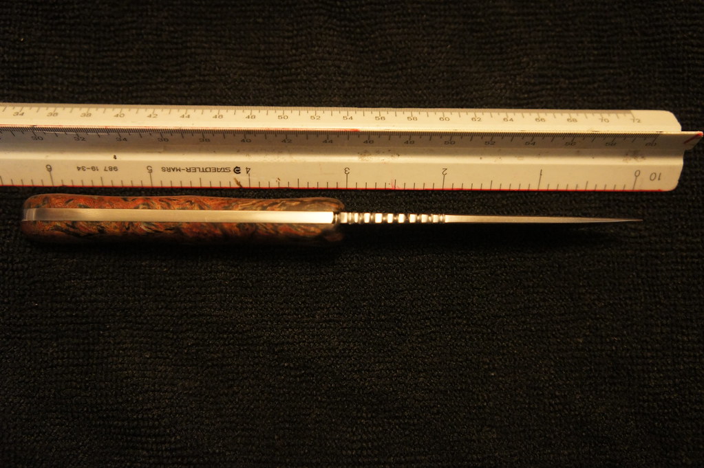

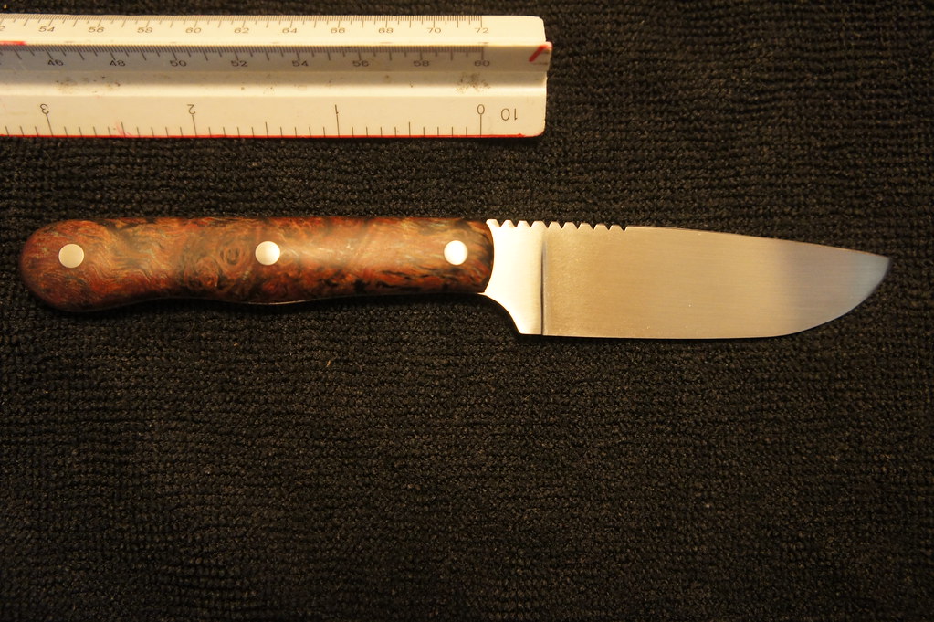

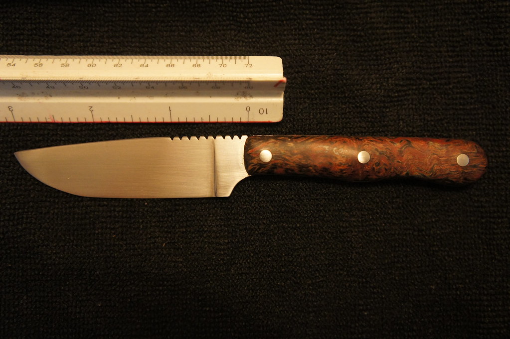

Well, I started on my third knife yesterday. Practicing my free hand bevels with a 2 foot bar of mild steel for a day helped me considerably. Thanks to all who gave me some tips the other day on doing free hand bevel grinds better. Although I did a FFG and kept this knife's style basic (not outside the box) and not as cool as my last knife (in MY opinion), I'm pretty much happy with it. BUT...
I am looking for some styling advice. Yes, this time I am actually asking for styling input but I am ONLY concerned with one thing. Everything else I am happy with in regards to the knife.
Here is the issue: Now that my third knife is done, the handle seems really small in height. The length is perfect but the height of the handled versus the blade seems weird to me.
Does anyone have an opinion on whether the knife would look better if the blade wasn't so tall? I wouldn't loose much cutting length if I changed it and there is plenty of belly to spare.
It's not a big knife, as you can see by the photos. Blade is perfectly just a tad under 3". So I don't mind if the blade is not as tall, if it makes it look better or "more normal".
Blade is not too tall, but the handle might be a tad skinny. It looks about as wide as it is tall.
The jimping looks like a series of stress risers, they should be like a U and not V notches.

Sorry it took a while to get back here....
I see that when you post a knife on here having people critique every aspect of the knife is unavoidable. lol
In regards to the handle material, my dad held onto the knife and said the same thing, "Is this synthetic?. Its actually just stabilized and dyed maple burl. It had a lot of blue and orange in it but the part of the chunk that I used didn't have much blue. I found it at a knife show and grabbed it because it had an ultra tight/fine grain structure. I have some left over and the next knife I make with it will have orange liners, which will help bring out the orange in it.
In regards to the jimping, it is indeed rounded and the entire spine of the blade is beveled from the tip to the end of the jimping /start of the handle. Athough the jimping doesn't go well with the knife, it is very useful with such slick handles and such a small form.
The handle is pretty boring and plain on this knife to me too. I wish it were bigger. I too like the size of the blade, it just doesn't seem to match up all that well with the handle to me. Too bad I can't make the handle bigger again! I guess I will leave it as is. In regards to the changes recommended for the handle; I don't know if you saw my first two knives (my tactical steak knives) but the rear of the handle was dropped and was fatter.
Rhino: When you say "oval shaped", do you mean, width wise, having a skinny front and rear of the handle? I usually like to have the rear of my handles dropped, but like I said, with this knife, it was plain jane. I uncharacteristically did not put much thought or creativity into the handle shape.

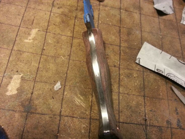

If you really want to redo the handle, you could knock the scales off, go back to the grinder, and make it a hidden tang...
Edit: I was trying to find a pic that demonstrated the 'egg holding' concept a little better and remembered this one. It makes for some interesting shaping to copy this many compound curves onto both sides, especially since I don't measure or use jigs... This is honestly one of the most comfortable handles I've made to date. I know it's not everybody's style, but it is the end user's style and that's what matters most...

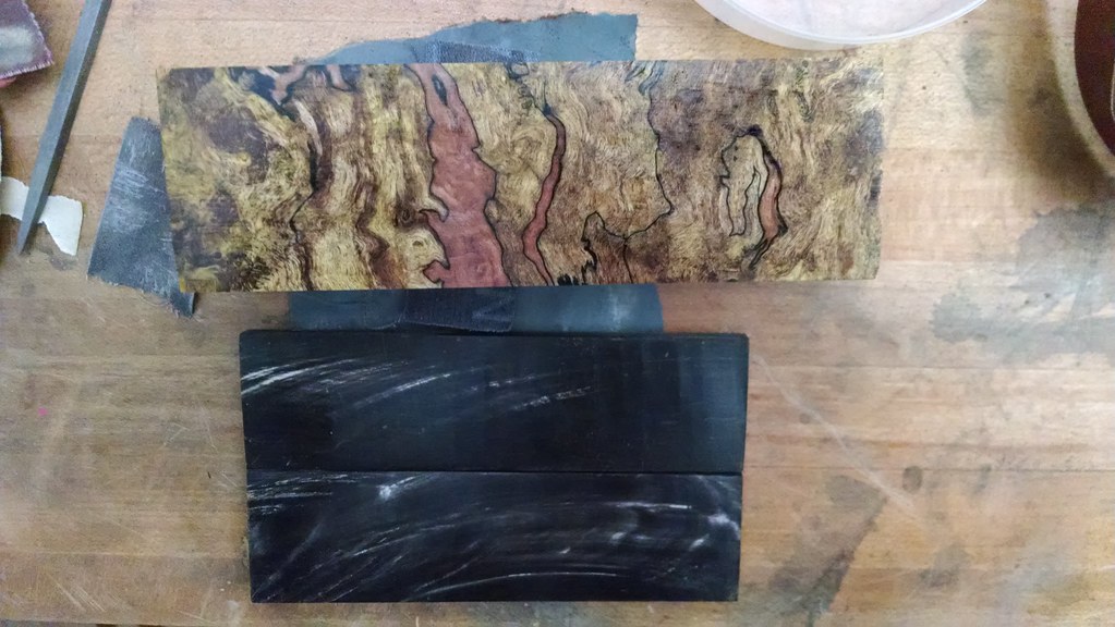

Thanks for the info. It looks like I'm going to have to look more into the finishing process that is on your knife. That is quite a lot of steps.
The handles were purchased at a on nice collectors show from a person that stabilizes handles for AG Russell and Buck. They are based out of Michigan but don't have a store front online. I have a feeling I was getting his "factory seconds" but they are great for $20 for a 2x6 piece.
Here is the other stuff I got from him. I'm not sure what I can do with the water buffalo since I don't do anything with bolsters.
Hey I just thought I'd add somethin really quick. I think what rhino was talkin about when he said "egg shaped" handle was actually the handle cross section.. I made a little picture really quick just to show an eggsample ;) so this pic is as if you were lookin at the butt of the handle, with the tang in the middle and the scales on the sides.. (obviously) :D
sorry Eric, not tryin to correct you or anything, I just think this is what rhino was reffering to :)

No worries Paul. I thought he was meaning both directions, literally egg shaped. If I could do an animation I would as I don't know if it is apparent in the photo... My handle there is fat up top and thin on bottom like your cross-sectional drawing, but actually takes it one step further by indenting near the index, flaring mid grip, and thinning in the rear near the pinky... Hence why I said it was a bear to duplicate those compound curved surfaces on both side of the knife.
Nice illustration BTW. and dzlvs8, it might not be the most striking design, but it is the most comfortable one. You have to draw a line somewhere between comfort and appearance. For my knives, comfort always wins out...

What Paul said and his diagram is what i meant, mine are a little more rounded at the top of the oval but that also depends on the size of the knife and a few other factors. I was in a dentist's chair for most of the day and am just now on line.
Now then there are what i call a total EGG handles that are entirely an egg shape that i put on a few hideout type fighters but that is another discussion.
Get some plastic modeling clay and take an Appox, 5-6' long x 1 1/2" square piece an squeeze it in your palm and see what kinds of oval shapes you find comfortable?
A coke bottle Palm swell and finger notches can be good too! I have my customers put their hand flat on a piece of paper and trace all the way around including the size of their wrist to have a reference whle I am shaping their handle scales once its fixed to their knife.
One thing i can tell you with full certainty is that a handle is better a little big than a little small cause when they are too small you are always trying to grasp it better and its fatiguing on the users hand.
