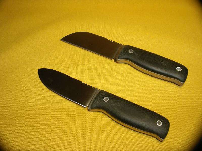

I finished the three blades, attached the white/green canvas micarta handles and started finishing them. Somehow I managed to finish this two blades earlier so I am posting them right here.

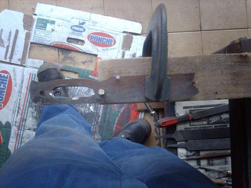

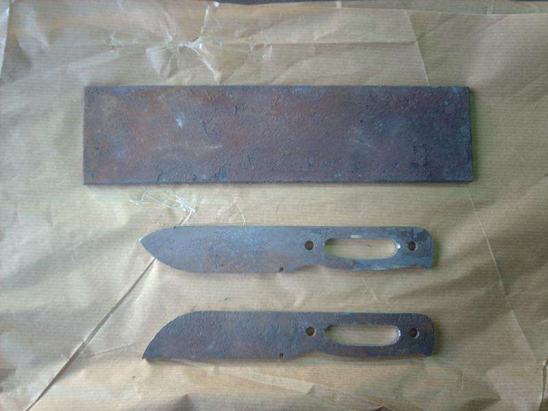

I won’t go over the whole process but I will tell you that I started with 5mm leaf springs for the blades and worked on them with an angle grinder, files and a drill. I skeletonized the handles to save weight via files. I did the spine cuts (non slipping purposes) with a 1mm cutting disc on the angle grinder. One blade came out fairly good (evenly spaced) but the other did not. I don’t have accesss to liner material so I just made a slab of pseudo-micarta with three strips of thick white canvas and about 14 strips of thinner green fabric (not exactly canvas but close). Blade is sanded up to 600grit (both knives have been used prior to taking pictures… sorry… I couldn’t resist) and the handles up to 800grit. I don’t have a buffer.
A few pictures of the process:

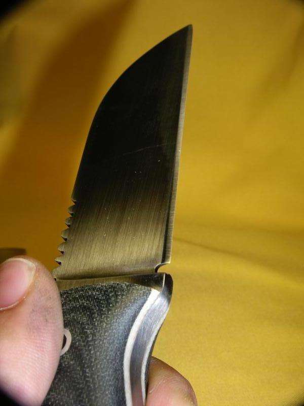

Feel free to say what you think about them. So far I can see I left a few deep scratches near the ricasso area (PITA to sand by hand). The glue line is visible in some spots (got to fix some kind of rig to distribute the pressure from the clamps along the whole length of the handle slabs). Next time I won’t do any spine cuts (hot spots and blade weakness).

They look good, and especially good for knife two and three. Don't worry about the glue line. You can dye the glue with epoxy colorants to match the handle material to eliminate the problem. Keep up the excellent work.
Do yourself a favor, and order some steel.Buying some precision ground blade stock will make your life easier,too. A piece of metal will only cost from $10 to $20 ,depending on the type, and should make at least two knives.You can decide on the thickness you want, not the thickness you have. AND, you will know what it is for a better heat treatment.
Take a piece of micarta or hard wood and use it as a backing block for hand sanding. It makes for flatter sanding and better scratch removal.
Try a shallow curved depression (about 1/4-3/8" deep) for the thumb, instead of those saw teeth. It is more comfortable on the finger, and still provides blade control. I center the curve right above the ricasso, flowing the curve into the handle.

Thanks for all the good advices Stacy. I will try to apply them to my next batch. I need to ask in the Spanish Cutlery forum ARMAS BLANCAS about the dealers who can provide some precision ground blade stock. I am thinking about a few neckers and 5mm seems like overkill to me... :D. I still have a lot of leaf spring left (even thicker!) so I will be crafting a few bigger knives. My main problem is getting the pieces straight...
