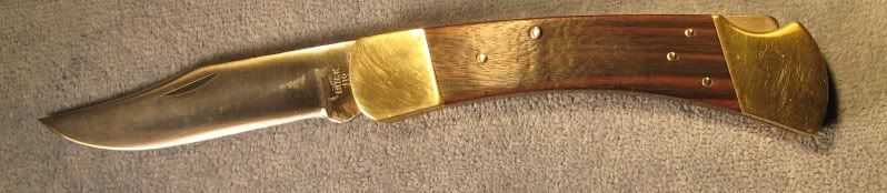

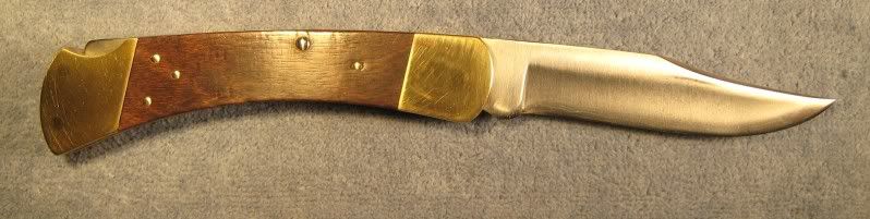

I think I agree with that, hadnt really noticed that particular var. I think there has got to be a rivot on the right side that I just cant see. I questioned the wife where the mag glass got to and she couldnt answer:mad:

Flat, it can't be a Six because if it were, the single rivet would be higher up than what Fritz shows......more centered.
Since it is not.....and indeed shows up where it would if there were two rivets, we must conclude that there is a second rivet above it that can't be seen. This is not unusual.
Joe pictured one, a single-rivet 110, in one of the links I gave Fritz yesterday and the hole is centered along the edge of the back bolster.
Has anyone ever seen one with the single rivet down low on the back bolster like Fritz's?
I haven't.
Note: Joe's labeling of the picture is old info......before he added versions, I guess.
And, while it COULD be a Five......that would mean that there are two invisible rivets.
Not likely, but possible.
So, I gotta say that the most likely conclusion is that Fritz's 110 is a Version Three, Variation Three.
Nice knife.

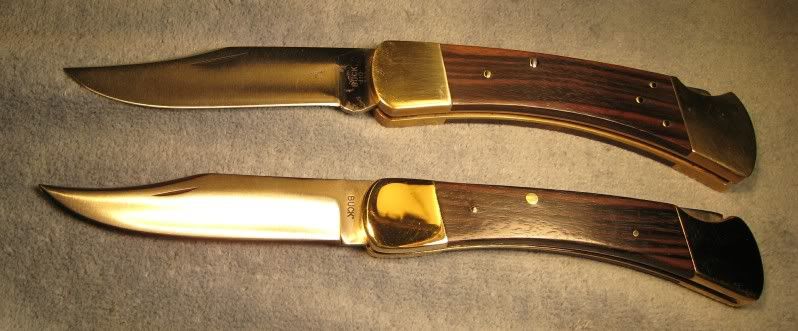

Seeing that single rivet bolster, most likely conclusion is that Fritz's 110 is a Version Three, Variation Three absolutely works for me.

God, am I glad I don't collect 110s. Fixed blades either don't have as many variations in the early ones or, at least they are not as well documented.
Flat: I do note that Joe states that the rocker rivet is "brass, stainless?" for the V5-1v.
Fortunately for me the couple that I have (well a few more) don't have but one variation.
Telechronos:):):)
Very nice knives, Telechronos.
Note how that nail notch on the early one stands out.
That was what first caught my attention about Fritz's knife......it had the "Early-Looking" blade and nail notch, so I started to go WAY back in the Thirds to look for it.
I know, 110 Dave thinks I'm anal (and chides me mercilessly) for so closely scrutinizing things like the depth of nail notches and dots, etc., but 110s are so complicated that you have to consider every tiny little thing.

Man those are sweet tele. Can we get a little better look at the top one?
