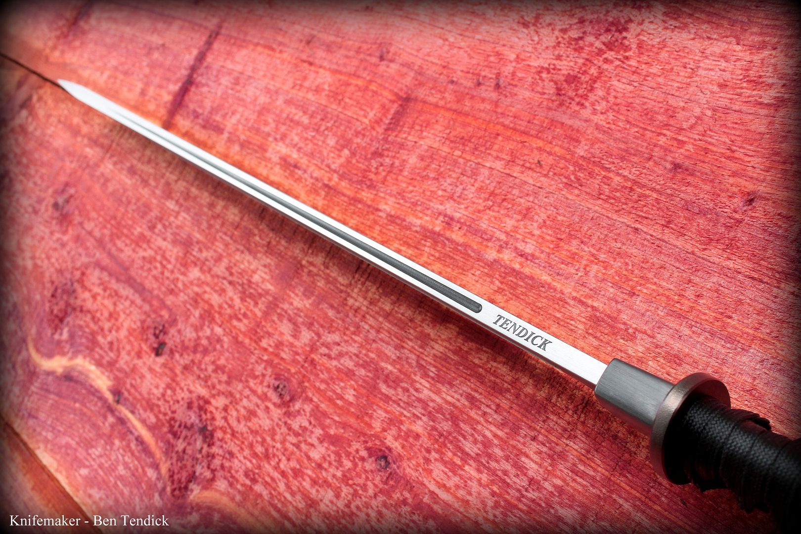

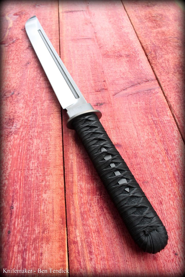

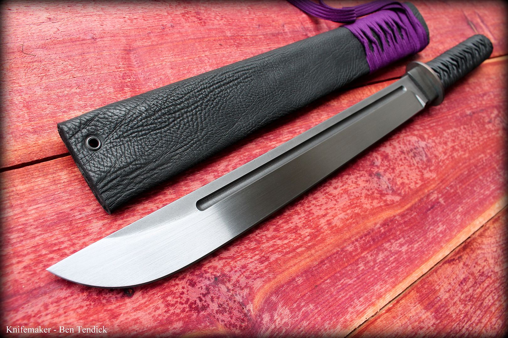

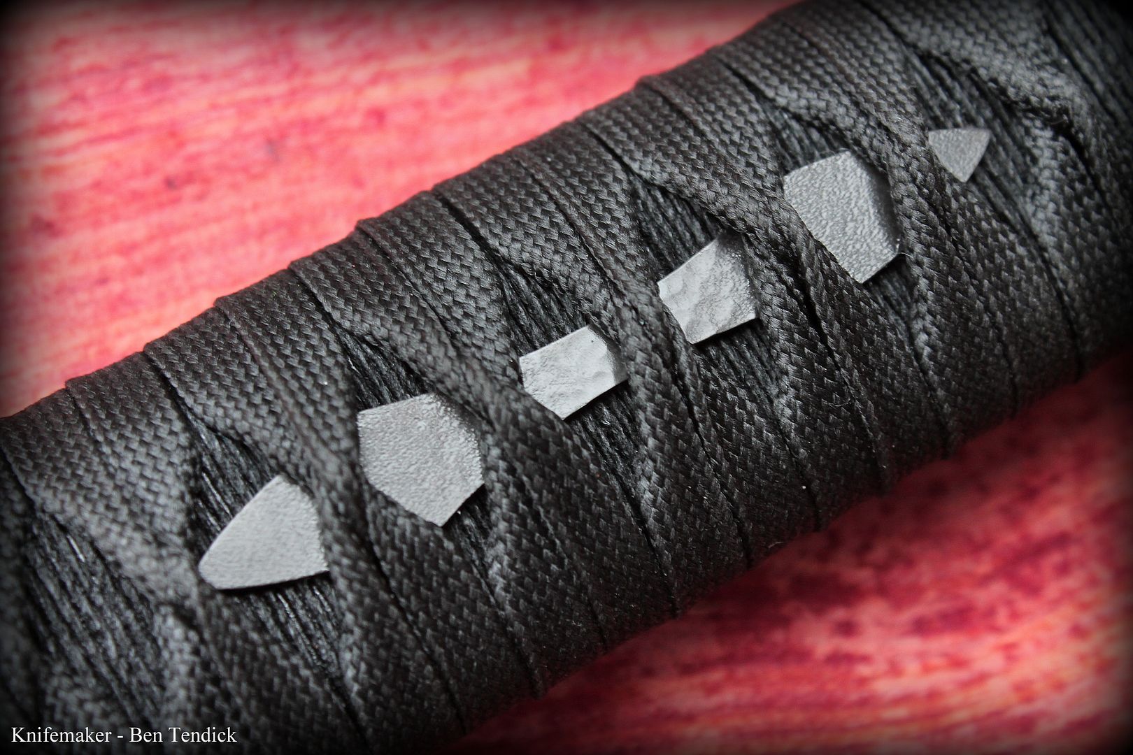

Just finished up this order for a good customer of mine. It was a challenging build, but I am pretty pleased with it.

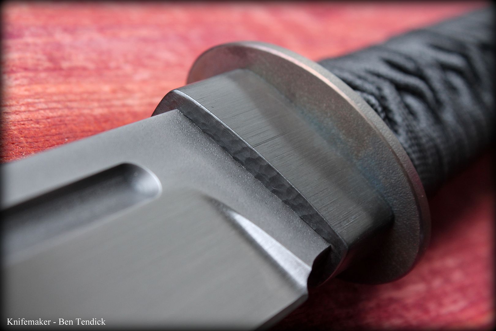

This one I made a 1 piece Zirc Habaki. That was probably the trickiest part of the whole build. Not sure I would do it again, but it was something I wanted to do because I have never seen it done before. The Menuki is hammered and orange peel Zirc as well.
The guard is Titanium and the handle wrap is soaked in G/flex epoxy.

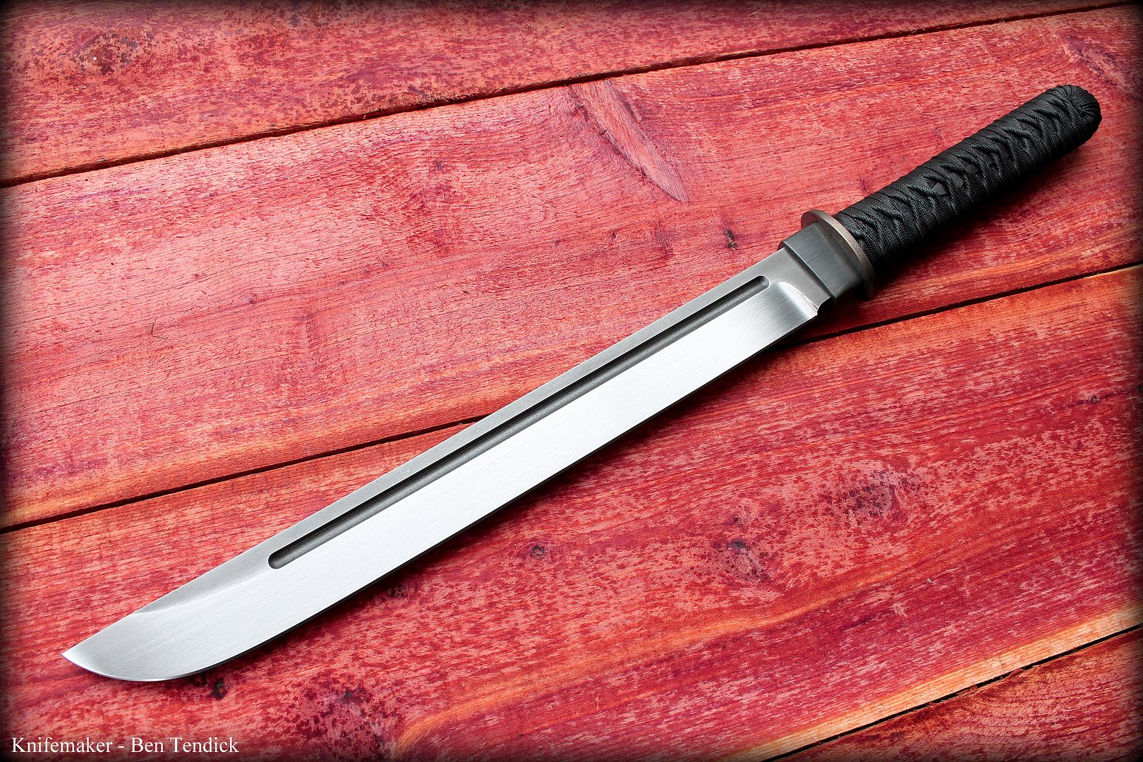

The blade is 15" of .280" 3V with fullers on the sides and my signature tapered fuller on the spine. OAL is just shy of 24'

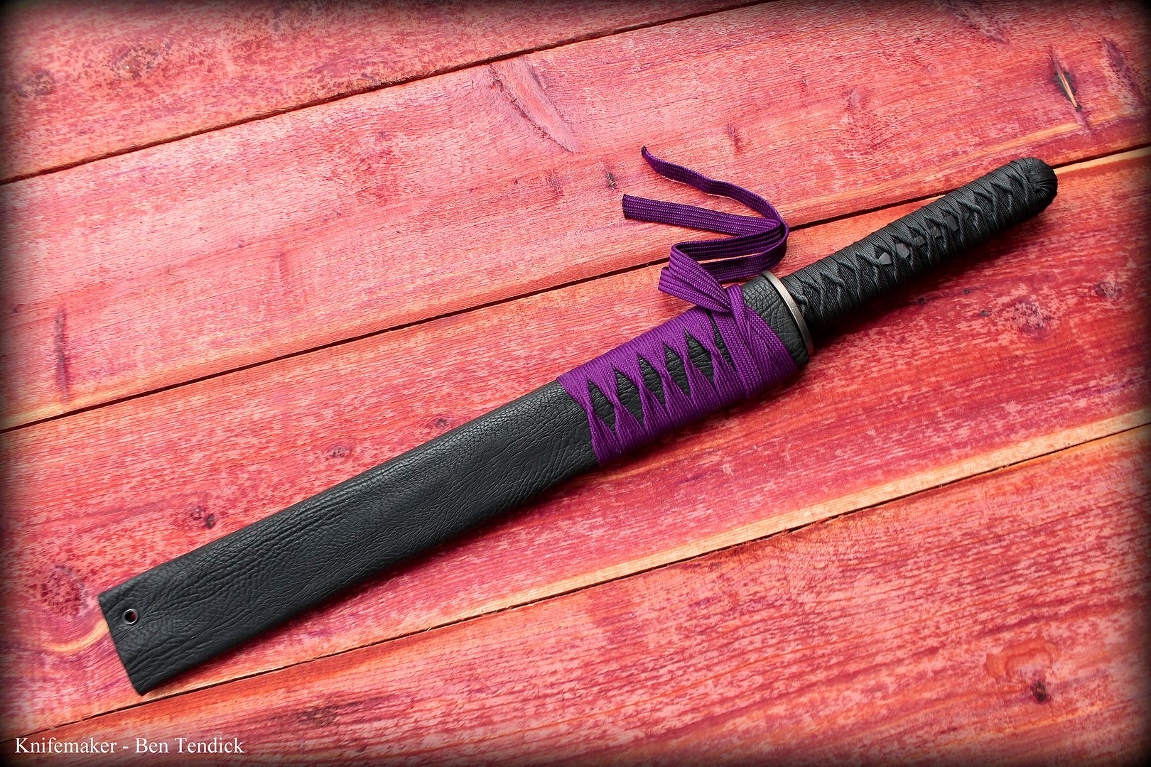

The sheath is wrap around kydex, with a synthetic suede liner and bison hide cover.
Comments are welcome.

I really like the sheath.......maybe rounded at the tip would look better, but otherwise it's great, and a huge leap ahead of your sheaths of not long ago.:thumbup:
The habaki looks a bit too chunky to my eye(but I am no expert), and I'd prefer to see this blade with a bit more sori........or maybe just with a longer point like the tanto you posted recently. Its well done and clean, but seems less graceful to me than the tanto in this thread IMHO:foot:.

Very nicely done, Ben. Love to see your work and its evolution. :) How's the zirconium to work? Don't think I've seen anyone hammer it before, though that means little.

Everything looks really great until you get to the top of the sheath. It kinda looks like you said ...." I am so tired of working on this"...lol

Traditionally, yes the habaki would be a bit thinner.
I agree that the tanto is more elegant but I don't think using that tip style with a wakizashi would look right. The tanto looks right because it's closer to the shape that they actually were. With this piece, some sori would be nice as you suggested and I think a slight reduction in blade height towards the tip would also help. The uniform blade height, straight spine and steep tip angle all combine to give it a stout profile.

Thanks for the comments and critiques everyone! This is a style I am still developing, and I am sure will change as I go. It is merely inspired by the Japanese style, and is in no way meant to traditional.

Thanks for the input Darcy. I agree the pointier tanto is a bit more elegant. That design is more traditional (for me), in that it is designed for "soft" targets. :cool:
The Waki is mostly going to be used for chopping "hard" targets, not a traditonal use. Most of the people buying these want to chop throught trees, so the added weight and beefy tip make sense in that regard. It does have a bit of Sori, although it doesn't show in my pictures.

Thanks Adam. Yeah there are only so many ways to end this type of sheath with the leather wrap. A bit more rounded is possible though.

Thanks, and you are right on. It is meant to be a stout blade.
