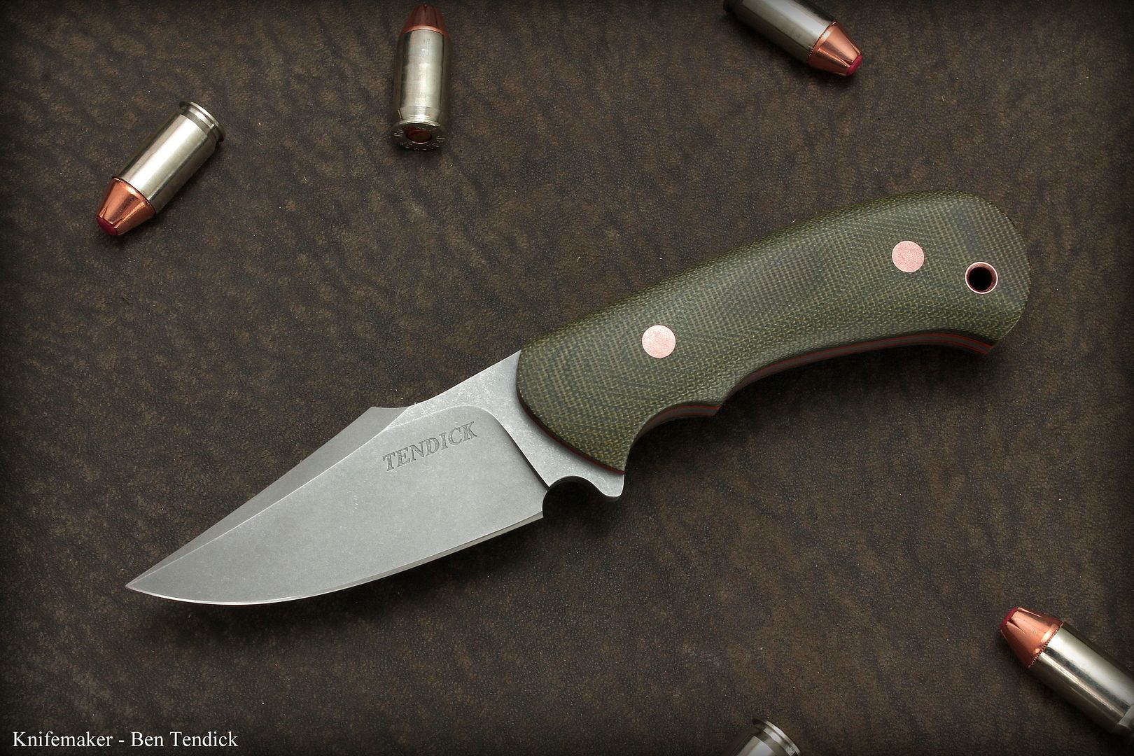

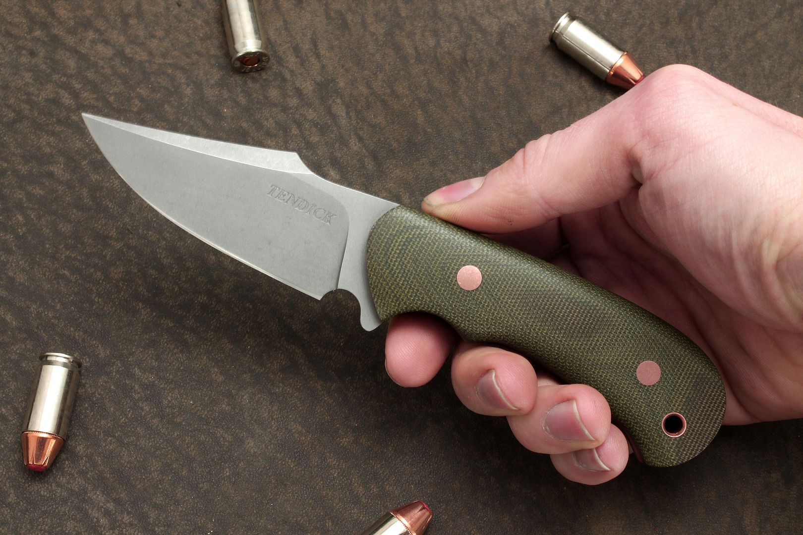

For this new design I wanted to take the lines from some of my favorite big fighters and mix that with my favorite small knife. The Loveless NYS.
What I ended up with was this compact little powerhouse I call my "Wingman" pocket fighter.
These first couple I did in CPM 3v at 62rc. I do my own heat treat on these, which includes proper LN Cryo and a low temp temper (thanks to Nathan Carothers and Dan Keffeler for HT pointers).

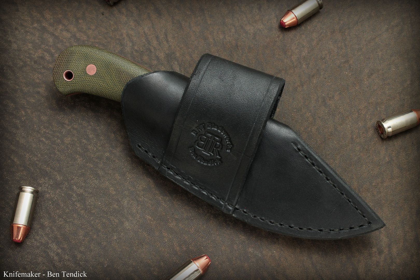

I hand stitched the leather cross draw sheaths to wrap up the package.

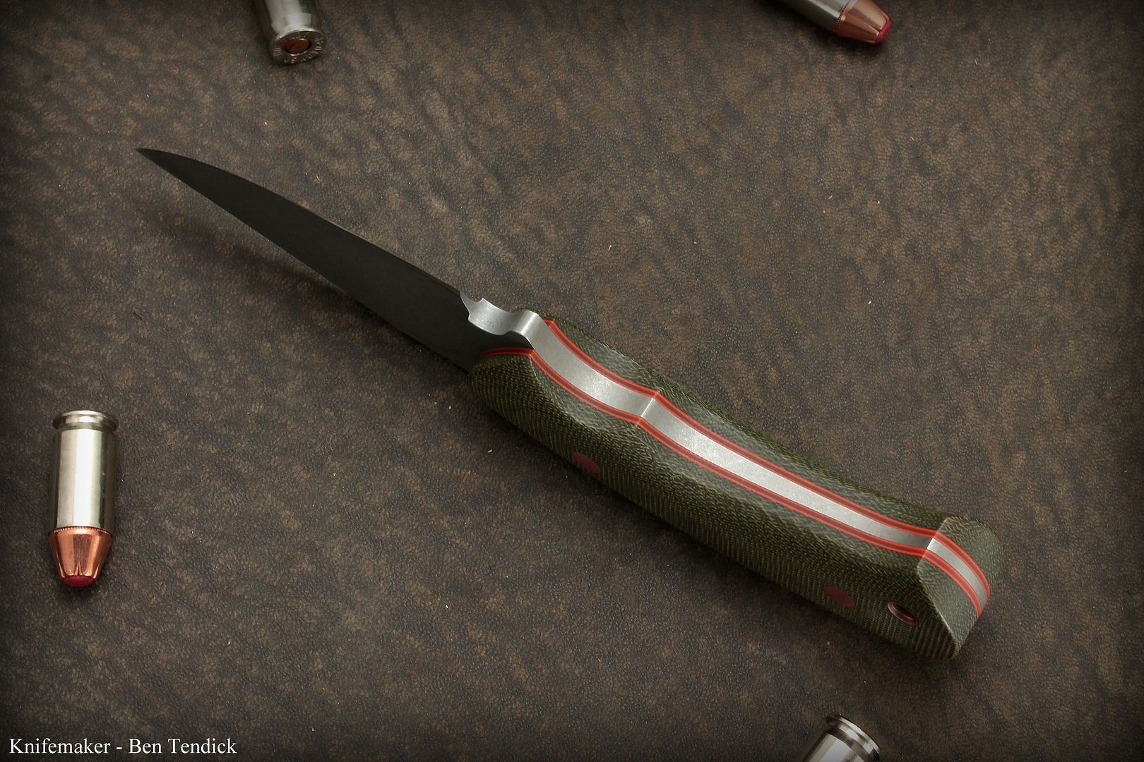

I blasted the green micarta on this one and then tumbled the whole thing for an nice grippy feel. This also give the copper pins a cool look.

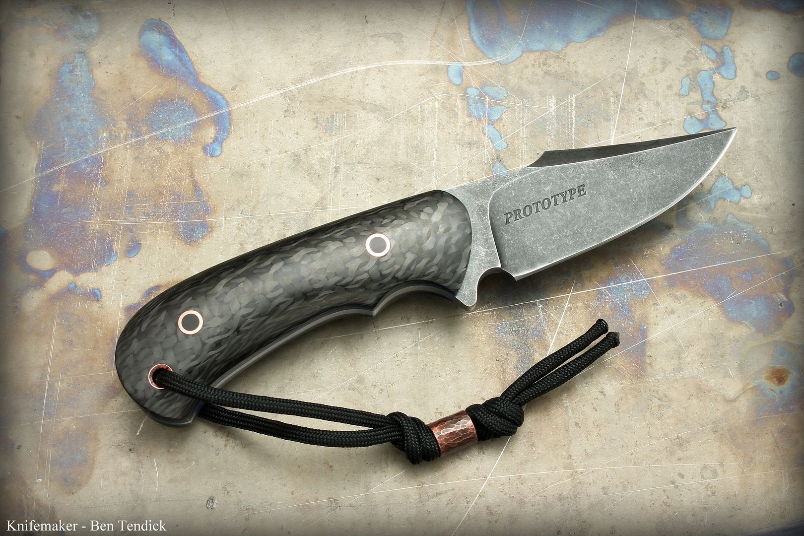

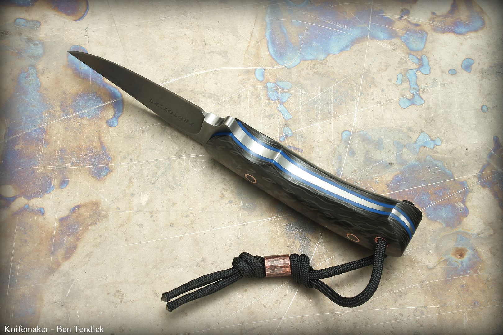

The carbon fiber and glue g10 Prototype.
Nice feature with the tapered tangs.

Copper on Copper with a tapered tang on a nice blade.

That's a fine design Ben. I'm especially fond of the prototype.
Are the raised blade spines sharpened?
Thanks for all of the comments guys.
The clip is not sharp Kevin, wanted to keep it legal to carry. At this length it should be legal most everywhere.
