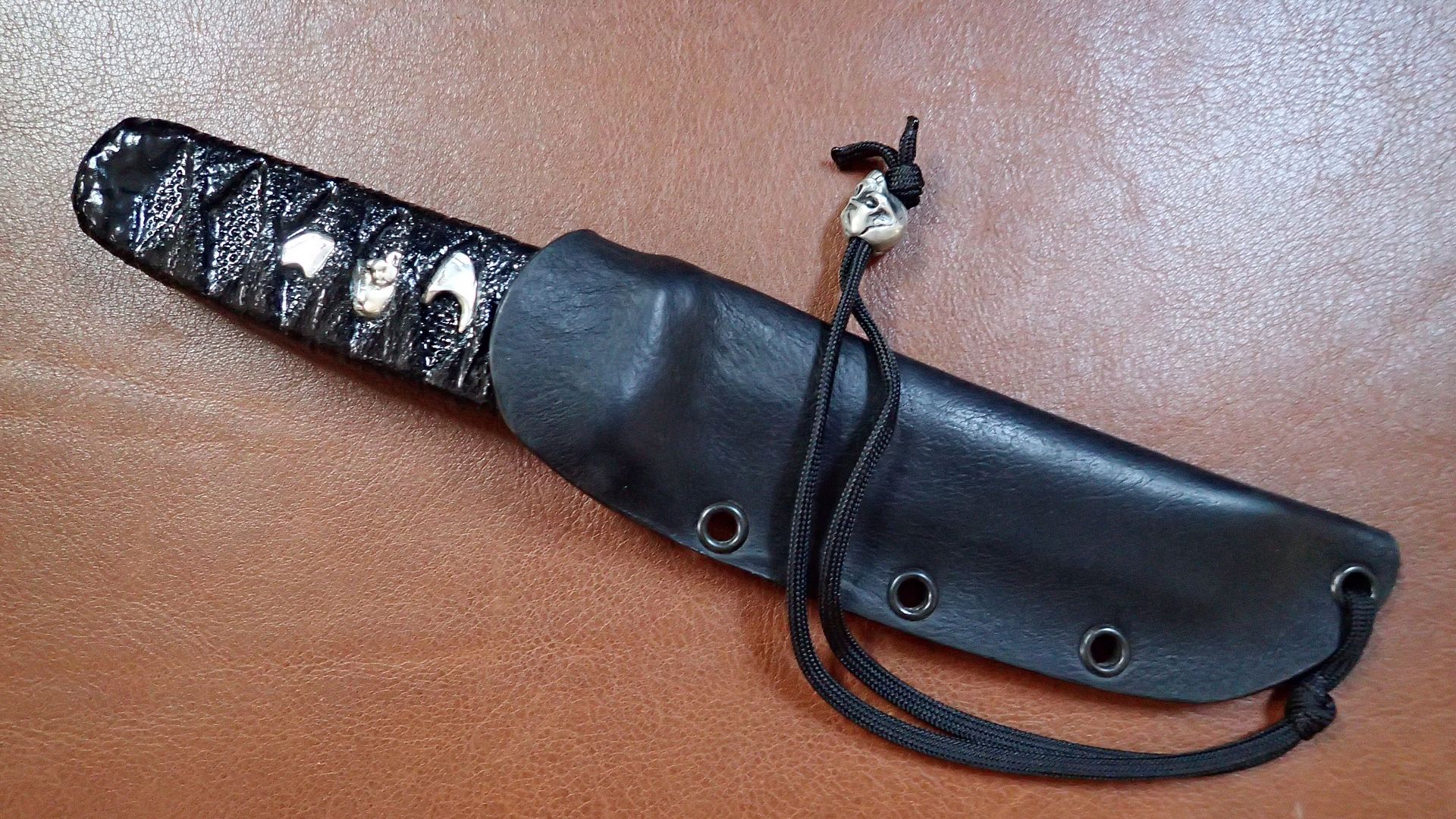

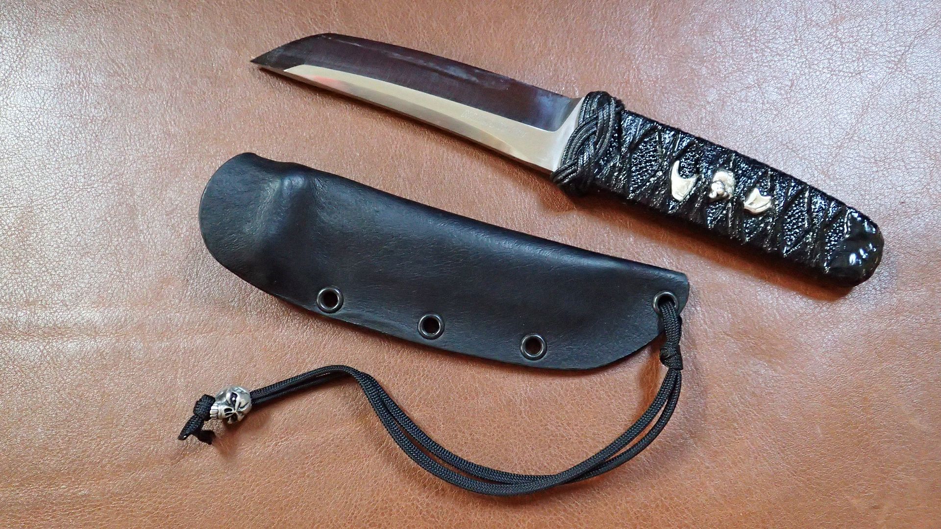

I think Kydex, in one form or another is really the most practical, and cost effective solution. A narrow taco sheath, or maybe more of a scandi style sheath with the seam in the back, and then wrapped in leather or an alternative is probably the route I will go.
These blades are wider than a traditional blade. So a traditional/modern saya adding width to both sides of the blade, doesn't seem like a good option to me.

Is it a two piece sheath? Not sure how I could do that with a one piece kydex sheath.
Ben
Here is a pic of a PH Bkade in the metal Saya wrapped with leather (elephant)
The other is the Martin piece in its original Carbon and wood sheath that has Magnets in it to hold blade
I will snap a pic of the leather lined and covered one he did and also post it
Ben I was mistaken :)
RJ uses some type of felt like Phill did
Taco formation wrapped in leather
Imho really takes Kydex to a different level

Seems like it was worth the effort....now you can actually use it!

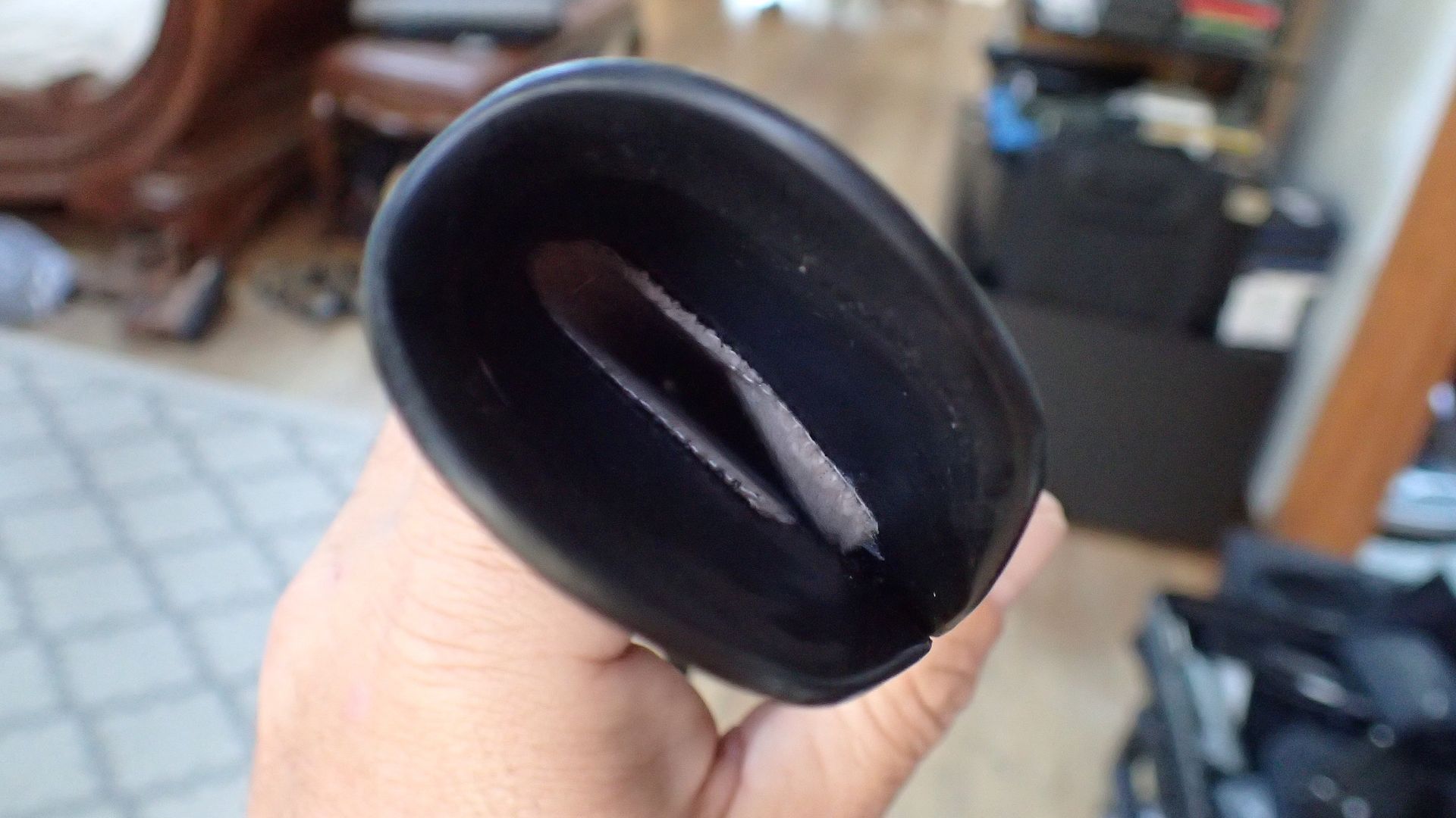

I am assuming on the RJ sheath, the felt is applied with an adhesive, which would have to be done prior to heating the kydex. I guess once it cooled down, the adhesive should remain functional even if it softens during forming.
The PH Sheath would be simpler, as from what I understand it was cold formed aluminum.
I picked up some thin leather yesterday, and am doing some experiments with wrapping kydex. I have another waki and a tanto I am working on right now, and will try out one or two of these styles on them.

Picked up some nice synthetic suede, it should be great as a liner and less likely to hold moisture or grit than felt.
