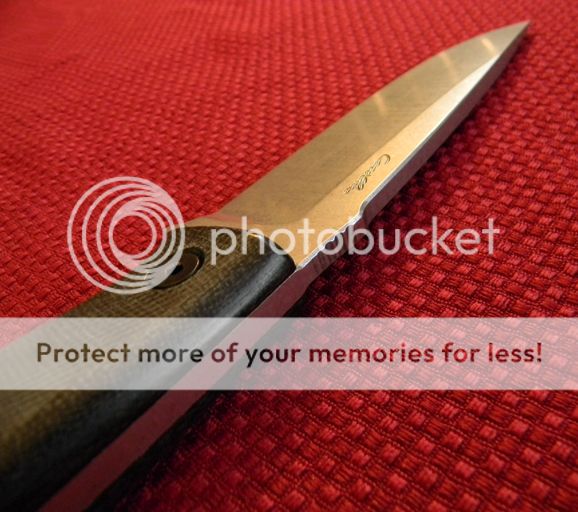

This is a new pattern designed as a collaboration with Lorien Arnold. My goal with this was to make a high quality, affordable, working tool. So they're all just milled and tumbled, no fancy finishing. We're finishing up a sprint run of 20.
11.jpg~original
12.jpg~original
13.jpg~original
14.jpg~original
15.jpg~original

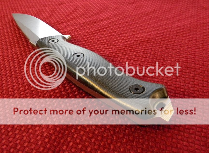

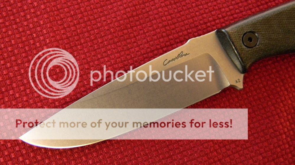

4 5/8" blade, 3/16" Latrobe A2, HRC 61-62, 8 oz (in micarta, a bit more in G10). The tang is skeletonized. 9 3/4" total length.
The blade was milled to .015" before sharpening and I'm leaning toward sharpening these at 15 DPS, so it's geared towards cutting, not prying. There is a pry in the tang.
Heat treat was optimized for edge stability.
I'm very pleased by how this turned out:thumbup:

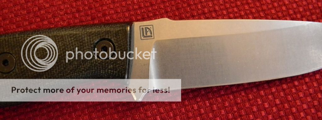

That's a great looking knife. I love the chamfers on the spine and guard. What setup did you use to mill the blade bevels?

These are sweet, can't wait! Just wish there wasn't that "LA" on the back side.. :D
