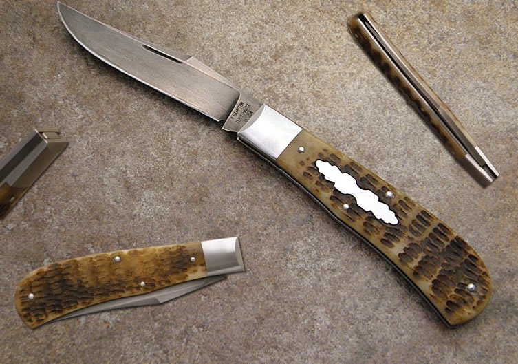

And yet another Christmas gift...this time my daughter ask me to make for one of her X's (yea you heard me right :rolleyes::confused::)) This one is made out of A-2 and is etched with ferric chloride, has some rich colored honey bone, and I topped it off with something different a Challenge Cut. Co. shield. The knife is half stopped and flush jointed with the spring and tang flush with the bolsters in the closed position. This particular blade was ground about a year ago on a 10" wheel so the tang flat is bigger and I cut a straight pull. Now I grind these blades on a 14" wheel and a crescent pull is used.
Very nice Kerry,that has a look all it's own.I hope your daughters intensions regarding Mr x,and this knife,are OK,or,legal?
Better keep an eye out on this one.

Geez ! your Daughters' ex is one lucky guy , in the respect he's getting a killer knife for Christmas. :D
Very , very nice looking. :thumbup:
Neat Backpocket, Kerry! :thumbup: The etch gives it the look of an antique. I bet that shield was fun to inlay. :eek:

Love the etch, shield and jigging. Good work Kerry!
Super folder there Kerry. But I can't help but wonder, if you daughter is giving such a nice knife to her ex, what's she giving to her current???
Thanks for all the nice comments guys and gal. :) The shield was a BEAR to inlay with tiny chisels but jigged bone is very forgiving. The Ex is actually a good guy and the dad of my #1 granddaughter so it will be well cared for.
