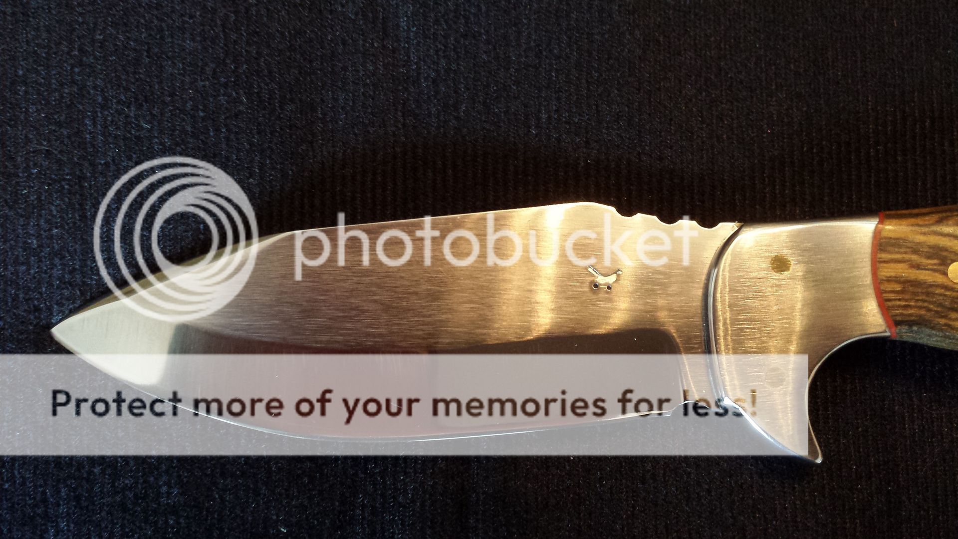

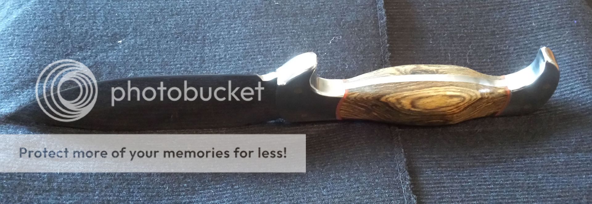

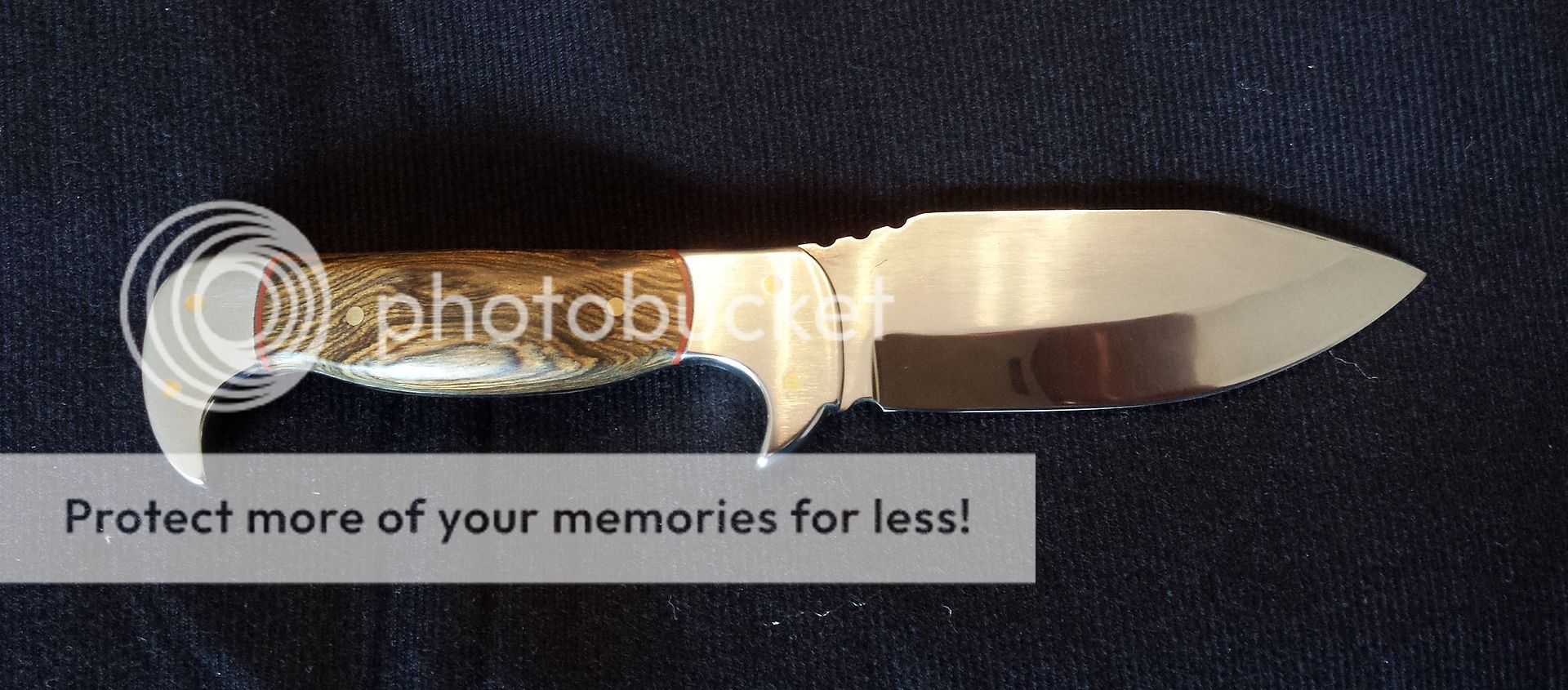

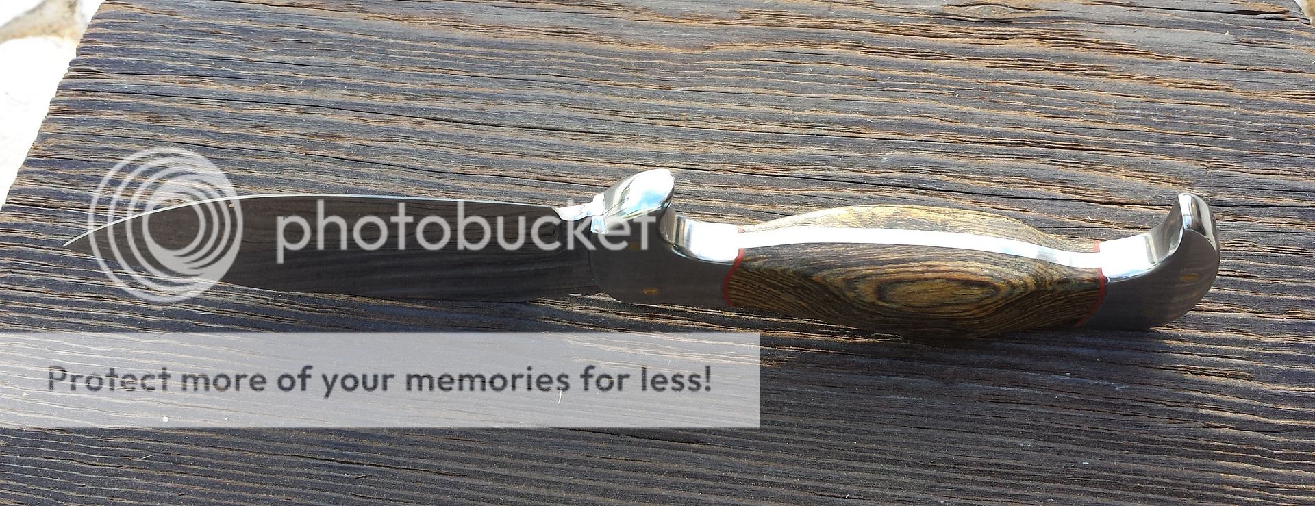

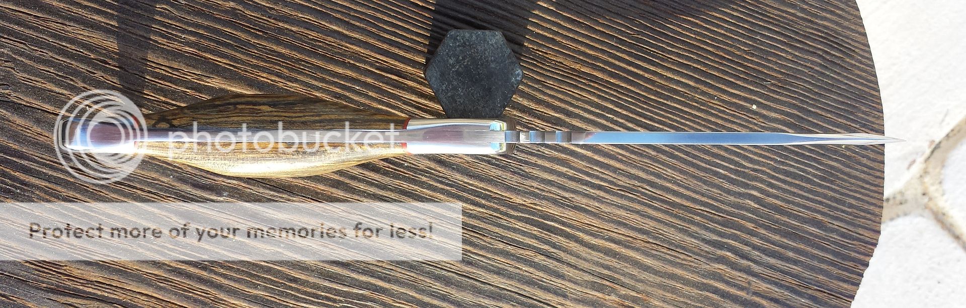

Hi All,

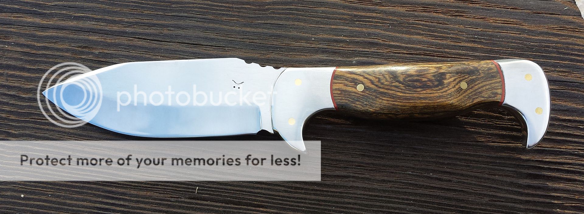

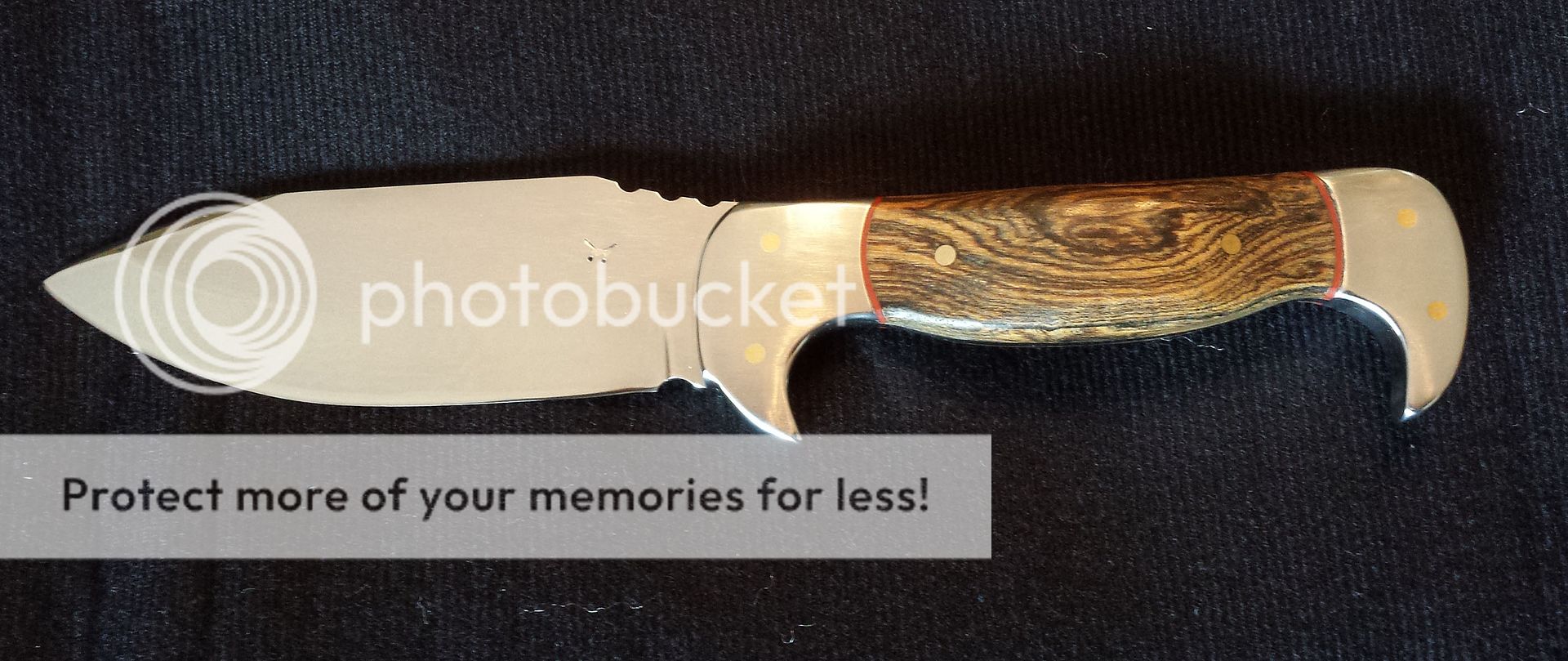

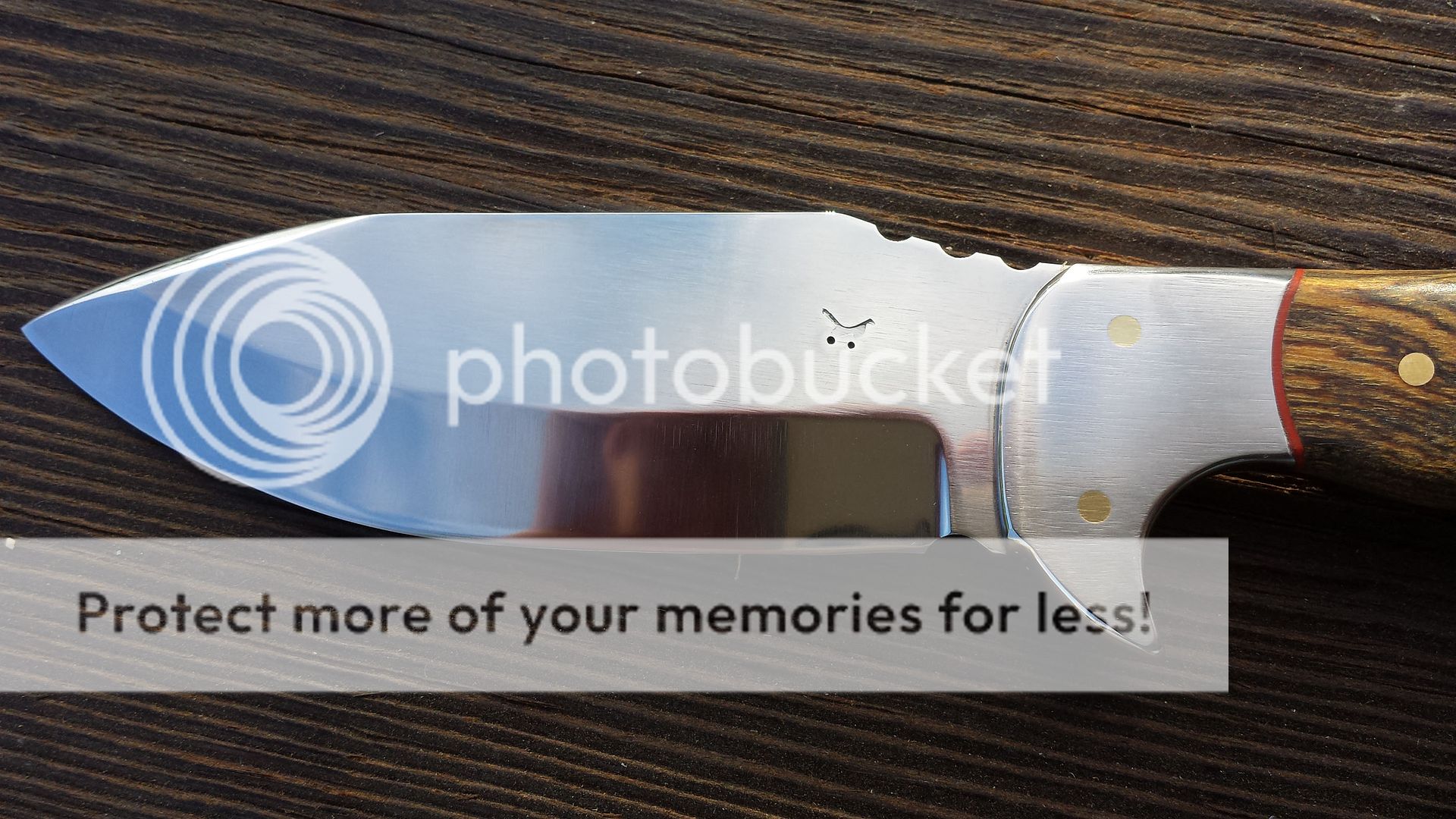

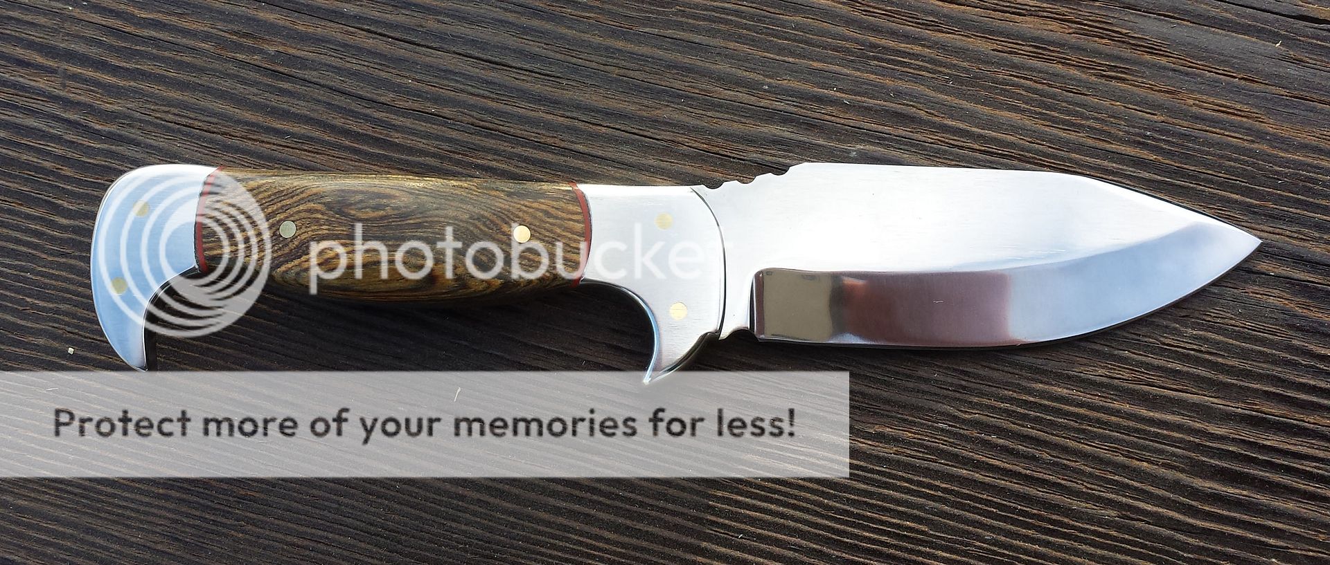

This is the most technicality challenging knife to date also probably my nicest. Its done in the old school fashion bolsters front and back with the scales between. This knife is entirely made from Aldo’s 154-CM that would be the central blade as well as the four bolsters. The wood scales are matching Bocote polished to a very high luster. Shaving sharp (I mean it) hardened and triple tempered to a very solid Rockwell 59. Red spacers and brass pins finish it off. A special knife done slowly with a lot of care.
The Specifics:
Material- All steel is 3/16ths 154-CM
Hardness- Rockwell 59
Over All length- 9.25 inches
Blade length to the bolster- 4.5 inches and is hollow ground on a 10 inch wheel
Blade at it’s widest- 1.5 inches
Handle thickness at the bolsters 3/8 inch
Handle thickness at the center- 7/8ths height is 1 inch very firm in the hand

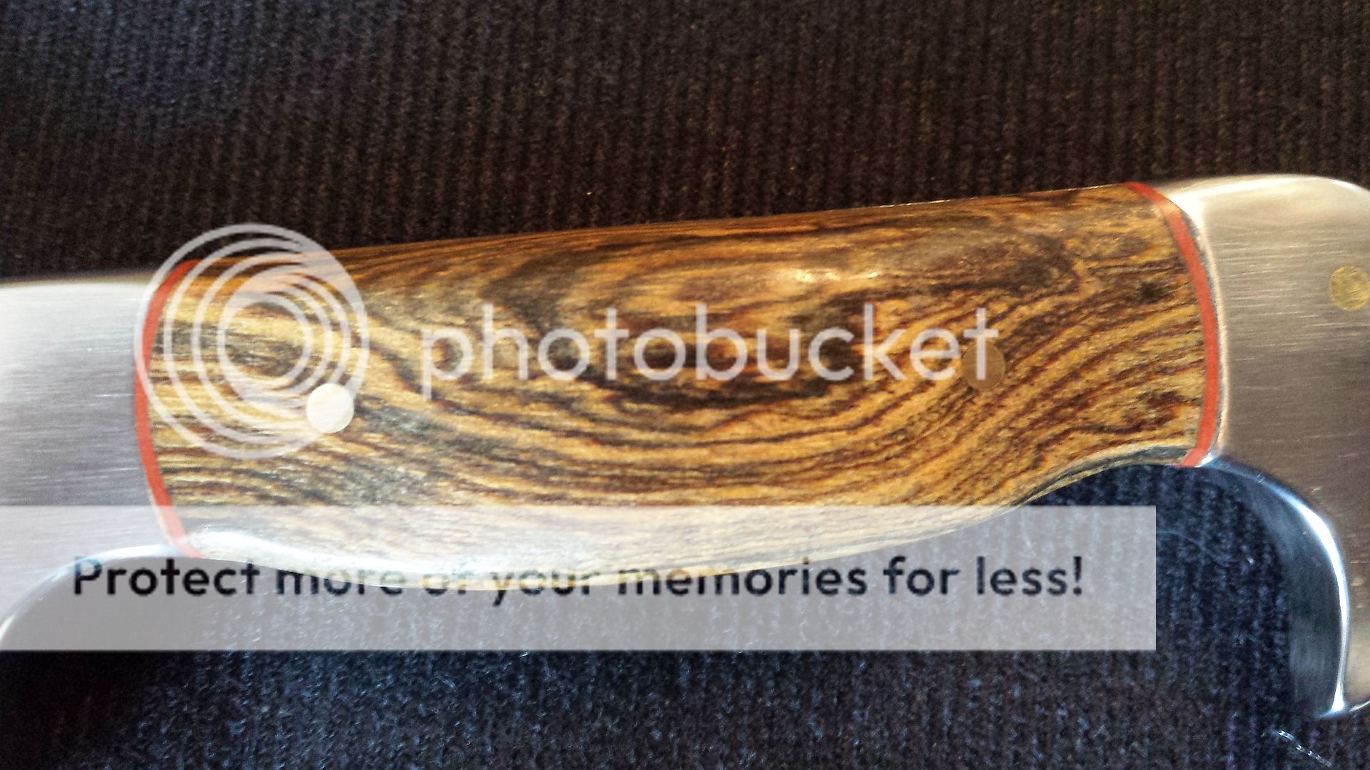

Scales- Matched Bocote polish to a high luster
File work on the spine for your thumb to rest on if need be
6 1/8th inch brass pins and 2 red fiber spacers compleat it.
Weight- 8.6 ounces

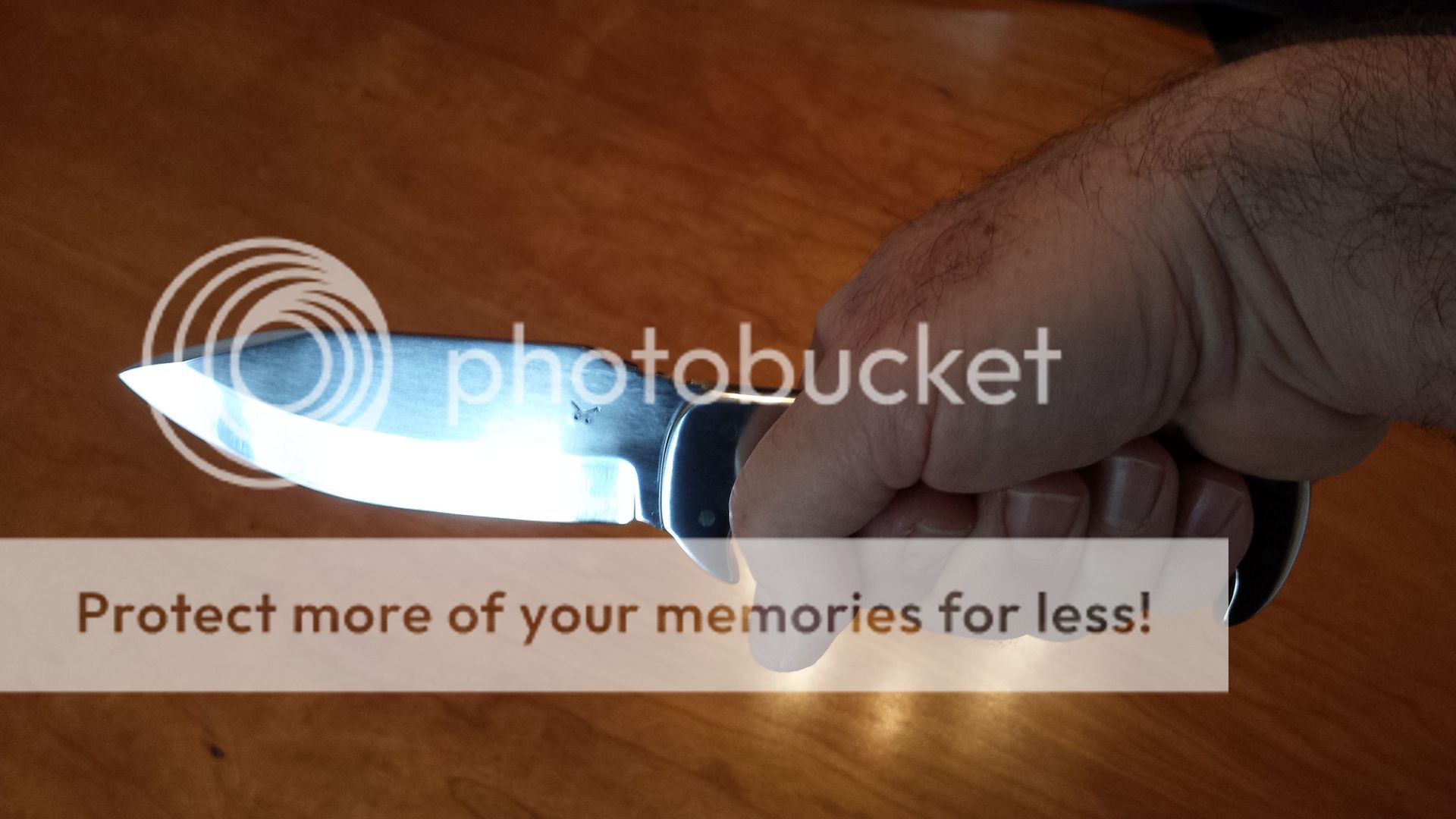

I have a medium to large hand and there is still room between the hand guards (bolsters).
This is a really really nice knife a true Hunter/Fighter
Price is $245.00 plus $7.50 for USPS priority shipping. If you want a Kydex belt sheath add another $25.00 you wont be disappointed. Otherwise it’s up to you.
Enjoy the pictures comments are always welcome.
