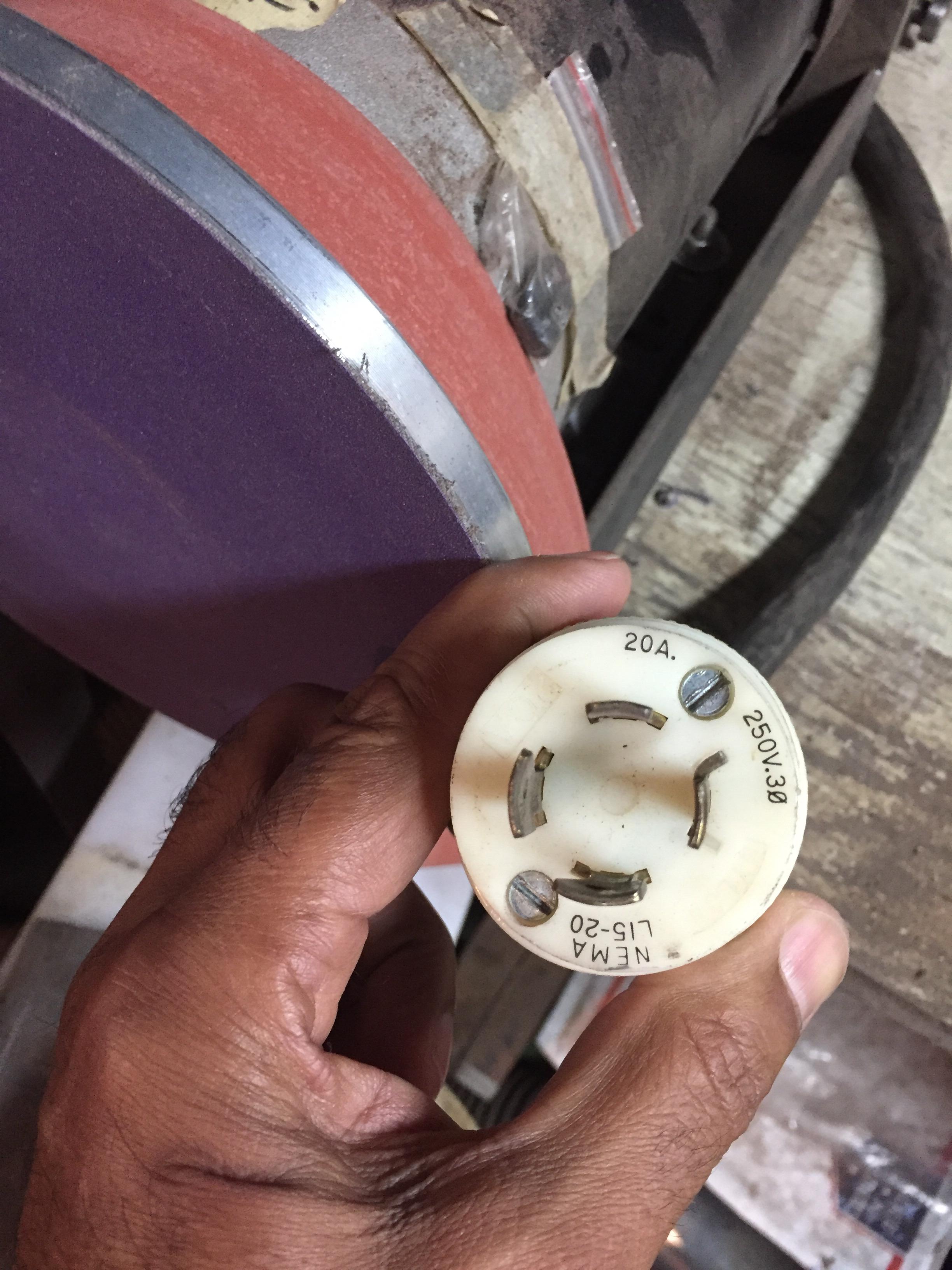

Hey guys, sorry to be asking so many questions. I talked to H HSC /// and he suggested i use 4 wire twist lock plugs so i can use my grinder and disc off the same VFD. ive bee nreading about them, but im still a little confused.
I read through this thread http://www.bladeforums.com/threads/advice-for-setting-up-vfd-wiring.1492591/
But here is my understanding so far.
I would get 1 male https://www.mcmaster.com/#7164k46/=17mxoo6 and wire it into the end of the out cable on my VFD.
I would get 2 female and wire one into each motor, one for the belt one for the disc and would use that to switch between the two.
Anything im missing?
That is how I have mine wired, for the disc grinder, I have two sets of plugs - one for forward, and one for reverse.
I think you have one thing backwards though. You want the female on the vfd and the male plugs coming out of the motors. Otherwise if you accidentally have the vfd powered up you could get electrocuted if you have a male plug coming out of the vfd that has live power and nothing hooked to it.

As for the forward/reverse - if you have the VFD wired up to the motor, and switch any pair of the U,V,W wires - it will go in reverse

Your description seems as if this is connecting your VFD to motor ??
If so, please dont !!
To connect 3phase motor to VFD,
Use an appropriate 4 wire plug & receptacle. Such as the NEMA L15-20 referenced prior.
This NEMA 6-20p from Amazon is only suitable for single phase 20amp 240vac. Such as what may connect your VFD to mainspower.
Yes, they are 'different'.
Each wire represents one of the three phases of the VFD output.
(Or three phases of the motor input)
Without 'tech documents for the VFD, the only way to tell them apart needs a phase sequence detector. But for the purpose of connecting a beltgrinder, its not important.
Assuming your motor is configured to match the VFD output voltage, It really wont matter what sequence they connect to the 3 wires which exit the motor. The only thing happens if they are connected "wrong", the motor spins opposite direction than what you wanted.
To change direction, reverse connections on any two of the three wires. It wont matter which two.
Or,, if VFD has reverse feature, just flip 'fwd-'rev switch !!
(Obviously, the "equipment ground" fourth wire is a separate topic...)
Btw, I mention "for the purpose of a grinder". Its not critical if its hooked up by trial & error. If its done backwards, simply change it.
But some machines cant be accidently started in reverse. Rotation must be known and connected correctly before switching on.

I would use a female wired to VFD and males to motor. typically the source is female, user is male. think your house, the wall has female receptacles, your appliances have male plugs

I agree with the plug choice.
Female from the VFD, ,not male - supplying power just like the wall
Males for the motor, just like plugging a toaster into the wall
They do it that way so you can't lick the live power.
Ground wire to the ground pin, the other three wires to the other three pins - no special order
Install the switch to reverse, it's cheap, simple and handy.

male plug from your motors
I use 30amp dryer outlet male plugs ($8) and female outlet ($12) versus the twist locs that are about $40 each. Below is my set-up:
