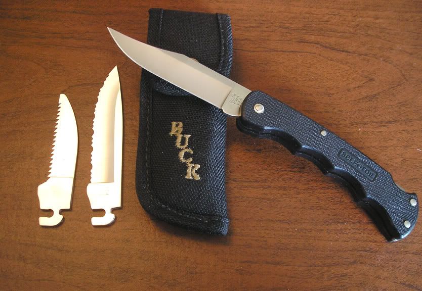

Does anyone use their Selector, 428 or 429? If so, do you like it? I just got 1, UPS guy dropped it with the Mrs., she brought it downstairs just shaking her head:D

You will like it.....READ the instructions.....this is the only Buck knife I have
sent in for repairs.....I kept the release held down while trying to remove the blade....the pin rotated from the pressure and the blade would not release.
get the skinning blade that resembles a 103.Makes cleaning a lot easier.

Scott - It took me a couple days to figure out how Buck did it...Can you post what angle the blade has to be at to extract the blade???
I'm sort of interested in modifying a 110 to the Selector configuration...It'll take a new stepped pivot pin (with milled flats), and I'll have to do some grinding with a thin disk for the extraction channel...

Is there a reason why the nail nick is on the wrong side???
trax
they come off at 90 degrees or with the blade halfway open , fully depress the lock and they pull straight out the end

What is the difference between the 428 and 429??? :confused:
Buck made Stag selectors and probablly others than plastic.
428 is a two blade selector one of the blades is not removable and
is a clip point non locking.
429 is a single locking multi choice ,I believe there are 6 different blades.
Some of those blades have been showing up on ebay.. A two pack I think..
