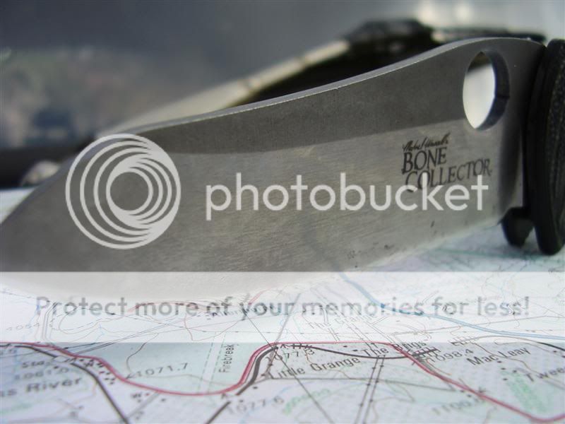

I have a D2 Bone Collector with a 10 degree per side (20 degrees inclusive) edge. No chipping issues and I use it from food prep to cutting irrigation pipe.
No issues.
