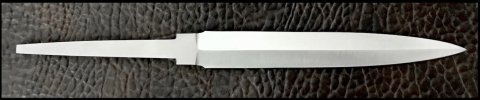

5" long x1 3/8" wide x 1/4" thick 5160 double edge blade. Right now I'm thinking this is going to end up as a boot knife with a Scagel style hand but it could end up being a push dagger as well. My thought is right now that it might be a little on the heavy side for a push dagger.
Any suggestions or ideas?

Love both ideas, but I think the width of the blade speaks push dagger a little louder to me than boot knife. I'm sure it will be awesome either way!
shouldn't the second pic be the push knife pattern?
That said, I think that size translates better to boot that push.
Yes, I goofed up when I posted it, I'll get it fixed.lol
I think the 1/4" stock is a little too heavy for either, 3/16" would probable be better, but a customer wanted a custom Bowie out of this steel so the left over steel is get turned into random ideas. The steel is reasonably priced so I can play around with it a little bit.lol

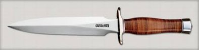

What do you all think?
The Gerber Mark I and Mark II are a couple of my favorite blades ever.
Your design looks very similar to the Mark I.
With a Hanson handle it will be irresistable.

This blade has only got the rough ground bevels done it still needs to be profiled. Right now it's 9" long and 1 1/4" wide and a 1/4" thick, and kind of resembles a double edge planer blade with a point on the end because it's edges are parallel 2/3 of the way to point. The red lines are going to be the finished dimensions. The German dress dagger is for comparison, it'a about 10" long and really thin and narrow about 3/4" wide and about 1/8" thick.
Got out to the shop and finish profiling the dagger blade. I let the ricasso area a bit longer so overall length is 9 3/16", Width is 1 1/4" and thickness is 1/4", I also left the termination areas of the choils a little bit proud so they a little bit of a flare to them. Once I figure out what I want to do for a handle I will most likely take the ricasso down 3/16" stamp the tang and ready for heat treating.IMG_4688.jpeg
