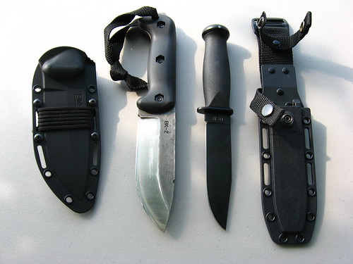

Not mine, but a shot of a MK1 and a BK2 for size comparison.
