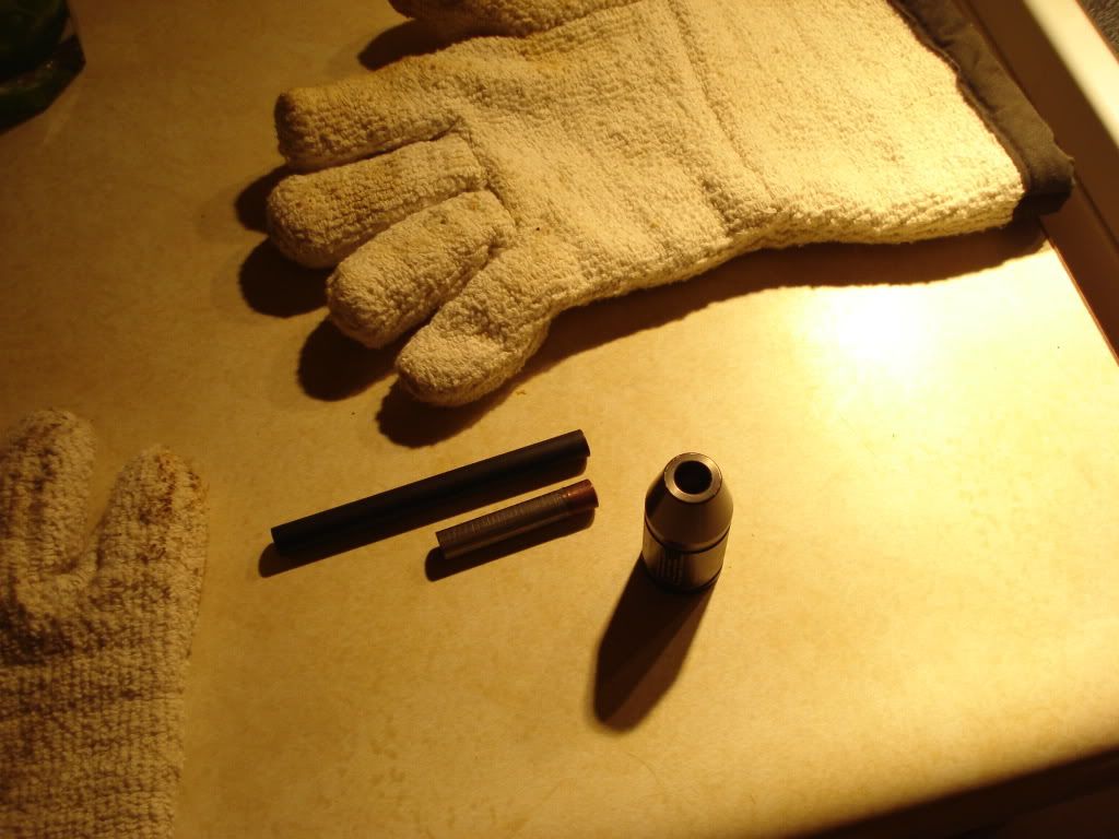

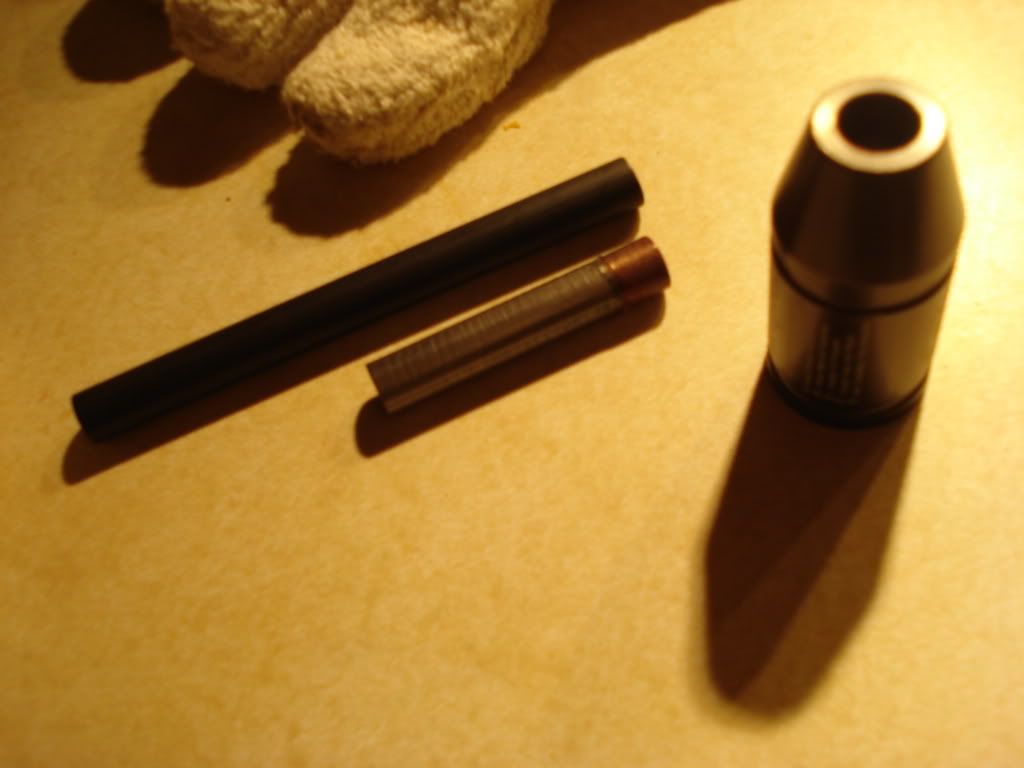

is that a 4" rod? It looks huge in the pic.
nice job!!!!

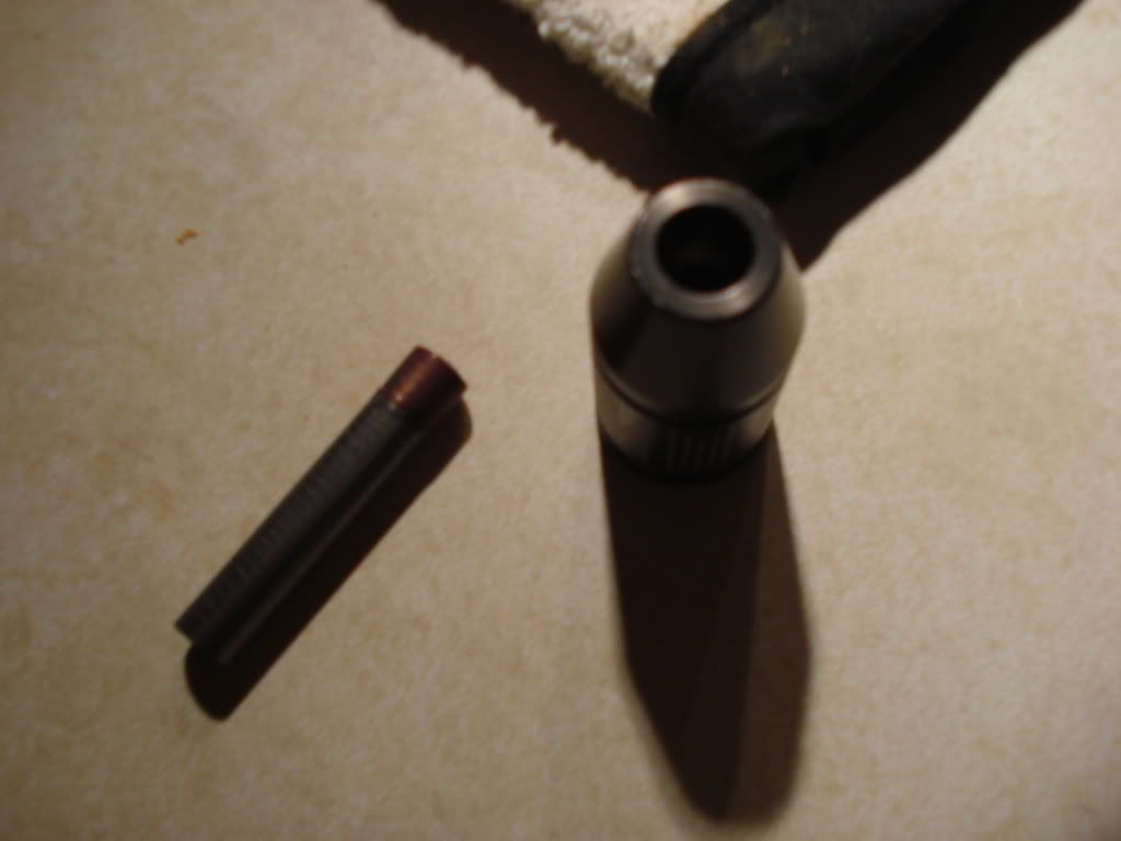

5 min 400 degrees in the oven and it sliped out no problem...

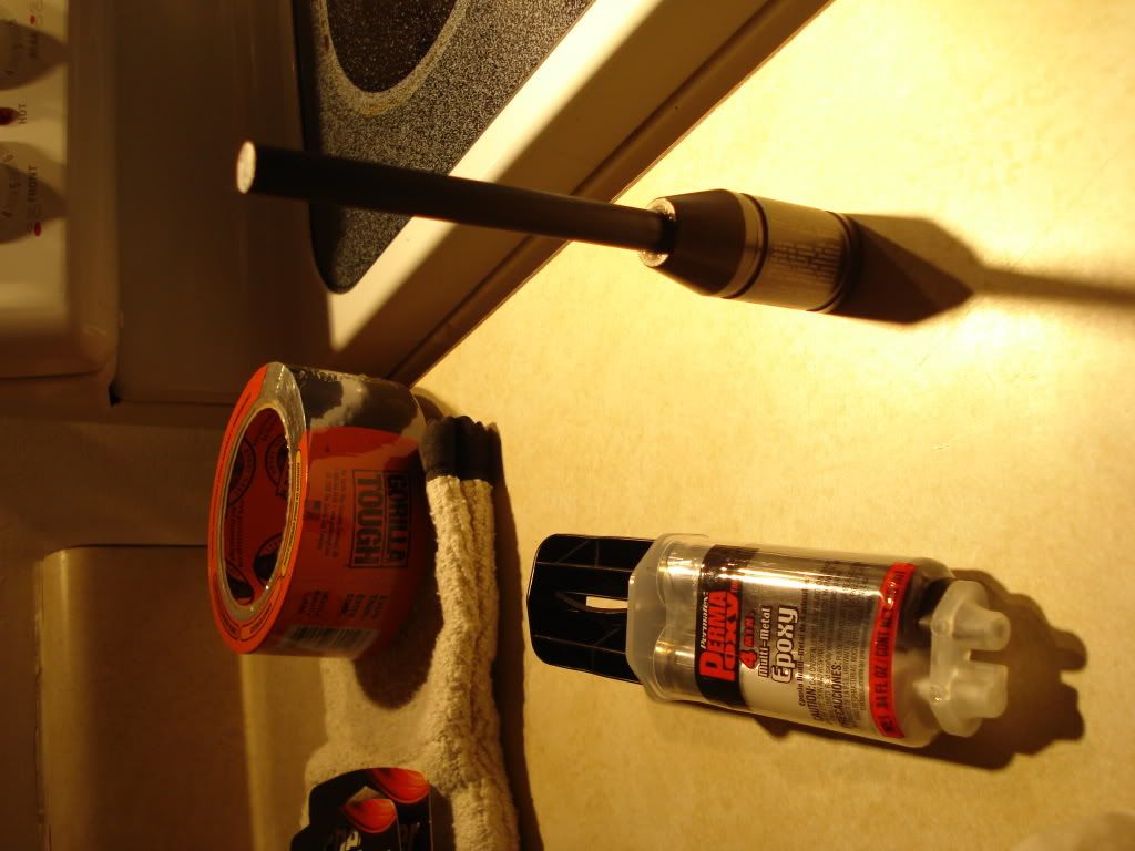

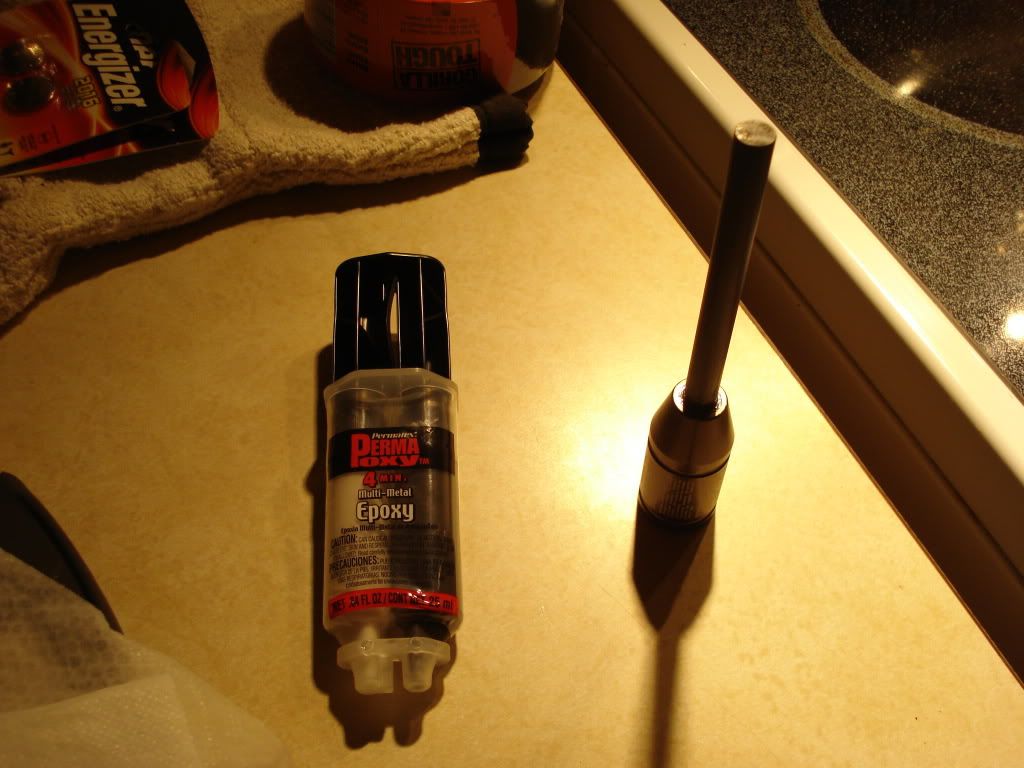

A little epoxy and... Perfect!
That last photo is awesome. How did you get your entire kitchen epoxied to the wall? Cool.

Great job! I just hit it out with a hammer...hah! I replaced mine with a 4" misch metal rod from goinggear.com
