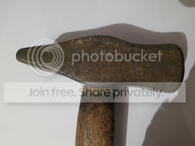

Picked up a 1,5kg Tor hammer a while ago and decided to put a finish on it. I've done a bunch of hammer restorations an have perfected a method with a flawless result and very little work.

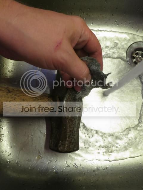

Clean of surface rust with soap, water and steel wool.

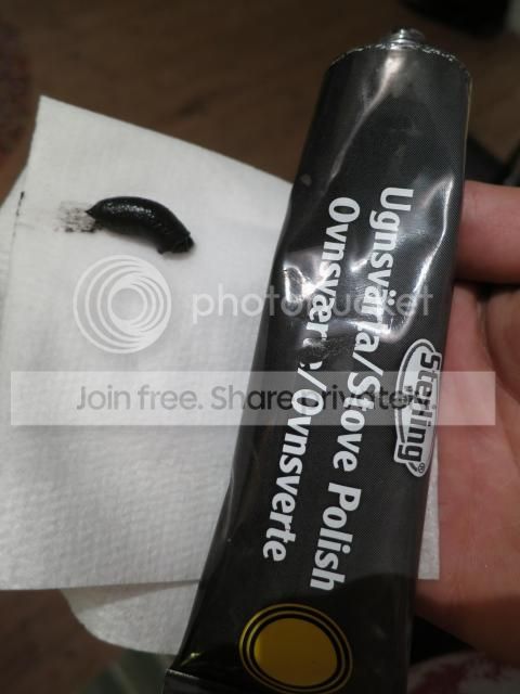

Stove polish on a wet "thick" paper napkin.

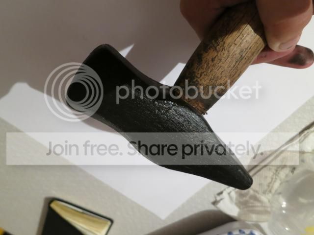

Its on.

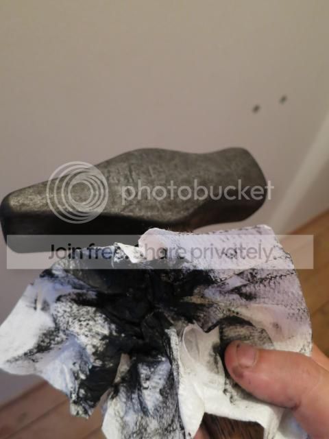

Wipe of dry

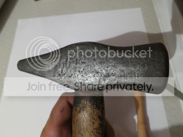

Done in less than five minutes and looking great :)
Stove polish, also known as stove black, is good for a dark patina on decorative iron forgings and also on tools.
