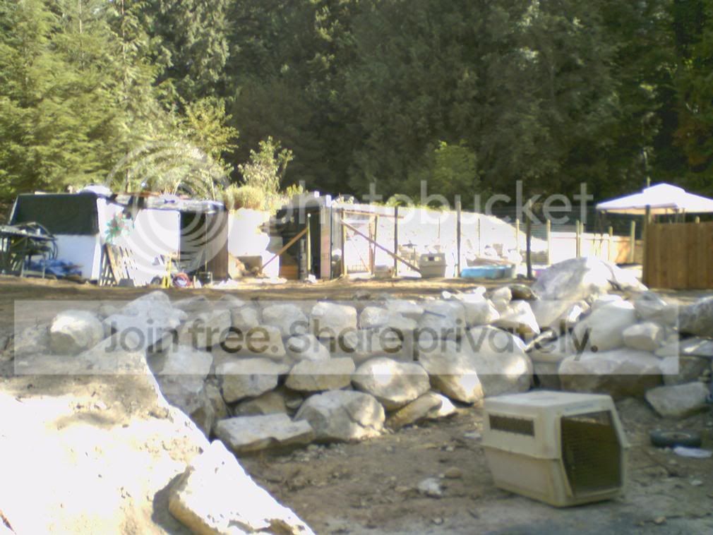

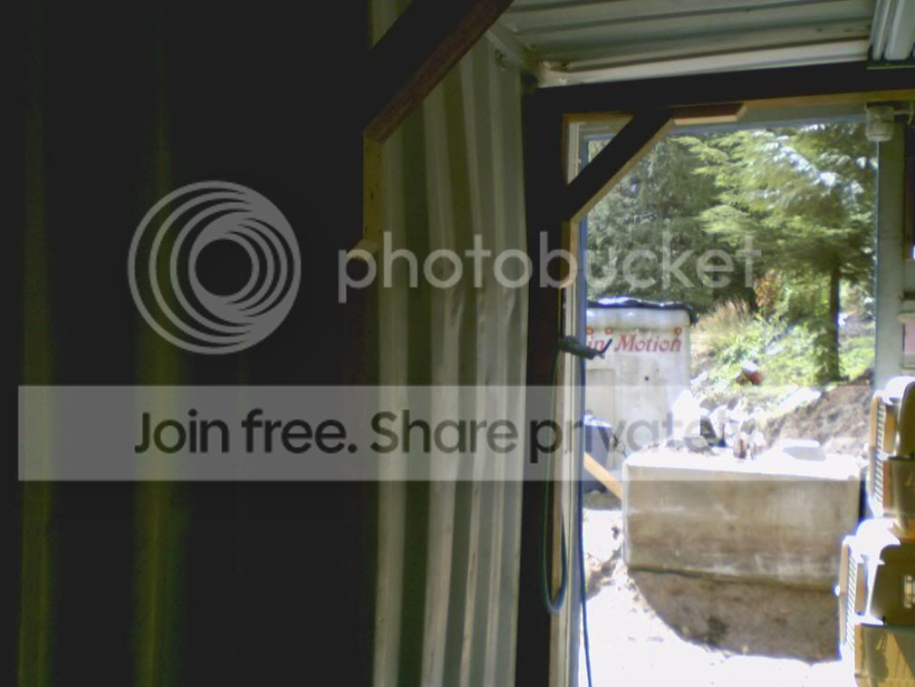

Excuse my camera, it's a phone too, lol.
^The black 'wall' in the center is the opening end of a 40' container (the black is damproofing) The two silver things are an air intake and an exhaust vent.

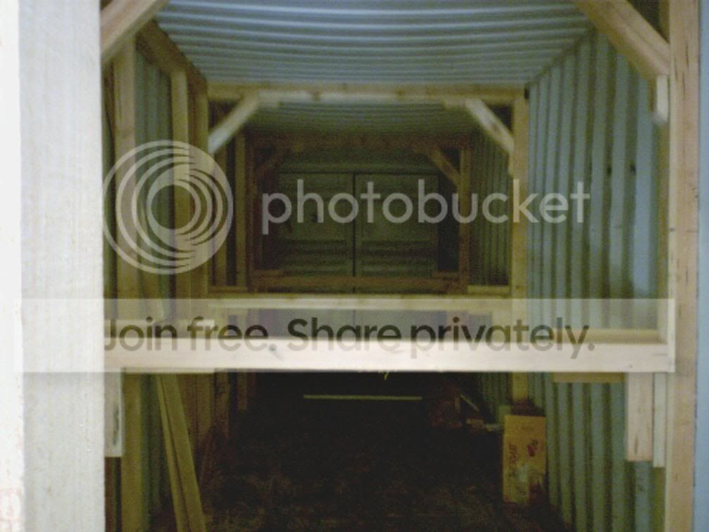

^This is the interior framing. You can see a bit of the deformation but the next pic shows it much better.
^Funny story about this happened. The container had been placed and levelled and following my days off was going to be framed. Well, the excavator arrived a day early and the boss had to get him working, so away they went and backfilled it. That is until the swamper looked inside and saw the sides bowing. It took a shoring jack and half a dozen shores just to get the roof high enough to drain.

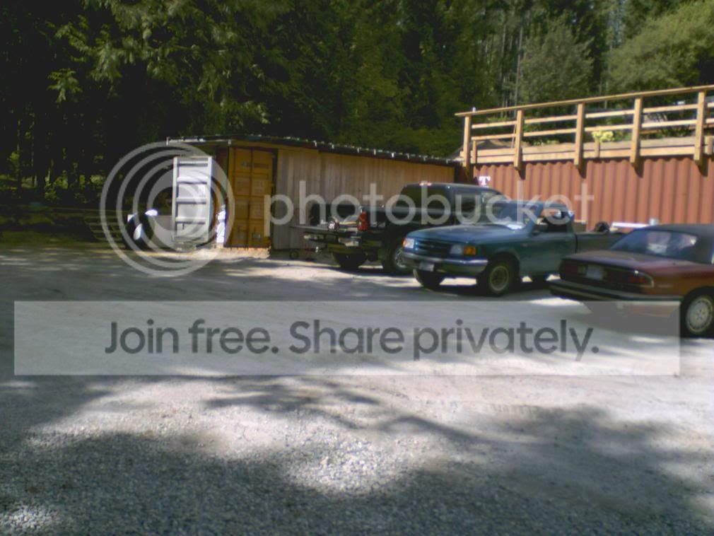

^These are the other ones. That's a 40' (red) and a 20' (wood panelled). The 40' is being framed with 5 individual rooms, each with an exterior door and an exhaust fan in the header.

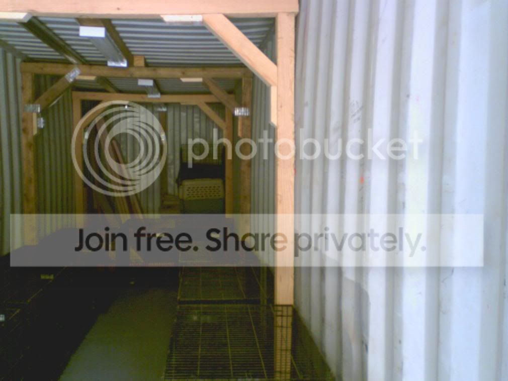

^This is how it looks when it's framed BEFORE being backfilled (the right way to do it, lol). The left side is framed with a 2X6 wall with the door openings framed in but not yet cut out of the steel. It's the (red) wall in the other pic.
I put a 40 amp subpanel in each one to run flourescent lights, outlets, and 110V ceramic heaters if need be. The red one with the 5 'rooms' is going to have a ~2" concrete slab with radiant heat. Both have a 3/4" water line fed to a hosebib for cleaning and filling water bowls. The first one has floor drains and the red one will drain out the doors.
Not sure what else might be relevant, so I'll try to answer questions instead. An interesting sidenote, the floors in these things are a 1" plywood that looks most like Ipe I'd say but man is this stuff ever tough. While cutting the floor drains (5 - 5" holes w/jigsaw) it felt almost like aluminum. I kept one of the rounds to rip into handle scales - the plies alternate between light and dark, so I'm thinking it might look cool after contouring.
