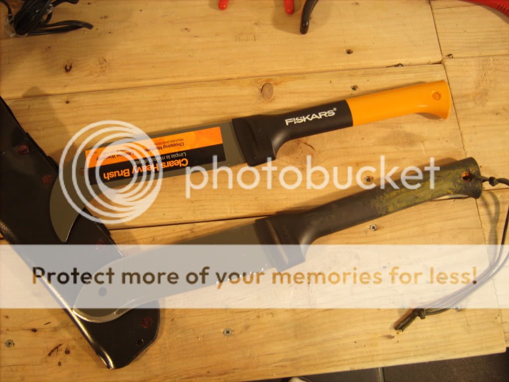

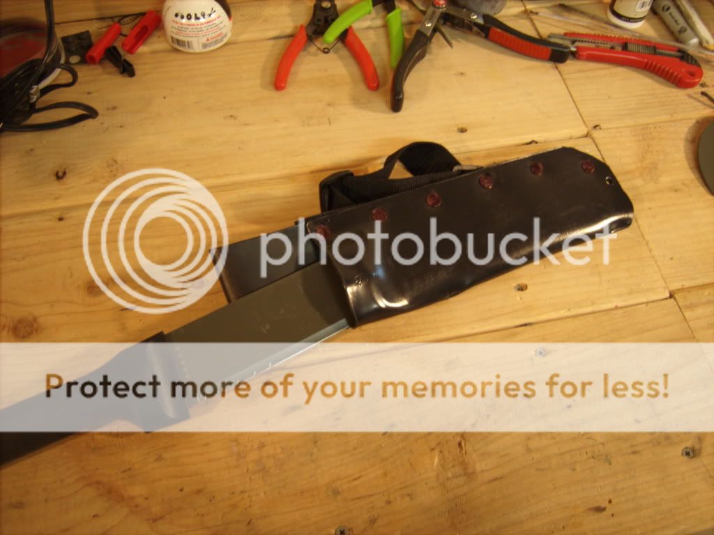

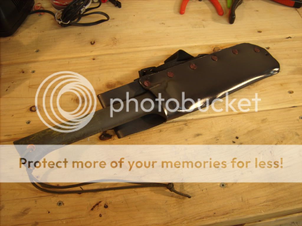

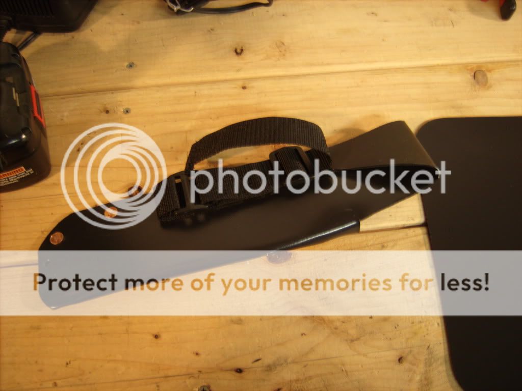

Here's an option - Get a Fiskars/Gerber brushhook and mod it like this:
Those are being sold locally at Walmart with the Fiskars brand and color scheme for a very reasonable $20. Really useful around the yard. Never really thought about modding one. Has potential in that dept.

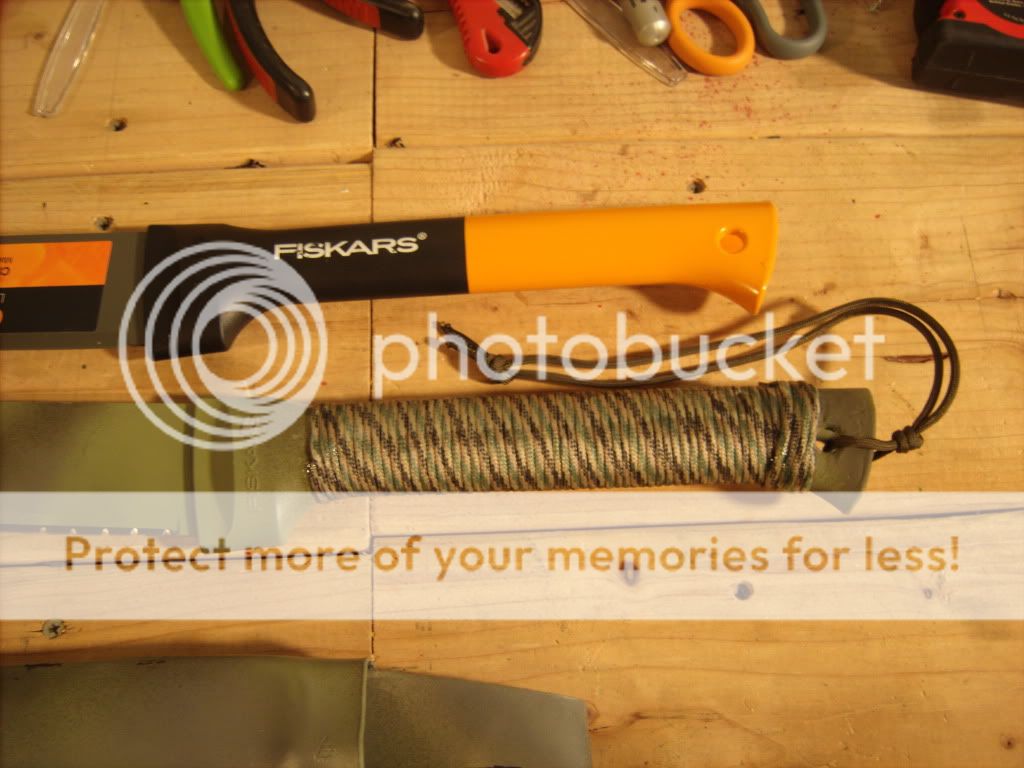

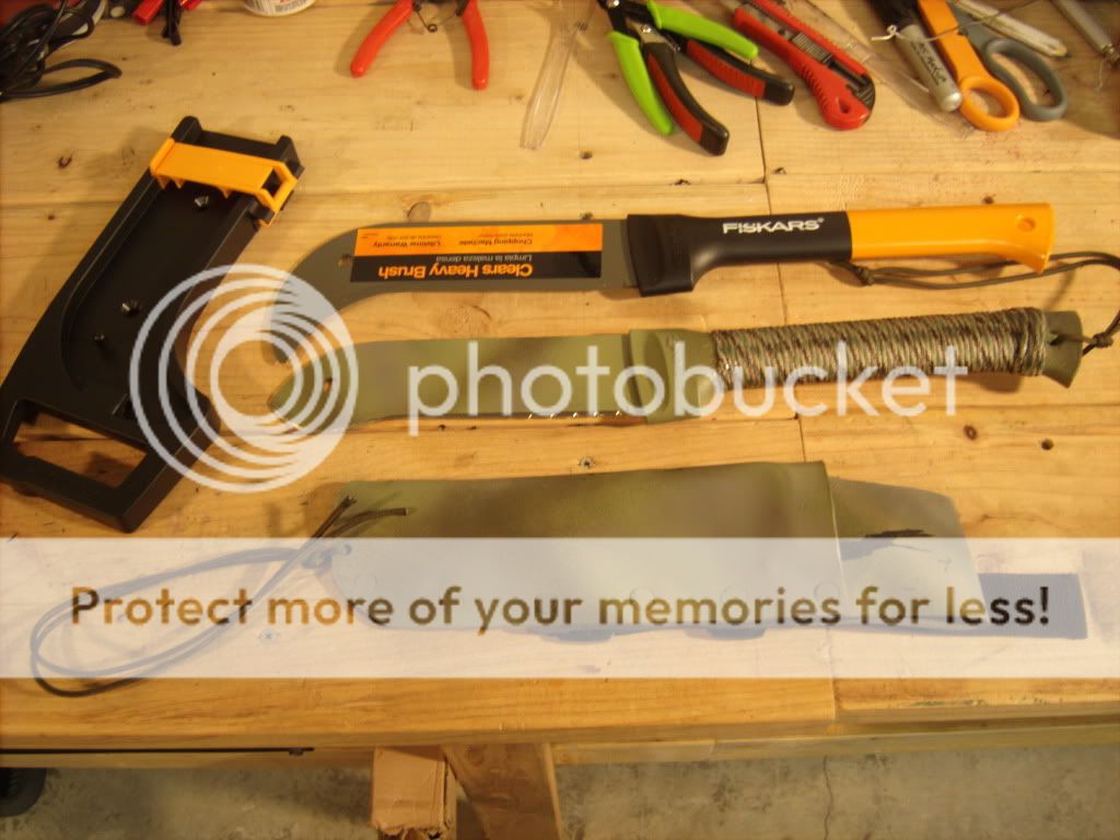

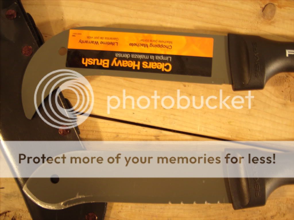

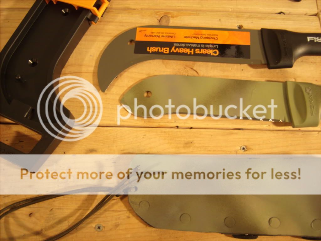

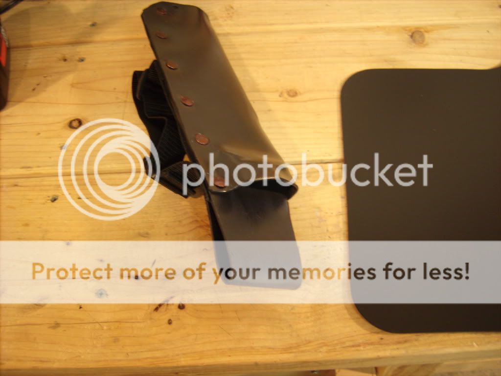

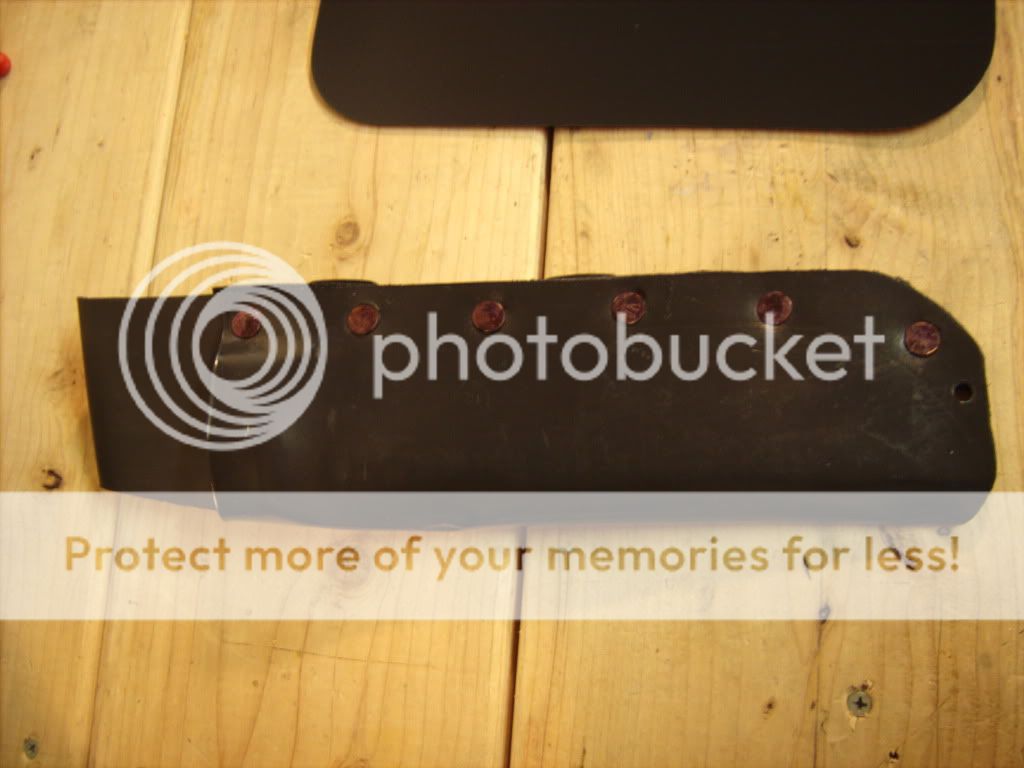

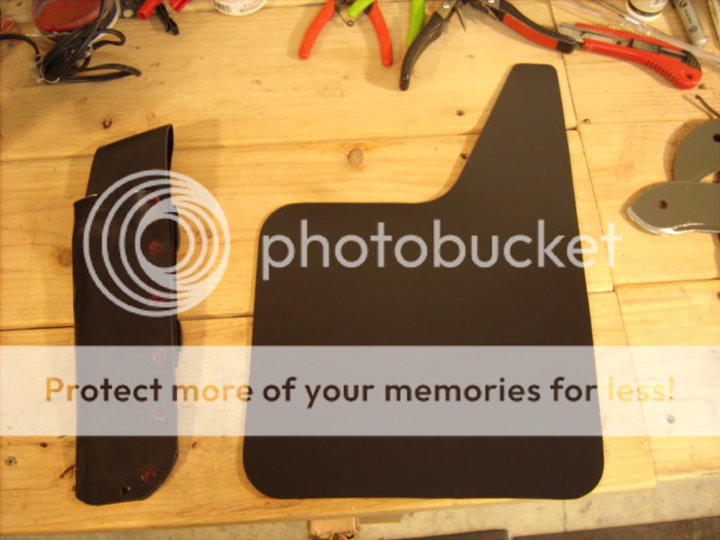

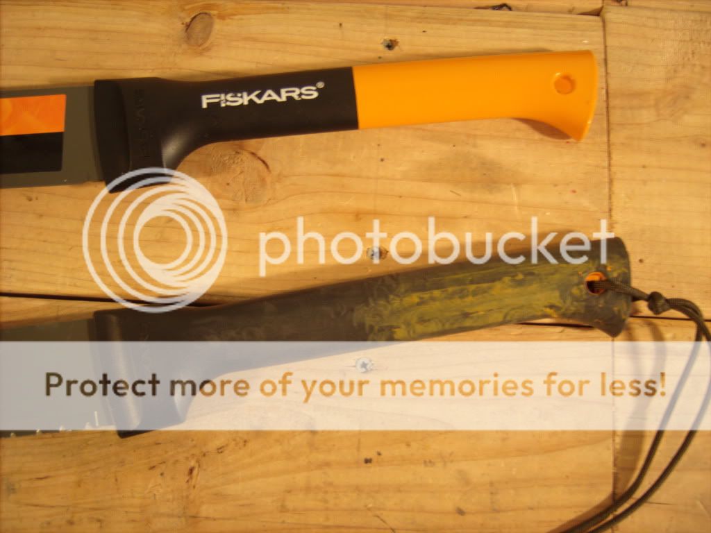

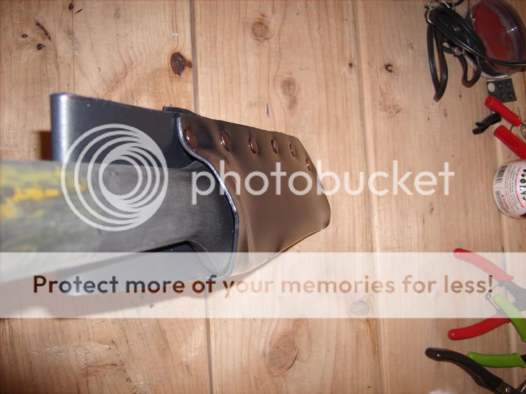

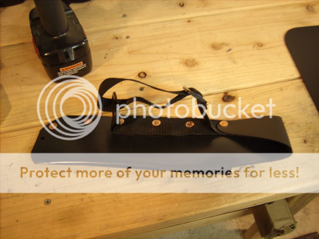

I took Andrew's idea and went a little different dirrection with it. I wanted a tip that I could potentially skin with, and left the longer handle for more power. I made a sheath from a thin mud guard I had on hand. I camo'd everything, and then did a cord wrap, adding a bunch of super glue ( per email info from Andrew) in multiple passes along the leng of the handle after the wrap was done. Also super glued the ends to about 5 wraps back. That should hold it! I doubled up the cord on the end of the handle to give a more positive stop for my hand. I've tested it, what a beast. The paint will wear off the coated blade, and sheath, but these type of handles hold the krylon well. It still works with the factory holder as well. The second one will get the blade cut/ sharpened in the same fasion when I get the chance. I will initially leave it the factory colors and add a black cord wrap for better grip.
