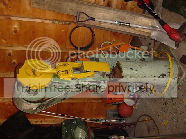

Hi
thanks... i did pick it up... its a barbour stockwell u-50-1
its suppose to be similar to a beaudry.. and yes they were made in 6 sizes from 50 to 500lbs.. as it says on the fine print on this site..;)
http://www.littlegianthammer.com/beaudry.html
here's a pic of it... hasn't been used in a longtime
Greg
