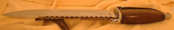

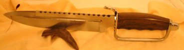

Well, I got to work on some of that 5160 everyone got their hands on. Here is the first piece I made.
Blade is 9 3/4" and 1 1/2" deep spine is near a full 1/4" to the tops false edge.
Spine work by tungsten burr in milling machine for uniformity/
Hardened with 10 min soak in electric oven at 1475f and quenched in oil. Double tempered to 400f for 2 hours each cycle.
Draw sanded with flat bar to 400 grit then buffed.
Guard and skull crusher nut of mild steel. File worked. Wood is Cocobolo.
Here is my question. I have all the stuff to do a hot blue. Should I blue this or leave it as is?

Very nice looking knife, it will look great whatever you do with the finish, but I think an overall hot-blueing would be rather cool. 47 Knuck
Yes That is some of your pile you spread far and wide. Seems to be some sweet steel. I got couple more in the works too. Thanks for the great deal.
Thanks for the interest. the polling votes and nice comments. I believe I will Blue the guard and nut and take a look at it that way. Then decide if I should hit the blade with the blue. Will post when I get that done. Probably going to finish putting handles on the other 2 blades I have going from this 5160 first. Seriously thinking of doing a sword using the same design as the knife above. Just make the blade longer and have more false edge on the top. Whats does everyone think.
