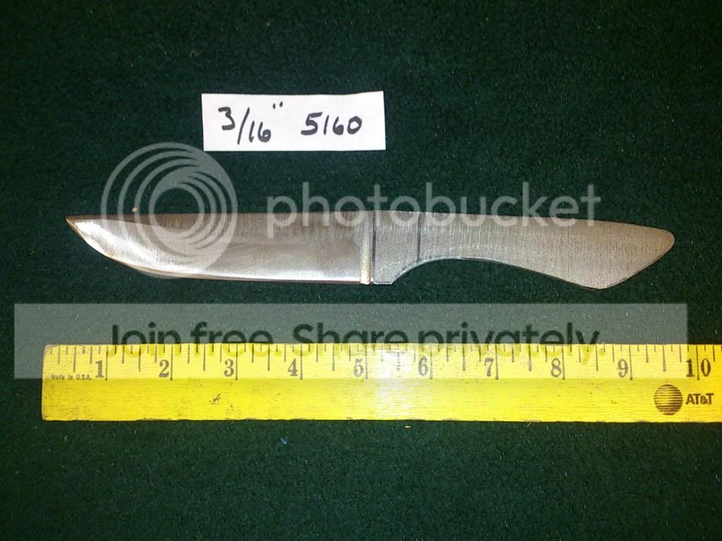

I am currently making this little guy out of 3/16" thick 5160.
It is kind of like a large bird & trout. I plan to use it as a camp knife. A real camp knife mind you, made to pack and be useful on a real camping trip like a week on the Appalachian Trail or Sheltowee Trace. The size and weight of most "camp/bushcraft" knives make them unrealistic for their named purpose. Pay little attention to the ugly grind lines, I'm experimenting with removing metal on my 4 x 36 belt sander then draw filing. I was working on the distal taper at the point in time of this photo. It will have a nice convex cross section when done. I think the 5160 will be a good choice for this kind of knife. It should be tough, important when far from civilization, and easy to sharpen in the field if need be.
