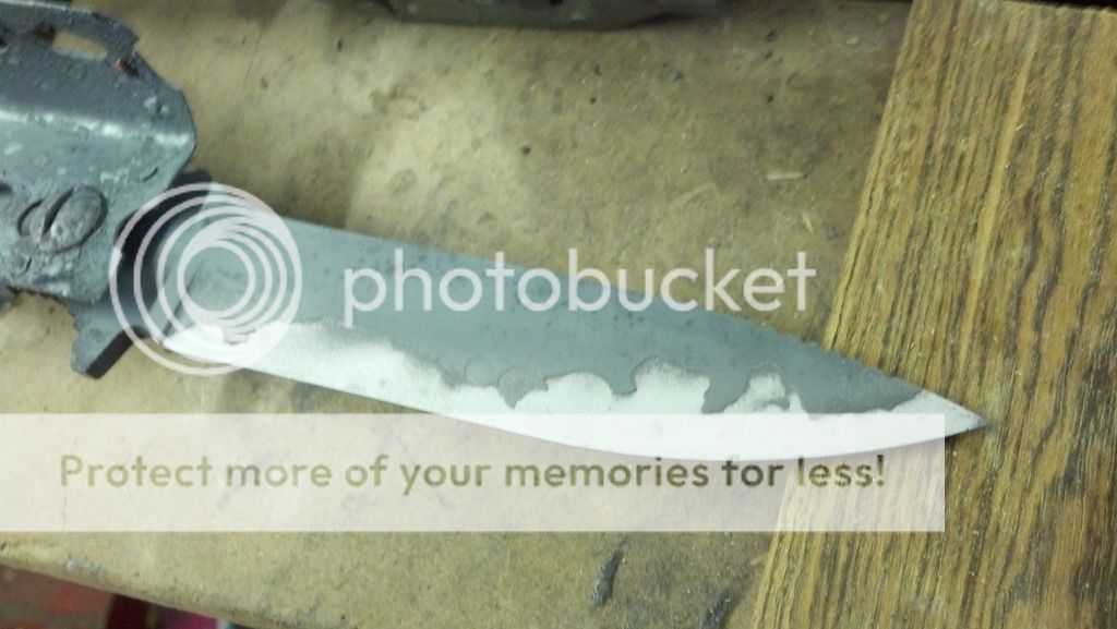

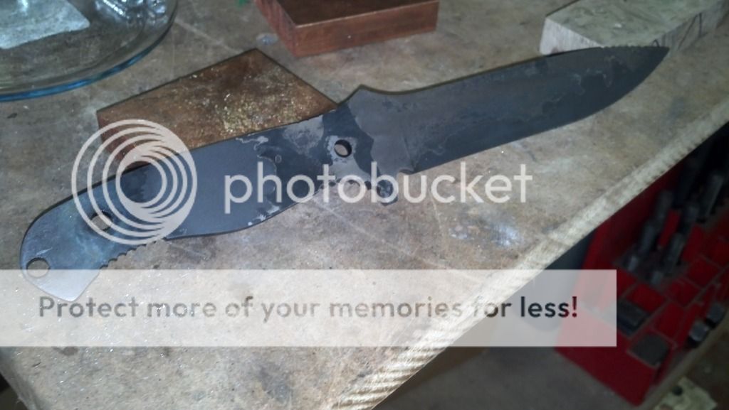

see how thick the build-up was?
after hardening:
hopefully if left a quasi-hamon. that would be cool.
