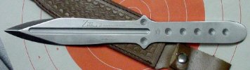

Maybe 10" long; 1/4" thick stock. Simple shape, is what I have in mind for these. Something like this, only even more basic(generic pic found on the internet)

Thanks, I was thinking about a slight drop point. Want to remove as little metal as possible while still making a decent looking profile.
