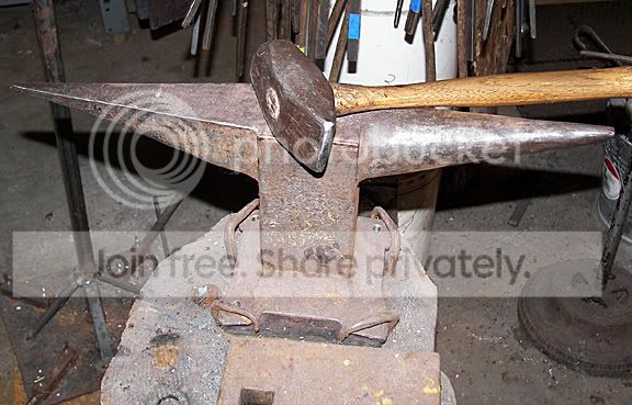

This is a 33# double horn anvil forged and arc welded from mild steel. it's purpose was for a light rendezvous anvil but it never saw much service. It is used in the shop once in a while, the tapered square horn especially. It is mild steel and was heated above non magnetic and quenched in cold water. it's never used for hard forging work, mainly finish work for knife springs or some small products in the past.
Thats my 2 1/2# hammer on top with thin machinist hickory handle. When I see blacksmith hammers with thick handles, it makes my elbow hurt, my doctor calls it blacksmith elbow, or tennis elbow in other sport.
Thanks, the square tapered horn is great for those small pieces that just can't be worked on a English style anvil.
