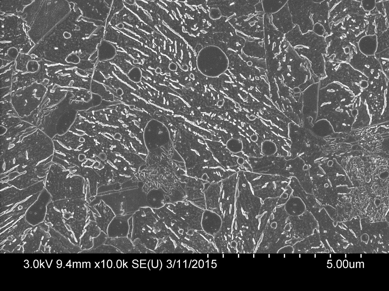

I'm still working through these images but this is my 52100 at 1500° F. I posted this in another forum which some of you may have already seen; couldn't hurt to show it here either. Prior thermal cycles included 1650°, 1500°, and 1400°. 15 minute soaks for all.
Don - Thanks for sharing:thumbup: I (Luong) replied to your thread on HF - http://www.hypefreeblades.com/forum/viewtopic.php?f=3&p=7095#p7095
Your x5.00K pic (http://i.imgur.com/b7objEr.jpg) clearly shows grain boundaries. Look like(eyeballing) it has aus-grain dia between 5-8um (astm size 12-11). RA 15-20%, ~3% martensite, bainite balance. Large aggregated cementites taken placed at grain boundary. So on... I envy SEM/TEM.
