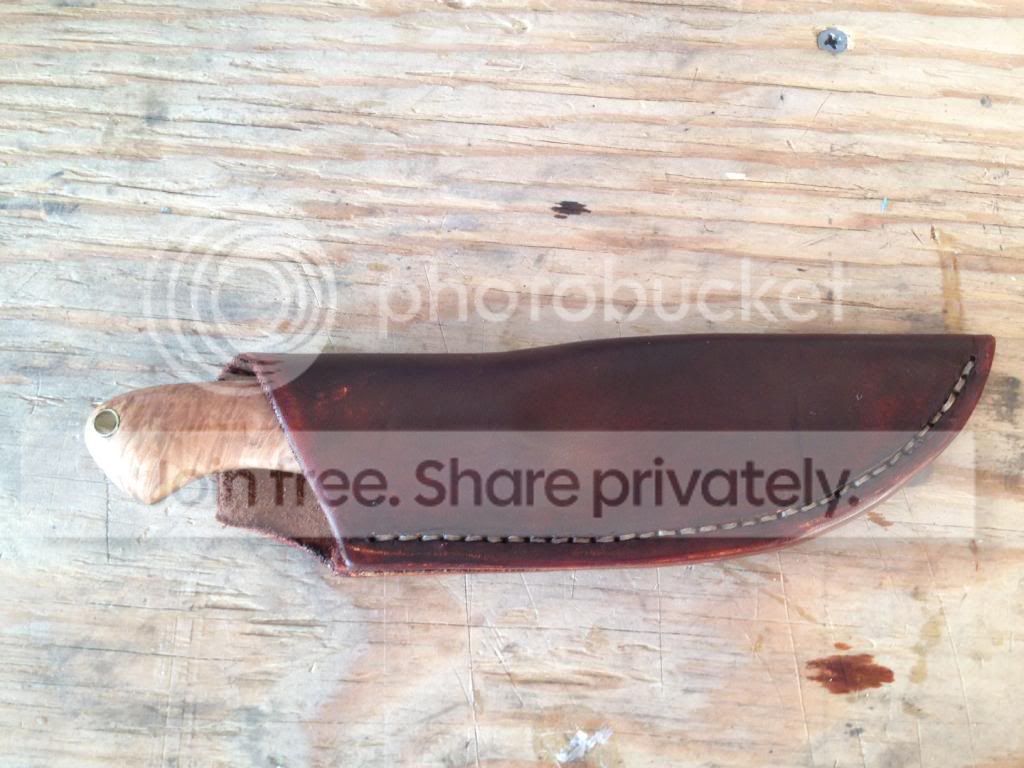

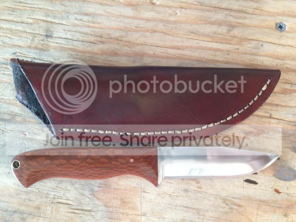

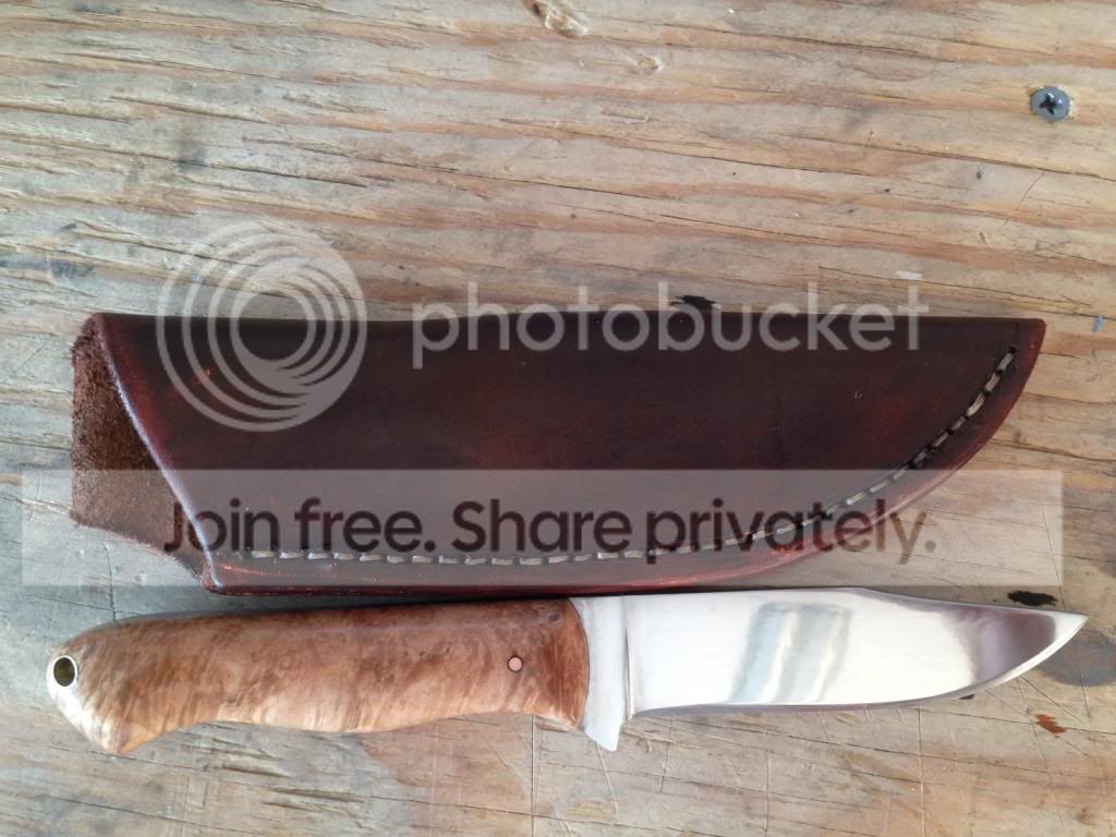

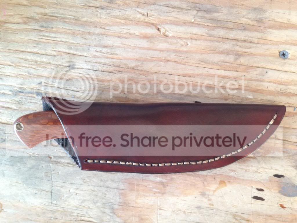

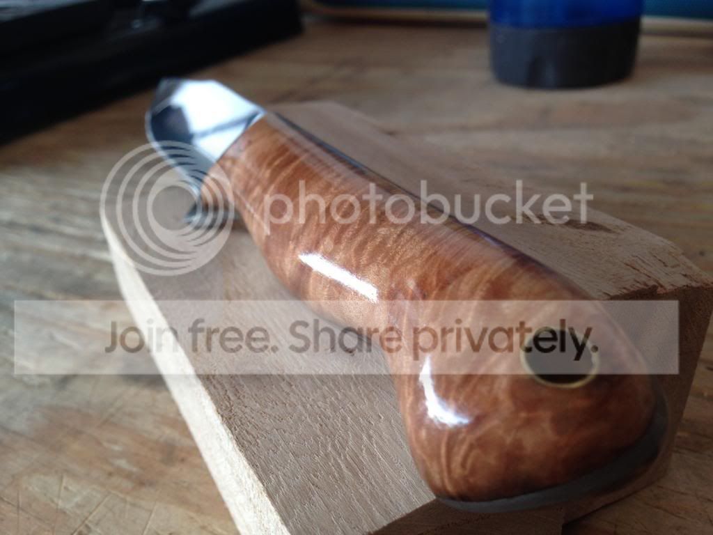

Just wanted to share two knives that I recently finished with everyone. They will be gifted to my father and father-in-law for Christmas. I also wanted to do leather sheaths for them as well and was pleased with the result. First time doing sheaths. Let me know what you guys think. Thanks for looking.
#5
Full flat grind, 1084, 1/8" thickness
8 1/2" OAL, 4" blade, 4 1/2" handle (quilted maple)

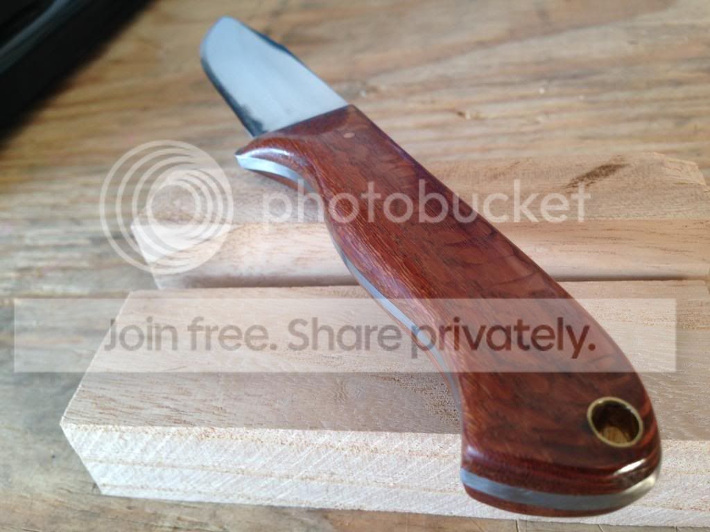

#6
8 1/2" OAL, 4" blade, 4 1/2" handle (snakewood)
Those look very handy! I'm sure he will be happy with those. Good looking sheath work too!
Thanks, Josh and Hengelo.
Hengelo - To get the maple looking the way it does, I hand sanded to 500 grit, and used tung oil. I put on about 6 coats (apply, let dry, lightly rub with 0000 steel wool to remove any tackiness, reapply, etc...).
