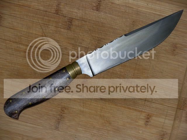

My #6 with Rawhide sheath & 1st sale

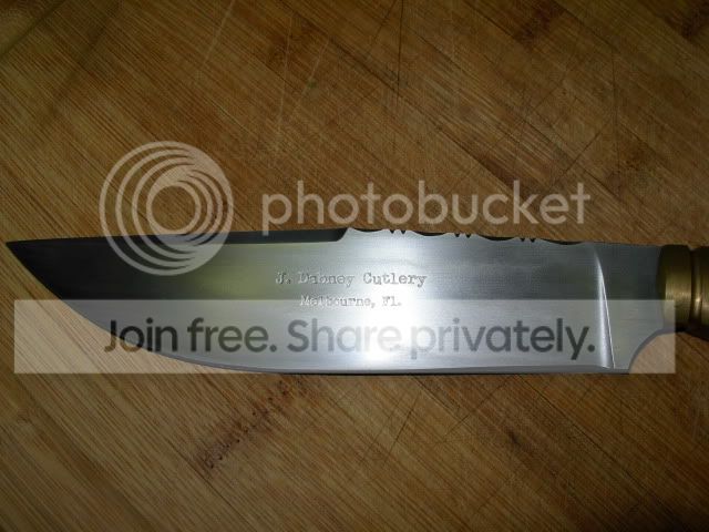

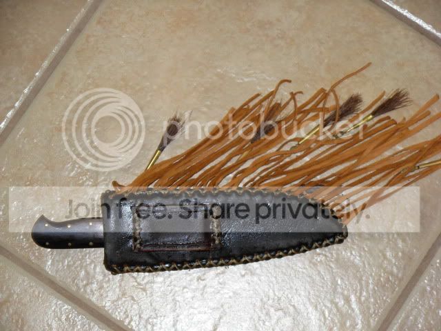

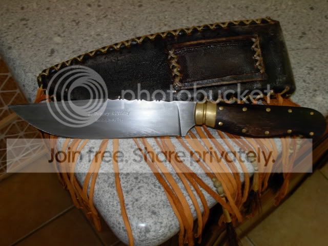

Here's my 6th knife completed. It was designed to specifically target folks into Cowboy Action Shooting. I designed and made my first rawhide sheath at the request of the customer and just finished it up.
As always critiques, critisizms, and comments are welcomed, encouraged, and appreciated.

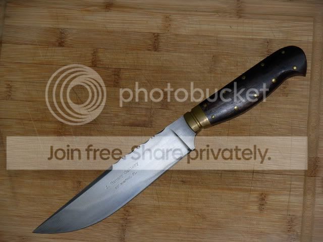

Specs- 6" cutting edge, 11 7/8" OAL
-1080 steel, edge quenched. The darkest part of blade shows the first quech line which I wasn't satisfied with. It's hard to get a good pic but there is a second quench line that runs mid blade all the way through the ricasso.
-Home dyed cowbone scales
-Brass bolsters & pins
-Scrubbed the dark out of the makers mark but it is deep and crisp otherwise
-Tapered tang and distal taper
-False clip

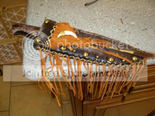

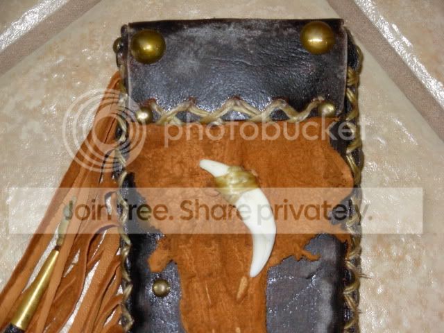

Sheath- Rawhide over veg-tan (saddle stitched) (Thanks John Cohea !)
-All antiqued brass hardware Tacks, Beads, Cones with horsehair)
More pics to follow...

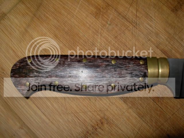

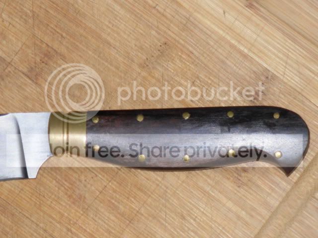

One thing if I may.... and this is purely a personal thing, the angle of the groove in the bolster distracts me. It could be the angle of the photograph, is it a matching angle to the plunge in relation to the spine? I dunno.... :confused: Does it take anything away? HECK NO!!! it's just something for me and only after staring at it for a looonnnnggg time!
GREAT GREAT JOB ON EVERYTHING!
69 knives, Thanks. I wanted to stick with something at least semi-"period correct" for the mid 1800's and I had these scales on hand. The white-ish areas just didn't seem to take the dye but instead of soaking I kinda liked the character of the color variation so I just went with it even though the white is much more pronounced on the one side.

I studied the pics for a bit and here's my GUESS as to whats going on. None of the pics are a true profile shot directly from the side. The back of the bolsters and filework are parallel and 90 degrees to the spine. The plunge angles toward the tip of the blade. The filework is also round in the bottom which may or may not make matters worse when the pic is angled from the front or back.

Josh: Very obviously you made your knife, it is an original and I enthusiastically congratulate you, it is obviously your dream and one that I can appreciate.
You learned a lot by etching your blade, it is only through the etch that the blade smith can see the results of his heat treat and with each one you learn a little more. Add the information you can see with some realistic testing and it comes together in a great package for the maker and client.
Ed,
I try to keep my mouth shut and ears open as much as possible, LOL. Although I didn't go through a railroad tie, I did sharpen this blade up after HT, put a paper towel and duct tape handle on it an do some cutting and the brass rod test. Obviously I didn't do a destruction test on this one but That is going to be in my near future as well.
After chopping on a Palm stump and chopping 80% through an oak 2x4 she was still shaving and took no edge damage.
Could be my newbie status but I was suprized and VERY pleased with it :D
Thanks also to Mace for telling me to test my blade right out of heat treat before finishing. Sound advice and a great feeling while finishing the knife to know it's gonna be a great knife for someone.
