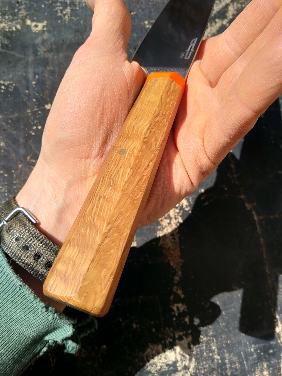

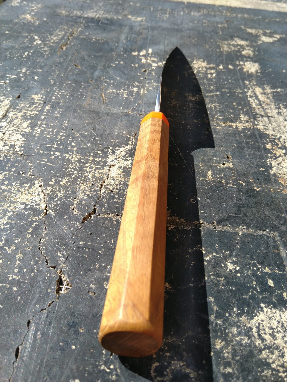

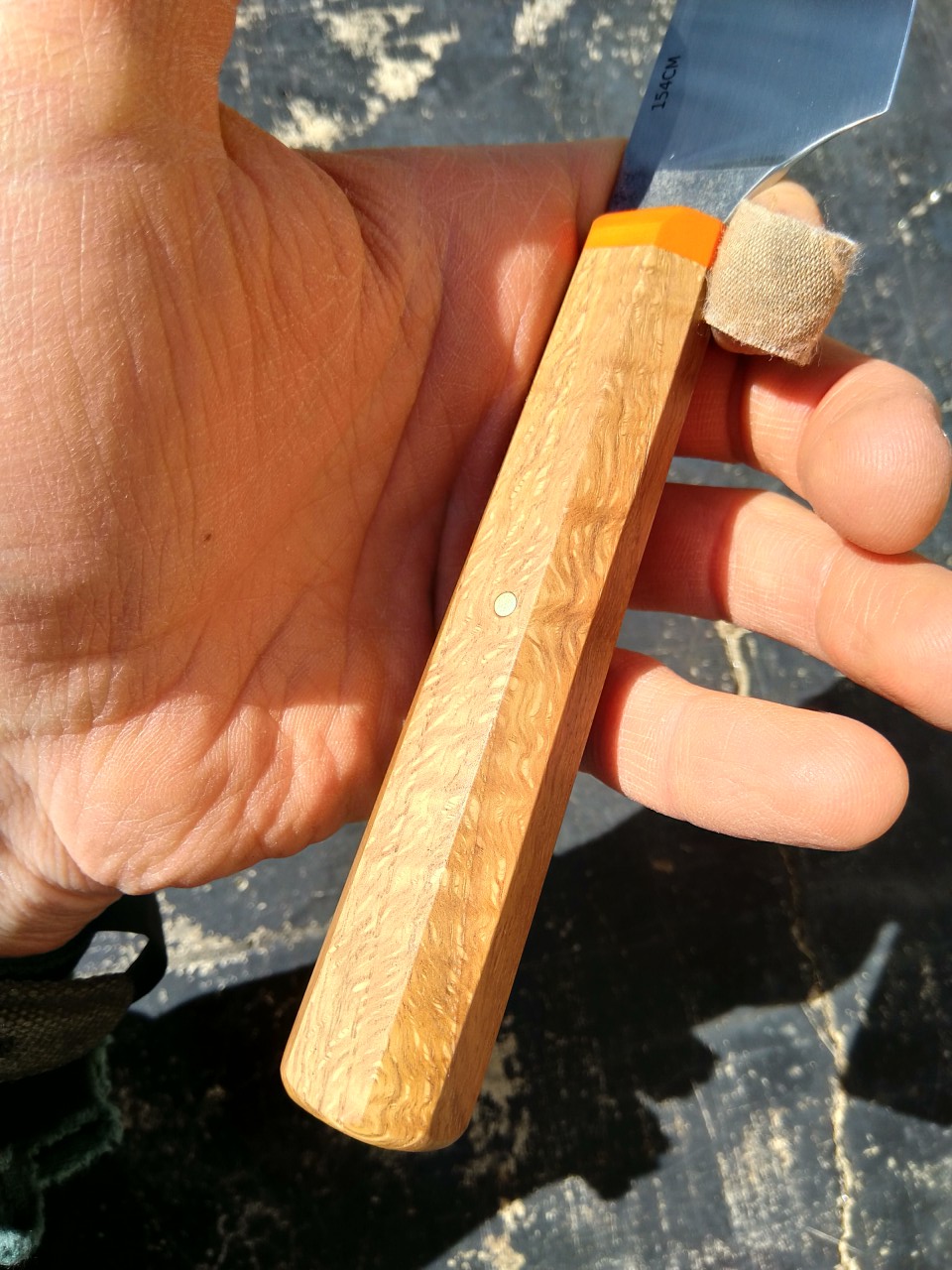

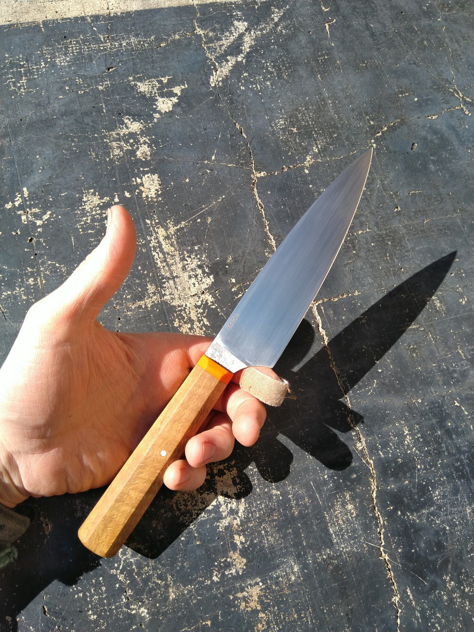

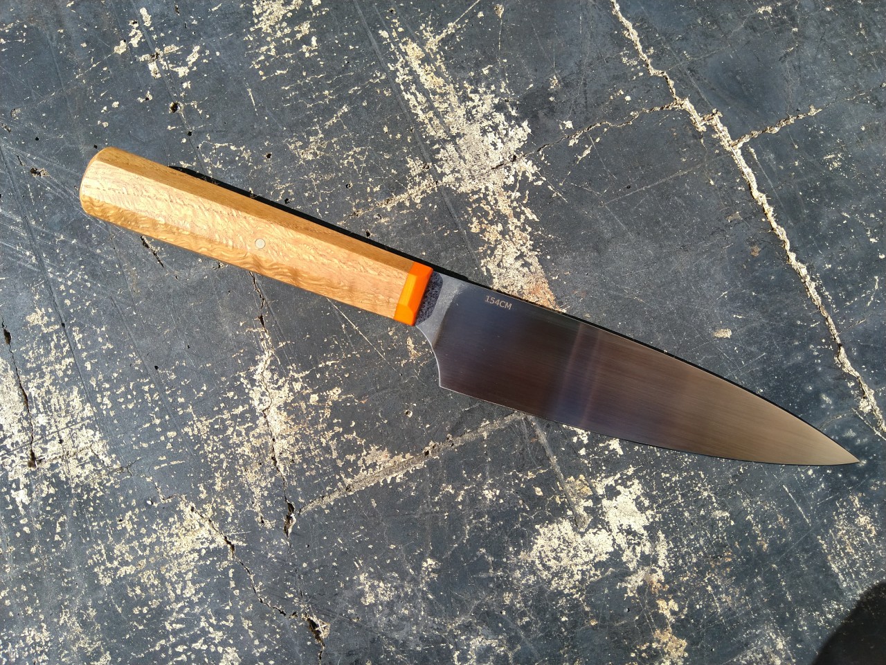

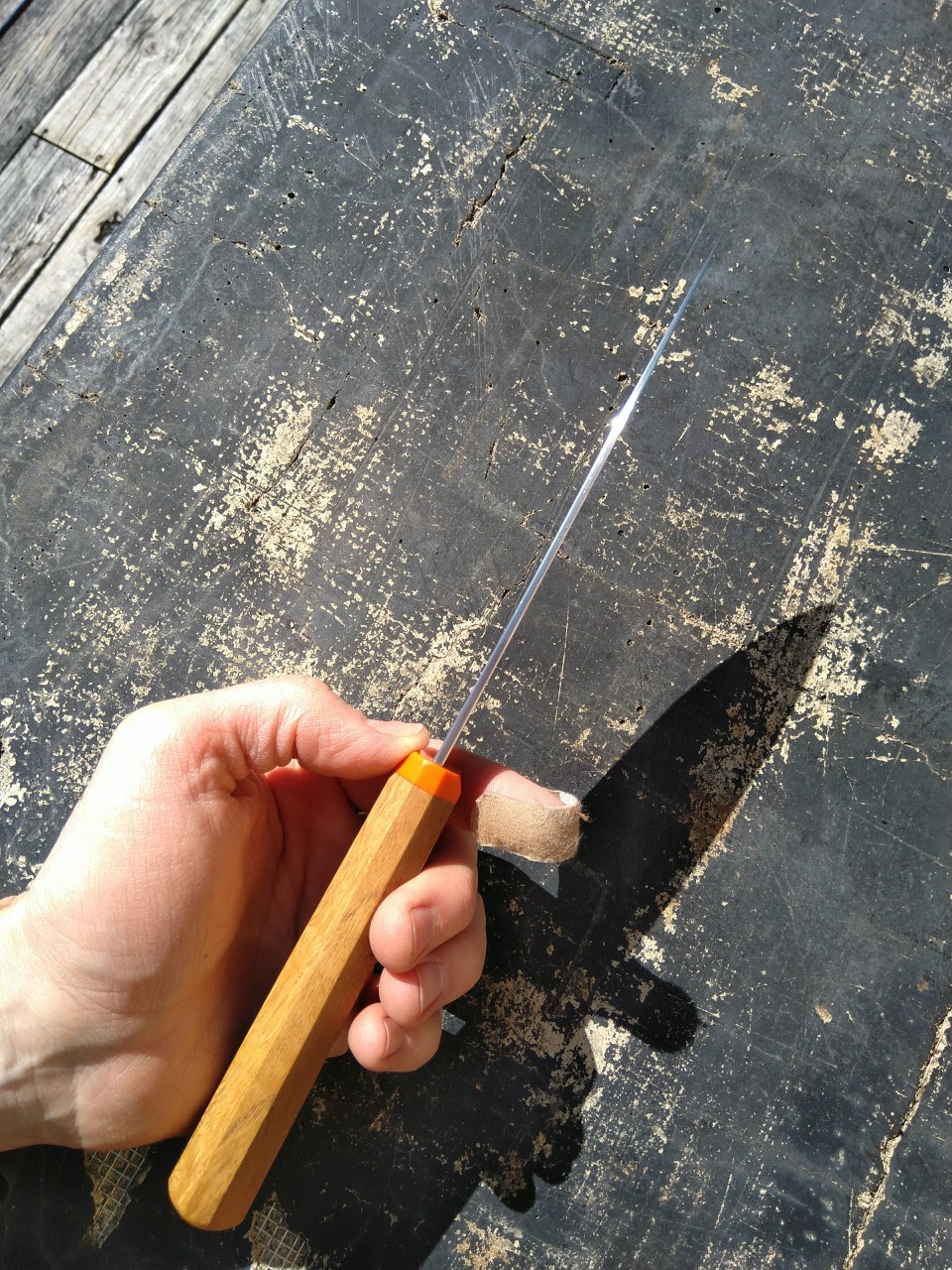

6.5"/165mm Petty Gyuto in 0.110"/2.8mm 154CM, G10 and curly white oak. 1.5"/39mm at the heel.
Hand-sanded 600x finish, mill finish ricasso.
Balance is exactly at the front of the bolster.
It's a little bright out for pictures today.
