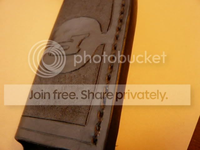

My only suggestion concerns the edging on the sheath. The sheath is nicely done, but the edge does not demonstrate the same skill as the rest of your work. A good edging tool used after the stitching is complete adds much to the overall look of a sheath.
I follow the edging tool with a burnish of the entire edge. It is one area that experienced buyers look at closely.
Keep up the fine work, Fred

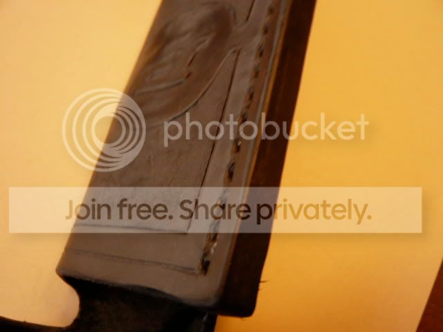

Fred, thanks for your feedback regarding the edges on the sheath. Could you say more about specifically what you are seeing? I ask because I spend considerable time doing my edges and would hate to think I'm doing it wrong and wasting effort. I use an edger tool, burnish with water before dyeing, burnish with gum tragacanth post dyeing, etc. Here are a couple of closeups (again, sorry for the photo quality.) I'd appreciate hearing more about what I need to improve in this area.
The top edge has a little area that's not uniform...not sure if I did something to cause that (maybe burnishing when too wet) or what.
Thanks again!

Paul,
I totally retract what i said about the lanyard color. Now that I can see the liner material I think its a nice touch !
FWIW- I'm still trying to figure out how I like the edge treatment on the leather.
Using the edge beveling tool then burnishing gives a nice looking edge which is what I did on my last sheath.
Using the belt sander to put a radius across the entire edge looks better IMO.
Perhaps a combination of both methods would be a good way to go. I'd also like to see Fred explain his style in a bit more detail.
Great Job and keep up the good work ! -Josh
