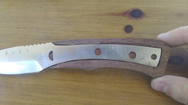

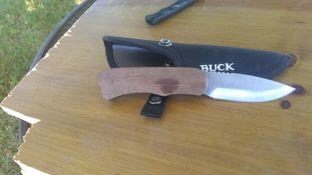

After a long wait due to a lost package I finally received my piece of American black walnut and today I got started on the rehandle.
I don't have time to finish it right now but I'm off to a decent start.

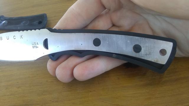

I forgot to take a picture before reshaping the tang, but this'll give you a good idea of what they're originally shaped like.
You can see what I removed from the bottom to give me a much easier shape to work with.
The fit isn't perfect but I can fill that in when I get to the final glue up.
It won't be perfect but hopefully it's worthy of carry in a leather sheath by the time I'm done.

^lookin good there hickory. how much ya gonna keep shape and doing to it?

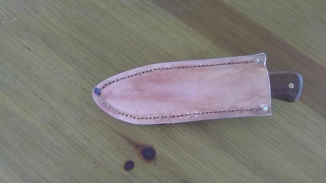

Just some final finishing work, then I've gotta make a sheath for it but I think the 10oz leather I've got might be too thick and will have to order some 8oz.
