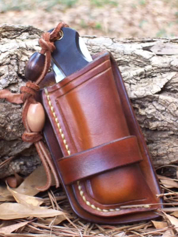

Well I found my 6OT at the local fleamart as the only USA made in a bag full of elcheapos.
When I asked lady how much for this one she answered $5.
I didn't even haggle, just forked over the ransom along with her sack of leftovers.
I think it cleaned up pretty good. Rick Garcia kindly provided a non OEM sheath for it.

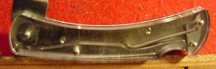

You are right Dave I did leave out some of the changes.
The change I least like is the 2-piece springs.
The first is a pic of a earlier type LB cutaway made by Schrade for demo purposes. (pic courtesy of LT632ret). IMHO that is a much stronger system & prone to less breakage of the spring than the newer type, the two identical flat springs.
The second pic shows both spring types from a 6OT.
Third pic- Flat spring 6OT parts laid out
Forth pic- Old style spring parts laid out
Schrade used the 2 flat springs on the the 3 series knives (3OT, 53OT) on the 5 series knives, (5OT, 55OT, 5UH, 50UH & 55UH) as well as the LB series.
Of course you can't get the flat springs now, but fortunately it is not too hard to make the old type springs.
Dale

Thanks for posting those pics I'm sure many will learn from them, most of all myself. I really am not crazy bout the 2-pc spacer/spring combo config either although I just bought a brass LB-5 that is like that and walk and talk are good. Those thin flat springs seem way more prone to metal fatigue to me. The single spacer separating the rear bolsters also looks way better imho. The examples you show display the separate round springs. Any photos of the square ones to show that difference to folks?
I don't think I have any off hand with a square spring, though I do have some more squared off spring steel stock that I use to make that type replacement springs.
The "square springs" that I have seen really aren't square, just more squared off than "round spring" which is more of an oval shape, IIRC.
Dale
Dale
Thanks for the clarification. You are the man with the knowledge in this area I figure.
