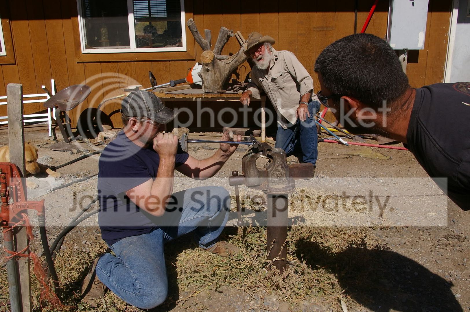

70 lbs lateral force
You don't have a picture of how you attach the torque wrench do you? Would help a bit in understanding how you are applying force to the blade, would also help me to replicate your testing.:)
I have a photo, but do not know how to post it, if someone wants to post it I can send it to them.
So if Noss stands on the handle and bounces up and down a little.... ;)
First my apologies for falling down on the job, was late to getting these photos hosted.
Thank you Ed for sending them to me.
Ed Fowler said:
Mark Reich flexing seminar test blade, Chris reading torque value on wrench, I am watching for degrees of flex. This blade showed 70 ft lbs throughout the 90 degree flex.
Allcaps321: Thanks for posting up the photos.
There are some safety rules we need to follow when testing blades for lateral force.
Safety glasses are a must, they have never been needed, but we always make sure everyone in the immediate area is wearing them.
Never push a blade, if it should break you can fall into it. ALWAYS pull the torque wrench toward you and be ready in case it fails catastrophically. This was a differentially hardened, then tempered blade so there was not much danger of it catastrophically breaking in to two pieces. This can be achieved with fully hardened and tempered blades with the right heat treat.
If a blade has a deep vertical scratch on its side, be sure and sand it out. A vertical scratch can act as a stress raiser and your test will not be a fair test for the blade.
Blades can twist in the vice and the person doing the flex needs to control the wrench, this is why Mark has his left hand on the side of the torque wrench.

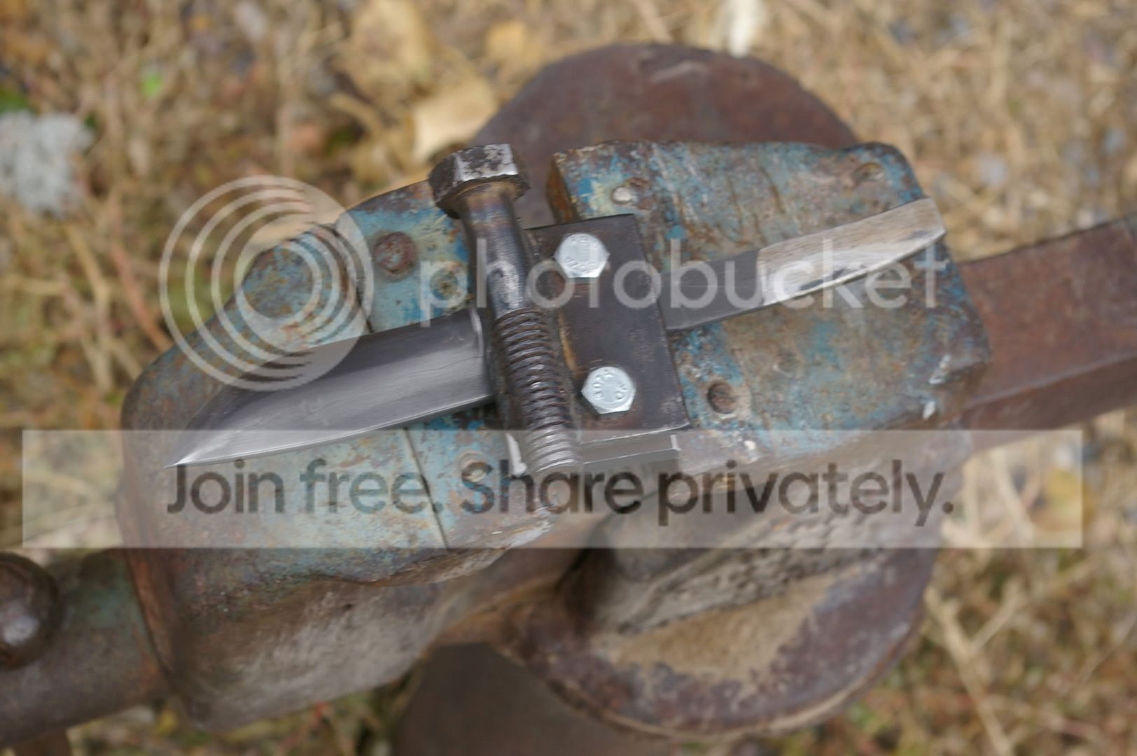

The photo second photo of the blade shows it after a 90 degree flex one way, then back to straight and 80 degrees of flex the opposite way until the edge cracked. We straightened the blade and used it for further cutting tests, it was not straight but good enough to use. You can see the 1/4 inch crack about 1/4 inch in front of the plunge grind. The fracture bifurcated when it got into the first transition zone and started running parallel to the edge. As with most of the blades tested we were experimenting with the height of the first transition zone, it performed as expected.
The bolts in the two pieces of the jig that hold the blade can be expanded with longer bolts should you want to test a blade with a handle on it. The two pieces that sandwich the blade are 1/4 inch thick and measure 1 3/4 X 2 1/2 inches.
The heavy duty vice came out of the oil field as scrap, it is welded to a heavy duty piece of pipe that is welded to a truck rim and buried 18 inches in the ground.
