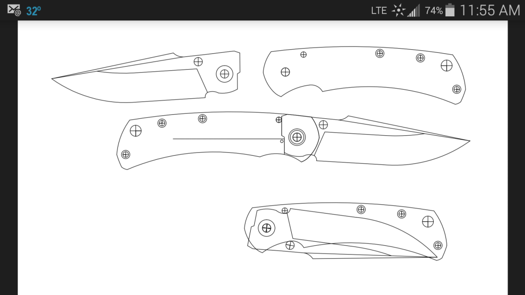

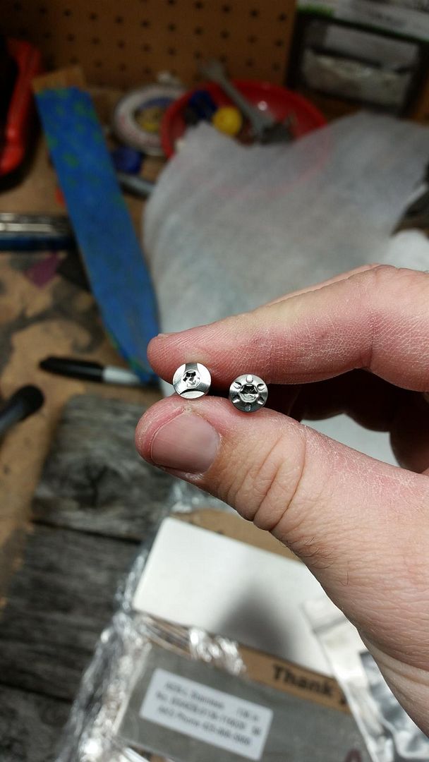

Thanks Daniel and for all the tips you have been giving me. Here is the last tweak I have made to it I think im done I just want to get started on it. I'm going to get a working template made soon. Pivots showed up today they are nice!!!!
Justin - your design is looking good! :cool: Big respect!
Nice pivots too, I am using one like those on a new RF2 and they are excellent. I'm about to start using the standoffs he makes. The machining is so clean...
All of the tweaks you made to the folder really work well, it's going to be nice!
I hear ya on the clean, I have made only one other folder a friction folder and the hardware I got from one of the supply company's nothing fancy. Now I see why Steve's are so expensive as soon as I opened them I could tell the quality is top notch, I got some 3/16 backspacers and thumb studs from him too...nice stuff. Hopefully I won't ruin them since this is my first framelock build.
I'm super impressed as well, SK's machining is off the charts. I have used the smaller spacers also, everything is as smooth as can be.
I like to use new hardware for assembly but I don't see why you have to as long as you are careful.
