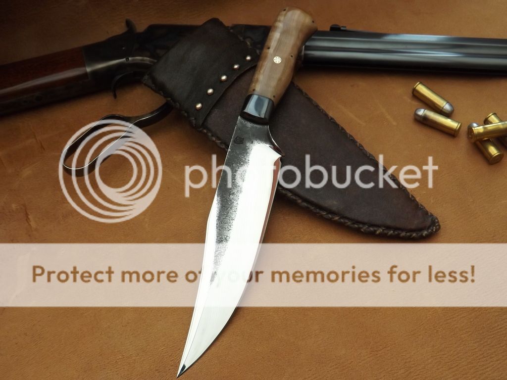

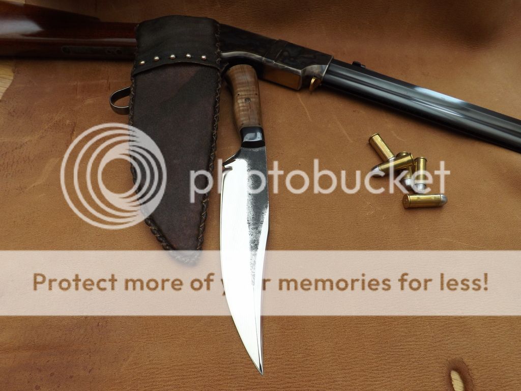

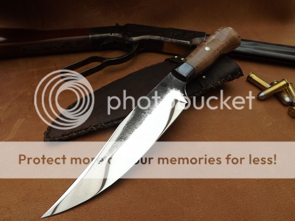

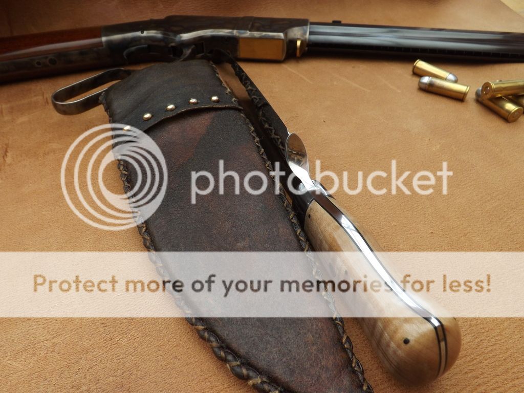

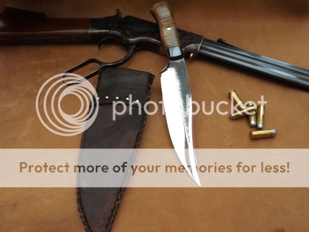

Hi Guys

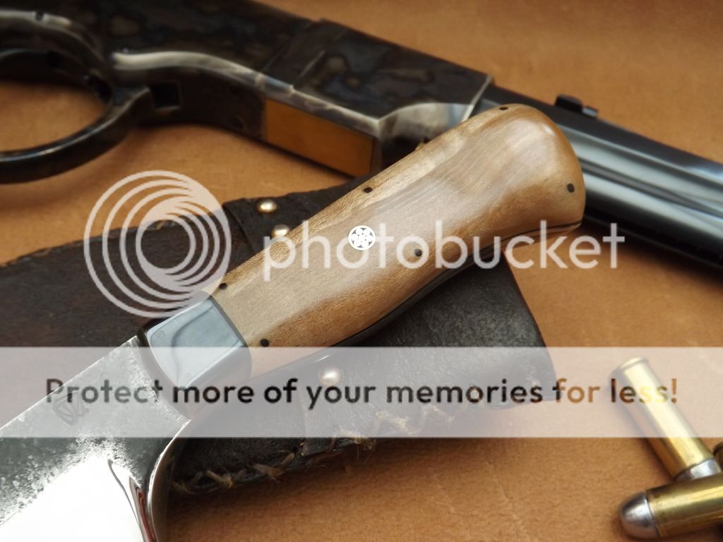

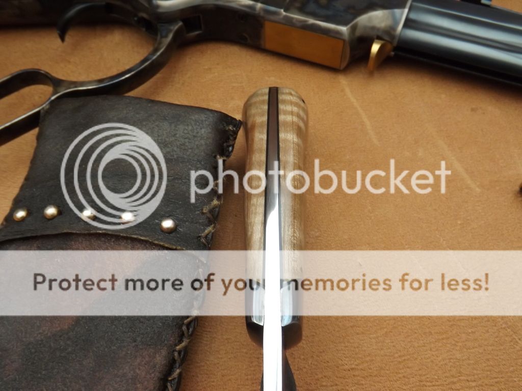

This Brut De Forge Bowie is forged from 5160, it has an 8" blade, is 1 3/4" wide, just under 1/4" thick at the spine and is 12 5/8" long. The gun blued bolsters are dove tailed to match the stabilsed curly maple scales which are held in place on the tapered tang with six gun blued pins and one hand made mosaic pin. The scales and the bolsters are lined with black fibre liners.

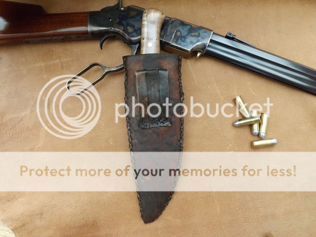

The sheath is leather lined and covered with rawhide. The customer wanted a plain style sheath so I have only put five brass dots on the throat flap. The rawhide has been dyed and roughed up to make it look worn.
Thank you for taking the time to look, all comments and questions very welcome.

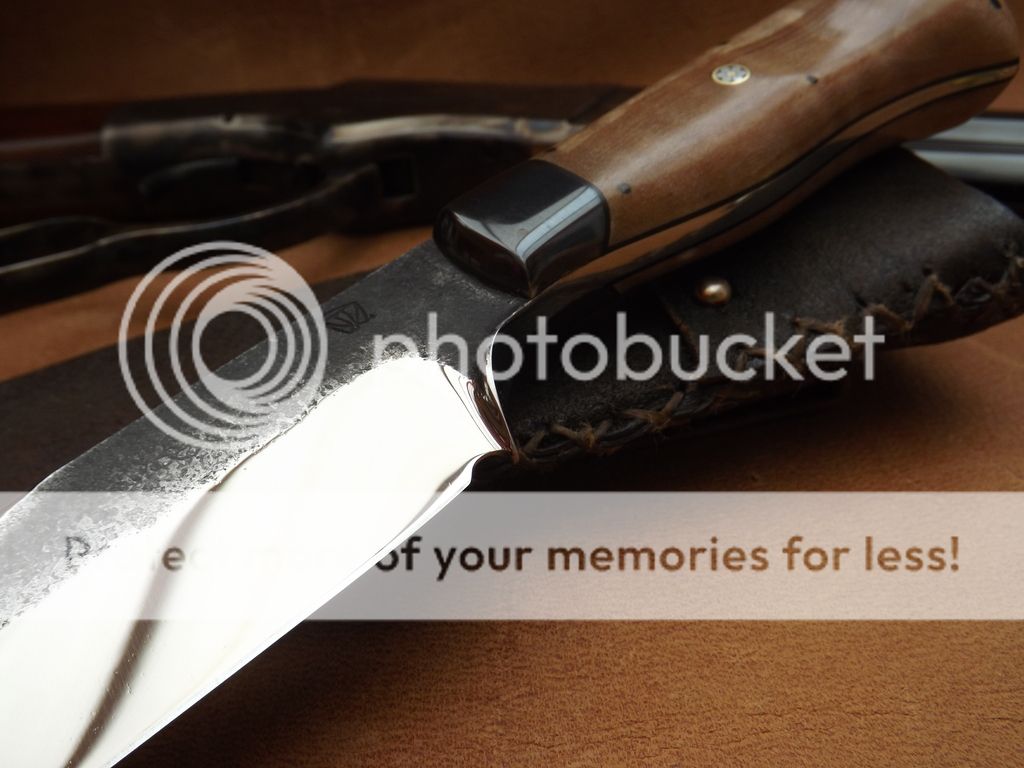

WOW! :eek: That is a damn near, if not perfect, brute de forge knife! At least to my eyes! :thumbup: Absolutely beautiful job, everything flows great and goes very nicely together.
I'm curious... When you say, "gun blued", do you mean you hot blued those bolsters an pins using the blueing salts and all that correct? Because if not, you have GOT to tell me what type of cold blue you used and what technique you used to get such a beautiful dark & even finish on them.. please? :D . Also, you have me lost as to how you could have hot blued (again, IF that's what you did) those pins on the handle, being that they're perfectly flush as well as contoured to the shape of the scales...:confused:
I'm also scratching my head as to how you got the plunge to start just behind the integral finger guard without grinding that part of the guard's "flare" off. I won't be able to sleep until you inform me as to how you achieved these things lol. ;)

The handle pins are 1.6mm carbon steel Tig wire. In another life I was a coded welder. The handle is glued together in the usual way allowed to set and then shaped. I used G96 gun blue creme, applied to the head of each pin with an artists brush, left for 5 - 10mins and then wiped off. Because it's a creme it stays where you place it.
The bolsters were a bit more tricky. These were drilled, shaped, the fronts cleaned back to the desired finish and then riveted in place. I don't want to try and clean the front of the bolsters when they are fixed into position.
So I didn't gun blue the tang or the surface of the blade I applied clear nail varnish to these exposed areas. I then soaked a cotton swab in Phillips Professional Cold Blue and rubbed this onto the bolsters. I kept applying the bluing solution until I achieved the depth of colour I liked. I then removed the varnish with acetone and applied a little WD40 to the bolsters.
Ah, the plunge lines, you've got sharp eyes Paul. I try to get my plunge lines as equal as I can. Because of this I ground the primary edge in on the blade before forging the finger guard in place. In the standard way of making a Brut De Forge, I did this part arse about face :confused:, but in my defense this is the first forged finger guard I have made. I left around 1/4" of green steel, then heated this section of the knife in the coke forge, clamped it in the vice and hammered the guard into place. Because the primary grind was already there everything moved forward more than I had anticipated. I did have to clean back more carefully than if the plunge lines started in front of the finger guard, but with careful use of the 2" belt grinder and a small rat tailed round file I managed to salvage the blade :D
I have to admit that when I first noticed what had happend I nearly scrapped the blade, but with a bit more work it turned out really well in the end and makes it a little unusual
