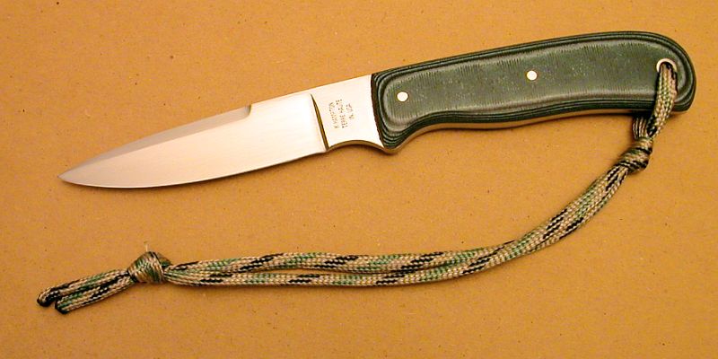

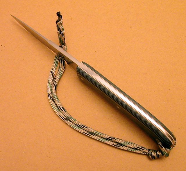

OAL - 8"
Blade - 4" from handle, 1/8" D-2, tapered tang
Rc - 60-61
Handle - Green/Black/Pistacio 1/8" G10 w/White Spacers(from Sheffield Knifemakers Supply)
Stainless pins and thong tube.
The blade is hollow ground on 10" contact wheel, very thin. Should be a good cutter.

All of those knives are nice, but I like this one the best.

Thank you for the positive comments guys and all constructive criticism is welcome. Posting these images is mostly exploratory. I have been making knives for a short time(still learning much) and I am testing the waters to see if there is interest in what I am doing. I am hesitant to sell them at this time and start dealing with all of the issues involved with that process. Thanks for looking.
